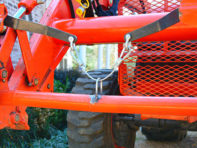

I still believe your issue came about through overtaxing your loader's capacity to handle 'twist' forces on the loader assembly. I want to reiterate this point so you can avoid it at all cost in future by emphasizing safety to yourself and to the equipment, and by trying your best to not exert unnecessary twisting force on the loader arms/QAs and similar items, grapple, for instance. This may take some in use experience, but you now know what your tractor can NOT handle as far as log length/diameter etc.

when you get it straight be sure to check the grapple fit. It must not be correct or it would have stayed on.
Or it wasn't correctly seated/ locked.

The QA twisted because for some reason it unlatched or fell off the attachment on one side.
Check your latchs, and make sure your grapple is attaching properly.

The QA twisted because the latch on one side opened or was never correctly latched. When the load became enough to overcome the torque tube, that side opened while the opposite would have closed. This would not be possible on a true skid steer plate that is strong and rigid enough to resist torqueing under extreme weight. For example, our mulcher head weighs close to 2500 lbs and one side comes open every now and then from brush. The head will come completely unhooked on that side, but never come off or do any damage.

Called the new dealer (that replaced the one that went out of business). They picked it up Weds afternoon. Called me this morning said its fixed-when did I want it delivered. The QA was bent. They had one in stock and it slid right on. I had Kubota insurance so all I had to pay was the deductible $250. The total was $460 which included 45 mile round trip transportation. Checked the fluids and fixed a electrical problem. Next day service...these guys should stay in business--Mountain Kubota of Boone.

Today I went and looked at the cross tube on my LS R4010's loader. I have complained at length here about the size and power of that loader. But that aside, its cross tube on the QA is about three inches in diameter and looks much huskier than the one that bent in the OP.

This is how I made sure my QA never accidentally comes unlatched again.
