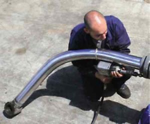

In float position there is no down pressure. If you back drag with down pressure and the bucket curled forward there's a good chance you'll bend the cylinder rams for the bucket.
Well, maybe in an extreme case where you're moving fast backward and slam the bucket into, say, a hidden stump. But I respectfully disagree with this as a general statement. Back dragging with down pressure even with the bucket at full dump is an accepted technique to position material when working a pile of dirt, gravel, etc. Don't have a CK, but knowing how stoutly Kioti builds their machines I can't imagine that series is not up to that. :thumbsup:
   / I think I have my first issue.....CK2610 #14
Threepoint I made this statement from experience In the past I've bent curl arms a few times and know of a few others who have don the same thing. I've not done it with the Kioti. It does happen when the bucket is at full curl and you hook something and try and pull it.

When cylinder rods are fully extended, like when the bucket is fully curled and angled toward the back of the tractor, the cylinder rods are at their most vulnerable position.
