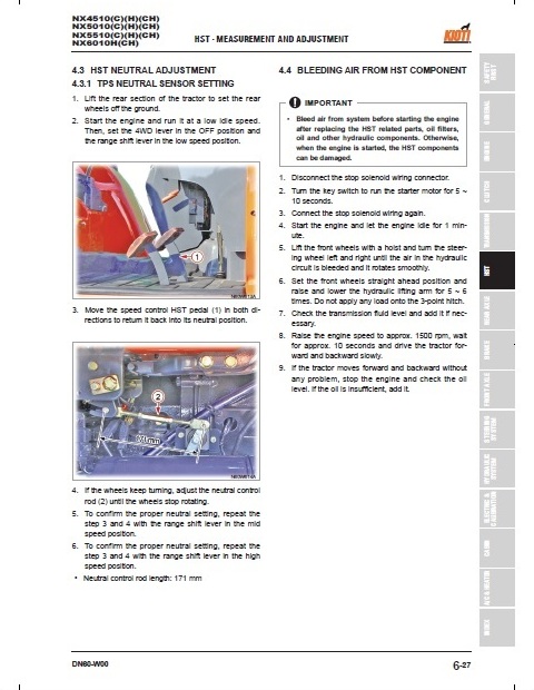

Alright it has been a busy morning, I will attach photos as I go along.
First thing I decided to try the instruction for bleeding the HST. This did help some it allowed me to now be able to operate steering,loader, and 3pt with out any rpm loss like before. But I still have little FWD, REV and third function. Attached are the photos of the 3rd function along with the plugs I was talking about. The first picture is of the plugs that were leaking the second is of the front plugs (there are 2 on each side). I followed all percautions prescibed. Stole the wifes beach towel, and other things that I didnt think she would miss, I also got her new dish gloves. I used the leaf blower and blew off all debris, and further used brake cleaner to get rid of any residues. I then preceeded to take apart the valve, it was pretty much as the video showed. The spool was easy to push out through the right side, but would not come out on the left side. I saw no debris or shavings in the oil and I collected everything that dripped out in a piece of tupperware. After checking all that I reassembled and checked for leaks, nothing was visible.
