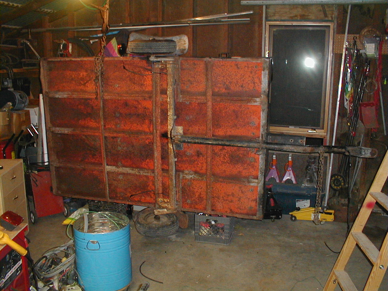

I got a very small tilt trailer for hauling around lawn and garden tractors as I buy and sell them. I've used it a few times, and I love it!
In order to fix a crack in the framework, I lifted the trailer onto it's side and secured it to a beam in my garage/shop. The trailer needed all new wiring too. After the crack was fixed I left the trailer on its side to do the wiring. That made wiring the trailer rediculously easy. I'm sure that next time I have a trailer to wire I'll be looking for a way to swing it from the rafters.

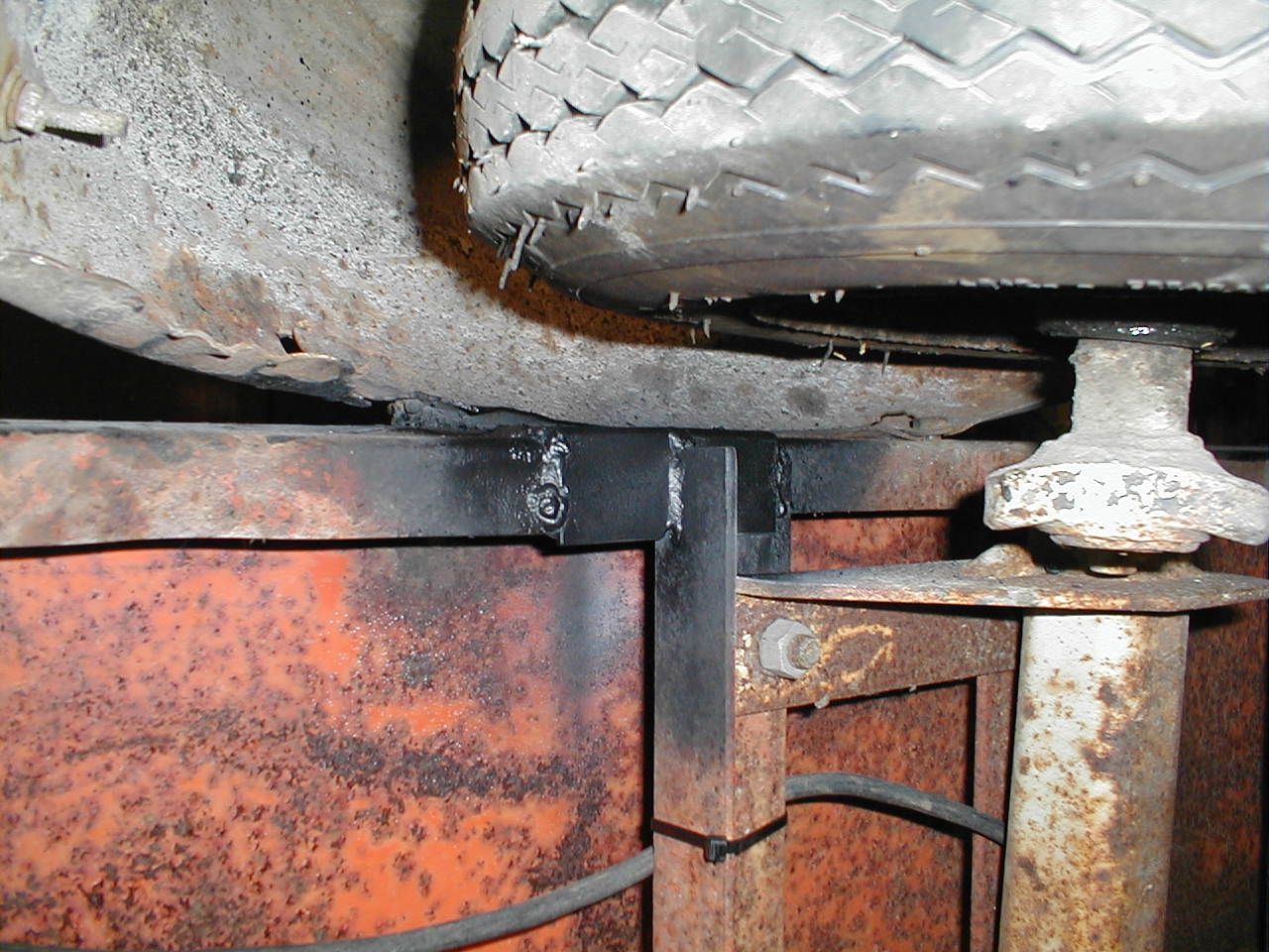

The first picture below is the fix for the crack. That's a chunk of old bed rail welded over the crack.
The second picture is the trailer on it's side with the wiring completed.

Yes, flipping stuff on it's side makes for some easy work. Funny how we figure that stuff out as we get older and no longer enjoy laying on cold hard cement and having dirt and crud falling in our faces...
Last trailer I built for rumbling through the woods has the wiring wrapped in spiral plastic and then run in square tube from the front to the lights. No rubs no rips no errors for (knock on wood) 10+ years. Next biggest thing was no splices in the wires, just straight shot from the plug to the lamps and the plastic housings sealed tight. The sockets are also slathered with "dielectric grease" that keeps them from corroding. Actually works. Doing all that has made my DIY trailer the most reliable one I own.
