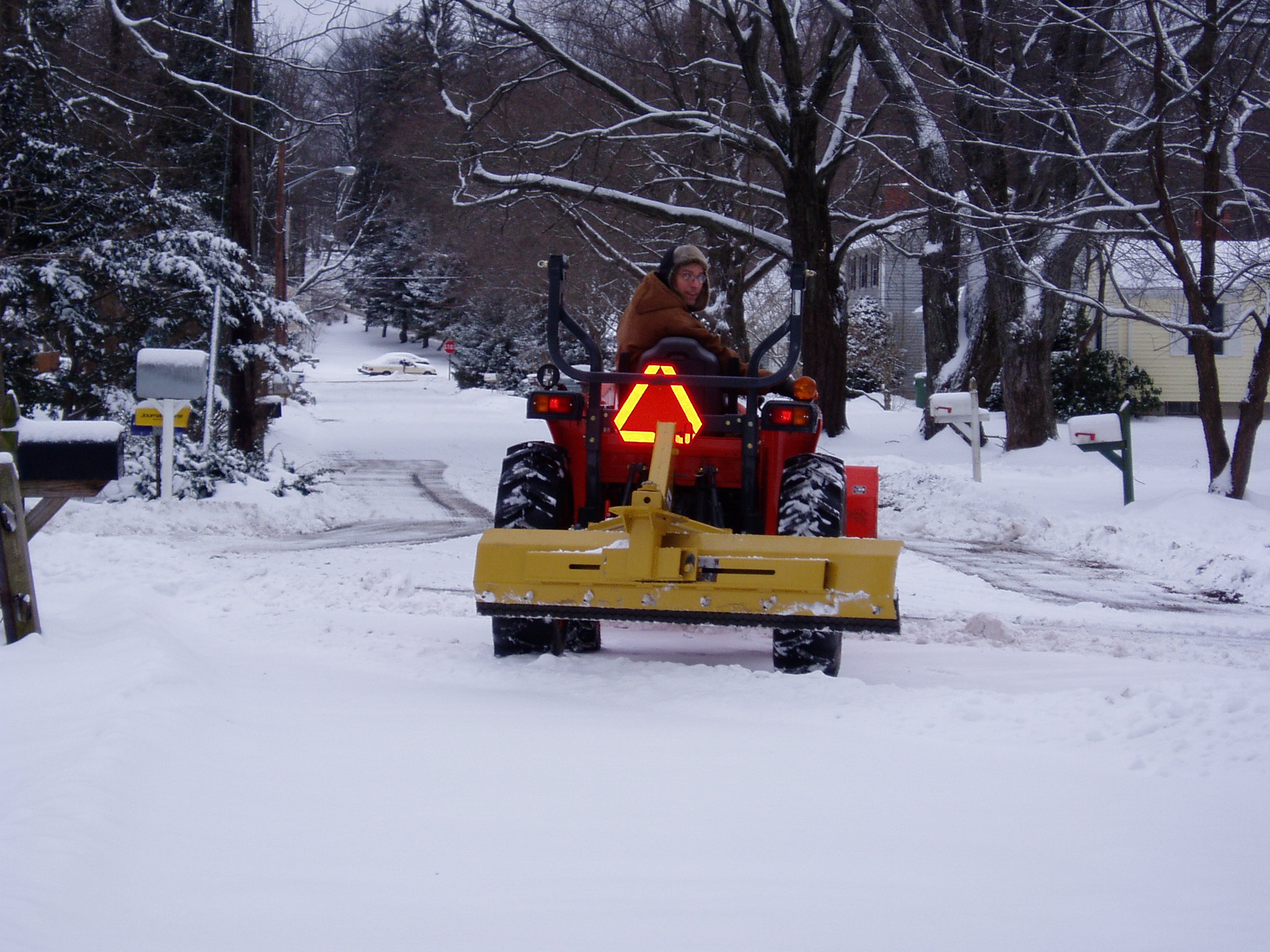

I found a sweet piece if semi truck retread on my way to work today. I figured I could mount it on the bottom of the cutting edge of my snow blade, the question is...How do I cut it? I was thinking sawzall because of the steel belting, but what do you guys think?
I have an old car tire that i use as a bumper on the pallet forks.
To avoid rain water collecting in it I drilled 5 2 inch diameter holes clean through the tread with a hole saw.
Just about no smoking/burning, but the cut out discs were hard to handle with the embedded wire.
So, I would go for a sawzall with a blade that has same/similar teeth to a regular general purpose hole saw - mine happen to be Blu-Mol.
   / I picked up a piece of truck retread...now what? #17
Hey Jim ...... the photo looks like something bad may have happened to one of your emergency lights.
Is there an associated good story ?
Hey SARG -
The lights got whacked by low branches as I tried to reclaim the edges of our field from the encroaching woods. Sitting high on the broad, flat fenders the lights are really exposed branch magnets. In one of those encounters my eye glasses got plucked from my face - never did find them. I bought replacement light fixtures to mount in the bends of the ROP frame, where they will be a little better protected and a little better placed for visibility - just haven't got around to it. It will get done when I do the ROP work light bar this Fall/Winter.
-Jim
#18
I got it cut to lenth and mounted on the blade. I used a sawzall with a Bosch Progressor blade that I had in the box. I'll post some pics when it's all painted and good to go!
