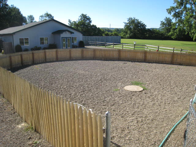

I need some ideas on how much I want to invest to fix a problem.
My house is on a septic system and so is my business, which is on the same property but has its own septic.
The township has said we would be getting sewer down the road, but they have no idea when.
My house's leach field (assuming it has one) has stopped working and now the septic tank simply fills up and overflows out the cover.
What I'd like to do is have a temporary fix and this is my idea: I could lower a submersible pump into my house's septic tank and pump it into the cleanout on my other septic system. It would be nice to leave the pump in the tank and have it work automatically, but I cannot have the 140 ft of hose I will need laying across my driveway and parking area. And I don't want to bury it deep enough to prevent freezing because that would be pretty intrusive on my property for something that will only be used temporarily. Although I know that will save me the grief of having to drag everything out to pump it down every few weeks... I'm assuming sewage freezes...
Yesterday I was looking at pumps at the local hardware store. I don't know if I could get by with a utility pump, inline pump, or if I need a full blown sewage pump. It would be nice just to crack open the lid and drop a hose into the tank, but it might clog up, too. Maybe nothing a shake won't clear... The thing about the sewage pump is it requires a 2" hose... I'd like to get by with a garden hose due to the distance, but don't know if I can reduce the 2" to 3/4" without developing too much head pressure or whatever it's called. I'm looking for something to get by until who knows when, maybe next year maybe 3 years from now.
That's the gist of it. Does anyone have any input here? I'd appreciate other opinions as to what my best option would be.

Hi Freds , I had the same Problem before finally Replacing my latterals . First off I have no neighbors so it Might not work for You. But the Solids float to the top Pretty Much . I bought a Electric little giant pump that just Uses Garden hoses the inlet has a little spring looking thing on it so it wont clog & burn the pump up .
I Just dropped it in about once a week & run a couple of hundred feet of garden hose out to the pasture to drain it. Worked well & the Smell wasn,t Very bad at least up by the house . It Might work for You depending on Your situation . The Pump & Hoses all cost about 100 bucks together & I use the Pump for other uses as well . Best of luck. Bob

Not knowing your city or how strongly they are planning on putting the sewage system in really makes it hard in trying to decide if it's worth fixing the problem, or going to plan B. In my experience, and from what I'm reading about the financial situations of most cities, it could still be a few decades until anybody starts putting in sewage lines.
The first thing I would do before trying to play around with pumps and hoses is to find out what it will cost to get the leach fields fixed or replaced. Call a few companies out and get an estimate. They wont charge for this and then you'll know what you are dealing with. It might even be something else and turn out to be a quick fix.
Septic tanks have a baffle in them and an outlet pipe. Are you sure it's the leach field that's not working? Has this been going on for a period of time? Did it just happen? What is the sewage doing in the tank? Does it overflow? Is it backing up into the lines and not draining in the house?
While a sewage pump in a tank is exactly how a lift or collection station works, it's not very high on my list of ways to get rid of sewage. The size of the hose will be decided by the size of the pump. The size of the pump is decided by the distance and height that you are pumping the sewage. In my experience, you use Schedule 40 PVC pipe for this. The solids get churned up in the pump, but the paper and food solids are what requires a sewage pump.
I would never, EVER, run sewage through a garden hose, or any soft sided hose. I doubt the garden hose will even work, but don't know that one for sure. I'm guessing you need to be in the one inch to 1 1/2 inch size minimum anyway. But if you did manage to get a soft hose to work, the odds of it remaining sound and not leaking are very low. The second somebody catches you pumping sewage across your yard and it's leaking out of the pipe is the day you wish you had never been born. It will smell bad and all it takes is one complaint to get somebody out there. Is it really worth saving a buck to try to go this route?
This all gets very expensive real quickly. Depending on how slow the leach field is, if there is an obstruction in the outlet and how often you use your toilets, you might just pay to have the tank pumped when you need it emptied. Here, it's $80 to have a tank pumped. An empty tank can tank months to fill up. If you don't use it very often, it might be something that you only have to do a few times a year. To me, that's pretty cheap if you think the city is really going to run a sewage line to your place in the next year or so.

To put a pump in your tank you will need a grinder type pump at the minimum
I would think you have problem in the drain field, but have the tank pumped and make sure the outlet to field is OK.
Is there a way to tie the 2 drain fields together?
If you could intercept the water going to the drain field out of you septic tank you could use a pump with the smaller impeller and no grinderand smaller pipe or hose 1 11/2 - 2"
Is there any way to run your Grey water to a French drain and cut down on the loading of the septic (black water)

I really appreciate the responses, here's more info.
The septic was put in back when they didn't need permits. I have no idea what kind, if any, leach field there is. In the pic you can see the tank, my yard and the circular driveway/parking area for my business. We (oops, hit a button while typing) We did lots of trenching when building my business and didn't hit anything resembling a leach field. And neither did I when installing my fencing. And I'd really hate to tear up my dogs area and driveway to install another septic leach field, if the township would even let me.
I did contact a plumber back in March because my drains have always been slow and in anticipation of the upcoming sewer line. He mentioned redoing the pipes in my basement, coming out the side of the house into a holding tank and installing the sewage pump into that tank. Then running 2" PVC into my business' sewage line, which is on the right side of the building you see. At the same time he would lay a 4" line coming back the other way for future use. All to the tune of $3,200... back in March. And the more I thought about it, the more I thought this was a lot of money for basically a temporary fix when the sewer line gets put in. Of course, the longer they take to do this, the more it would be worth it I suppose.
So my buddy suggested just pumping the liquids out on an as needed basis like cowboy mentioned. BTW, why wouldn't a garden hose work for this? I don't think I've ever seen a garden hose leak or seep.
Anyway, Memorial Day weekend the toilet stuck on and the tank overflowed. I called a septic guy and had the tank pumped. $225 to pump tanks around here. This isn't going to be an option. And yesterday the toilet stuck on again, no idea why it's doing this, and I had another overflow incident.
Right now the kitchen sink and dishwasher and the toilet are the only lines running into the tank.
Aside from doing something that will work, not tearing things up is a big concern of mine. Especially if things will need torn up again when the sewers are put in.
And I don't think the neighbors will say anything if I stretch a hose every other Sunday and pump my house's tank into a working septic. Heck, my next door neighbor has a line running from his septic into a drain tile the township put in to handle the rainwater off the road. He certainly isn't going to say anything.
And if burying a plastic line with my subsoiler will work, I'll go that route. That won't tear things up too bad, but of course it wouldn't be very deep either. And I'm worried if this might freeze in the winter.
I know the sewer line that came out of my business wasn't more than 18-24 inches deep. The builder said it wouldn't freeze and it hasn't, but maybe the septic guy, who installed the outside work, ran it straight down into his line to get it below the frost line.... I wish I had paid more attention to how he was doing things now that I look back on it.

oops, when my message sent before I wanted it to I completely forgot about attaching the pic.
Here it is.
And I completely agree the hose would be a drag in the winter.

You could burry a 1 1/2" polyethelene well type pipe with your sub soiler and leave the check off at the pump and pitch it to drain back in to the tank so it would be empty or almost empty and only full when pumping.
If this type pipe freezes it will expand and not breake like rigid pipes.

That's what I was thinking, but running pipe on a pitch makes me nervous. Especially if just sinking it down a foot with my subsoiler. Immpossible to tell if it's on a pitch unless you are on ground that runs downhill.
Do you think the pump would blow it out and remove the liquids when removed from the tank?

If on an undetermined schedule from city I would put it in semi permanently.
Leave pump in tank plug it in at the house when you need it.
Leave it all hooked up and out of site except for cord coiled up in a planter set near your tank to disguise it.
And I know it's hard but train the family to wait for the toilet to stop flushing every one has better things to do. they just have to make sure their flapper is seated (Ill admit mine wont do it but you have to try)
Have them help you once with the disgusting job and they might see it in a different light

I am certain that you can freeze sewage.
You are much better off allowing the septic tank to seperate the sludge and scum from the sewage and then hooking your pump up to the septic tank outlet. The outlet will be relatively clear water and you can pump it using a transfer pump instead of a grinder pump. They call this a Septic Tank Effluent Pump or STEP system.
You can buy a residential packaged grinder pump with its own sump for 2-3000$ that is designed to take the 4" line from the house and then pump it out to somewhere else through 1.5" line. That "somewhere else" can be your other septic tank or it can be the sewer line once the city gets it done. It won't be wasted money.
Your drainfield for the business is sized for the business. It will be overloaded and maybe destroyed by overloading it with your house waste. Don't get hung up on yard disturbance. Many yards have been completely trashed trying to deal with a septic problem.
First things first. Get the tank pumped and looked over by a qualified guy. Have your drainfield also inspected. You want to avoid allowing your health department discovering that your system has failed since they will red-tag your house if they find out about surfacing sewage. Chances are there is a quick fix to deal with the bad drainfield but keep it quiet.
