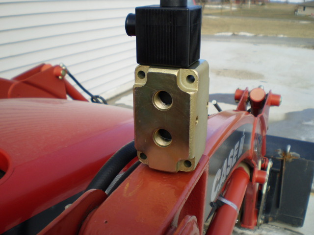

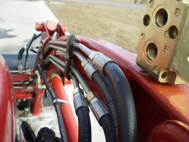

I picked up this diverter valve and I need a little advice on the best possible way to mount this on my DX33 to run the angling cylinders on my plow and operate the new 4-in-one bucket. I am wondering if I should mount the valve at the point where the curl lines attach to the hoses and then add elbows to attach the hoses to run to the front or would it be possible to split the lines and install the valve in the middle towards the front of the loader. I have attached pictures for reference. I'd appreciate any impute.

I see you got one of those new valves Surplus Center had on their web site. Any brand name on it?
Personally I'd keep it closer to the operator's platform and out of harm's way.

The valve is a Bosch Rexroth. I actually picked up two of these on E-bay for $35.00 ea.

How many ports are on that valve? It does not look like it has 6 (2 IN and 4 OUT) which is needed to make this work properly...
I mounted mine inside the loader mast...well protected and out of the way.

It has 6 ports. I was thinking the solid side mounted to the loader arm and splitting the connection where the hoses connect to the steel lines for the curl function and then adding two elbows for the addition of the two hoses for the plow angle and the cylinder on the 4-in-one or a grapple.

Cliff, if you mount that valve up front on your crossmember, you can probably put quick-connects on it and hook your 4-in-1 hoses or angling cylinder hoses directly to the valve, eliminating the need to mount a bracket for the QC adapters. Your hose and fitting requirements would probably also be minimum.
If you mount the diverter on the side of your loader towers, you can put quick connects there and hoses to the front with more quick connects mounted on a bracket at your crosstube. That way you can have the normal and diverted hydraulics available even when you remove the loader. This will require more fittings and hoses, but is a bit more flexible.
I don't know what you would want to use the hydraulics for if your loader is removed, so I think I'd look at putting the diverter valve up front and make it as efficient an install as possible. That will mean only your electrical connection will need to be longer and have a disconnect at the loader towers.

I like the idea of the valve and adapters on the cross member other than the issues encountered splitting the steel lines and using compression fittings to attach short hoses to them to run to the valve. I was wondering if it is possible to install T fittings where the hoses attach to the steel lines?

Please bear with me as I don't know your level of hydraulics expertise; but are you thinking of using the same compression fittings you find at the hardware store? If so, don't as they are not rated for high pressure service.
My only concern about mounting the valve up front is damage from dirt, rocks and other debris that may spill back over the bucket.

"T's" are not going to do you any good. You must disconnect the lines completely and run them to the diverter. From the diverter, you'll run back to the original fittings and another set to your remote feature for the 4n1 or angle function. On the diverter it's "everything in" and "selected function out x 2"
I suggest you draw out everything on the computer or a rough sketch on paper. Then, start counting fittings and hoses required. When you have everything sketched out, you be able to make yourself a parts list to order all your fittings. With the sketch and list, you'll find plenty of help here.
My personal experience is that steel lines are very easy to work with, but you have to be sure of clearances because you can't move them like flexible hoses. However, I think you'll have plenty of room for 90 degree "L's" so you can route the lines to and from the diverter. Do make sure you use L's where needed to keep lines flat and away from possible snags.
