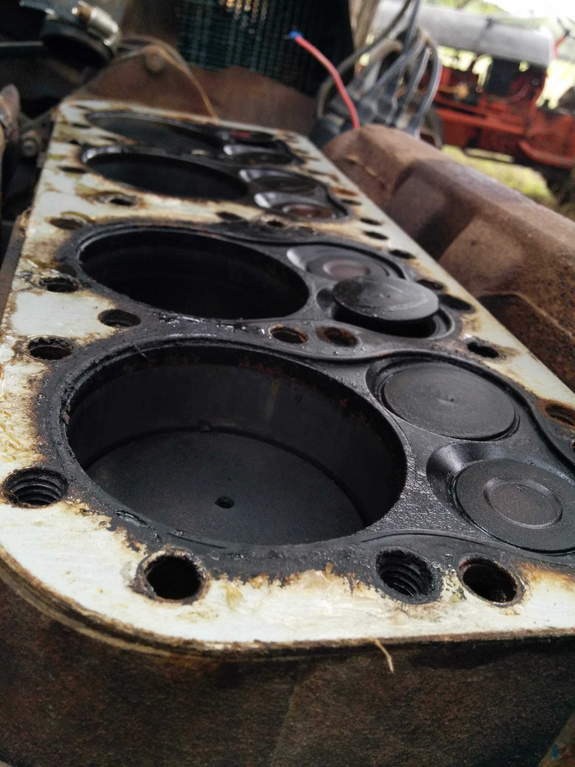

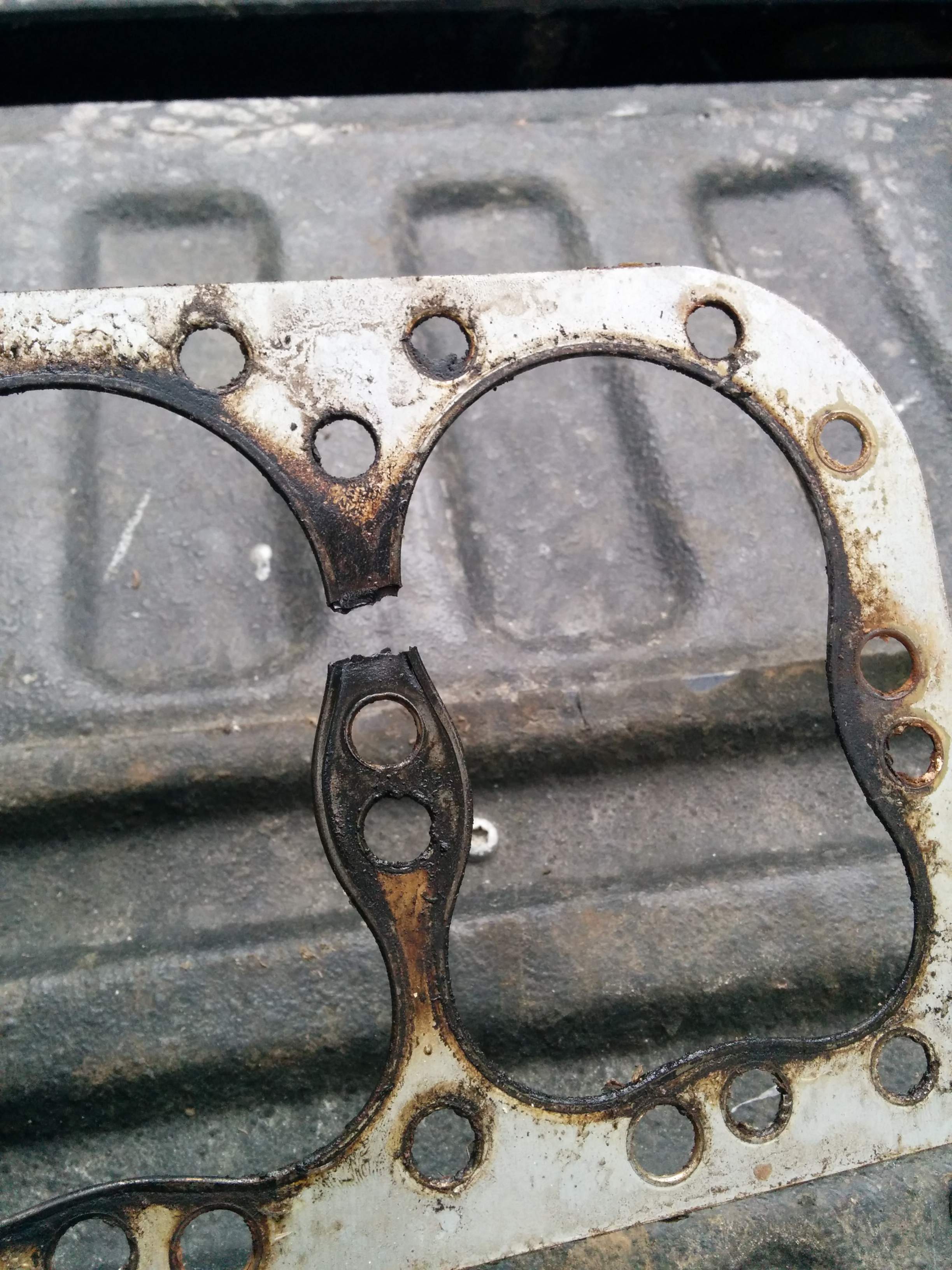

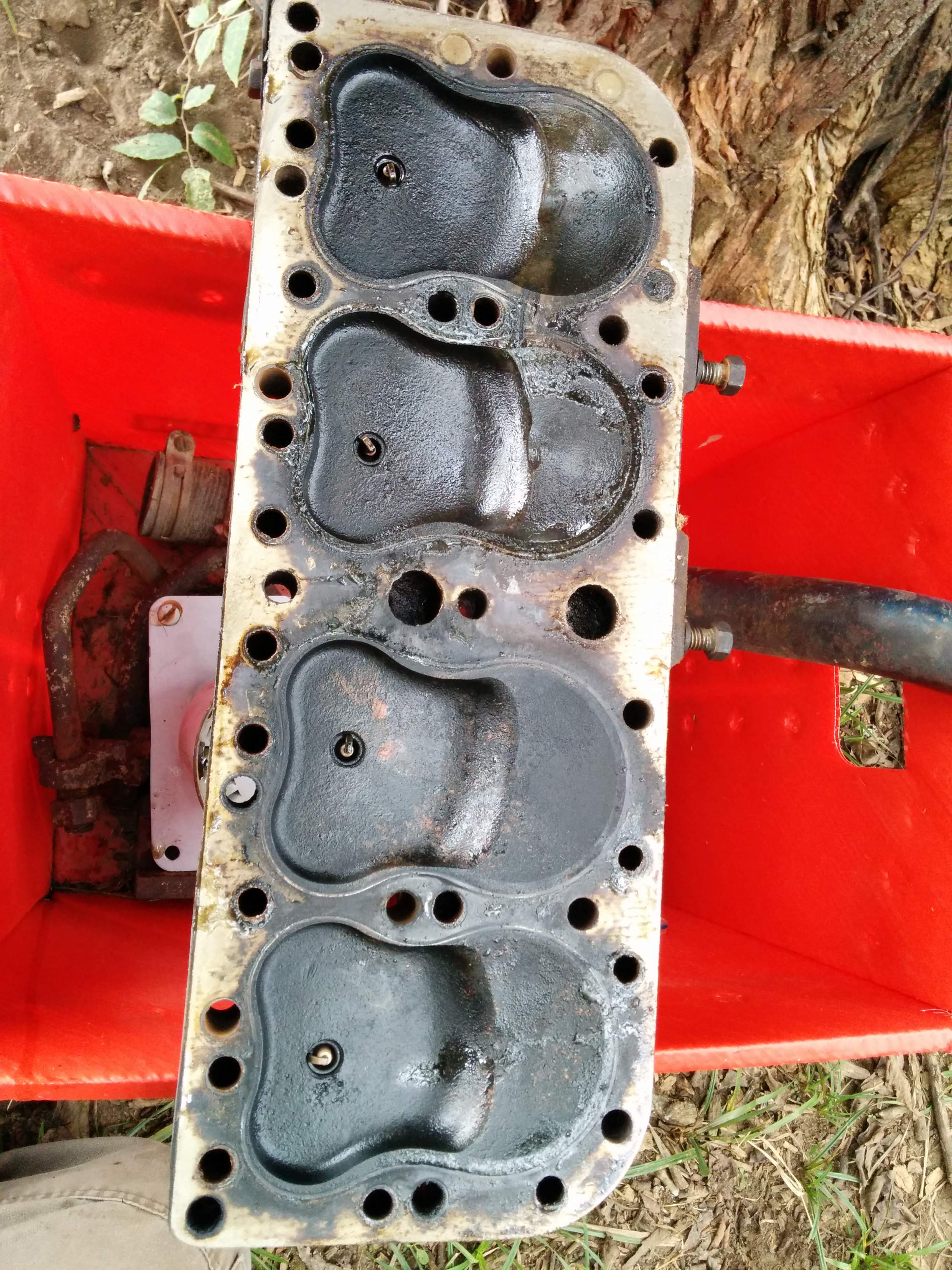

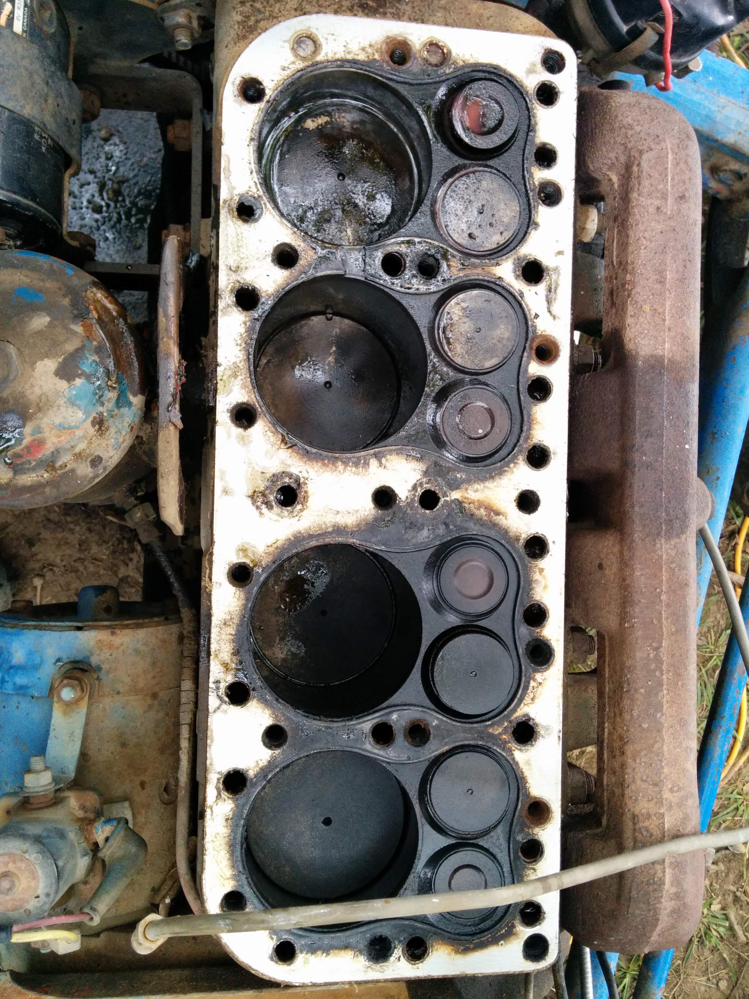

   / I need my 1952 Ford 8N to start... please help!!
#27
Anyway, I got the head removed yesterday. Doesn't look like I had a stuck valve.... it was a blow head gasket. The gasket was completely GONE between #1 and #2. Do you guys concur?
Also, I have included a few photos for your review. I took a lot more than what is shown here.
My questions:
1) I will use Permatex #2 gasket sealer with a new metal gasket after cleaning up both surfaces. Any tips?
2) Should I order and install new valves? Is that something you should automatically do? I have had this tractor for < 1 year but who knows if/when it was done before.
3) What does the block and head look like to you? I am talking specifically about the carbon marks... Does that look OK or indicate any other issues?
I'd like to do what I need to do before I button this thing back up.
PS: The cylinder walls looked really nice!

   / I need my 1952 Ford 8N to start... please help!! #28
Looks like you found your problem.
I wouldnt use that specific gasket sealer. They make a copper based spray stuff that is made for head gaskets.
Product Selector
Thats what I would use (and have done so in the past).
AS to replacing anything else, I wouldnt. Cause short of doing a full out rebuild, how do you know when to quit? New valves.....might as well do a new cam/lifters.......then might as well do the timing gears.....might as well pull the motor and throw in new bearings.....pistons and rings.........etc. Just never know when to pull out.
So fix the issue at hand and stop there. :2cents:
   / I need my 1952 Ford 8N to start... please help!! #29
1, you already KNEW you didn't have a stuck valve, as you saw them moving!!!! Even though the other poster thinks you can have front-half of a broken crank and front half of a broken cam, and still magically have the back half turn..... ( wow! )
you will likely SOON have ANOTHER blown head gasket if you use permatex #2 on it.
if the hed and block don't look tracked and pitted in the blown out area, i'd clean it up well with brake cleaner and a swipe with a green scrubby, allow to flash dry, then i'd put my new hg on, and , if you think the deck or head looks bad enough to warrant it, some copper coat spray on the metal gasket.. or indian head in a fiber gasket.
install and torque, let set and cure a day
then run engine a few minutes to get it warm and retorque
