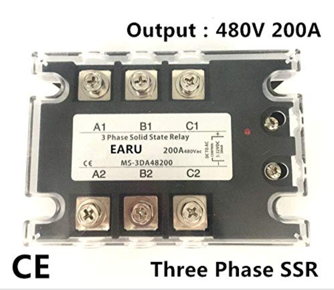

I have several. They're just 3 triacs in a case with a single input.
Internet example:
Not sure the link below will satisfy your curiosity depending on in depth your "how" is, but it will at least show you connection schemes that will yield useful voltages.
https://www.power-tronics.com/help/wiring-diagrams/Terminal-Chart.pdf
You are speaking of the WRONG terminals. The load is easy, the CONTROL can not be poly phase. But there are "Zero Crossing relays". just not poly phase. ;-)
