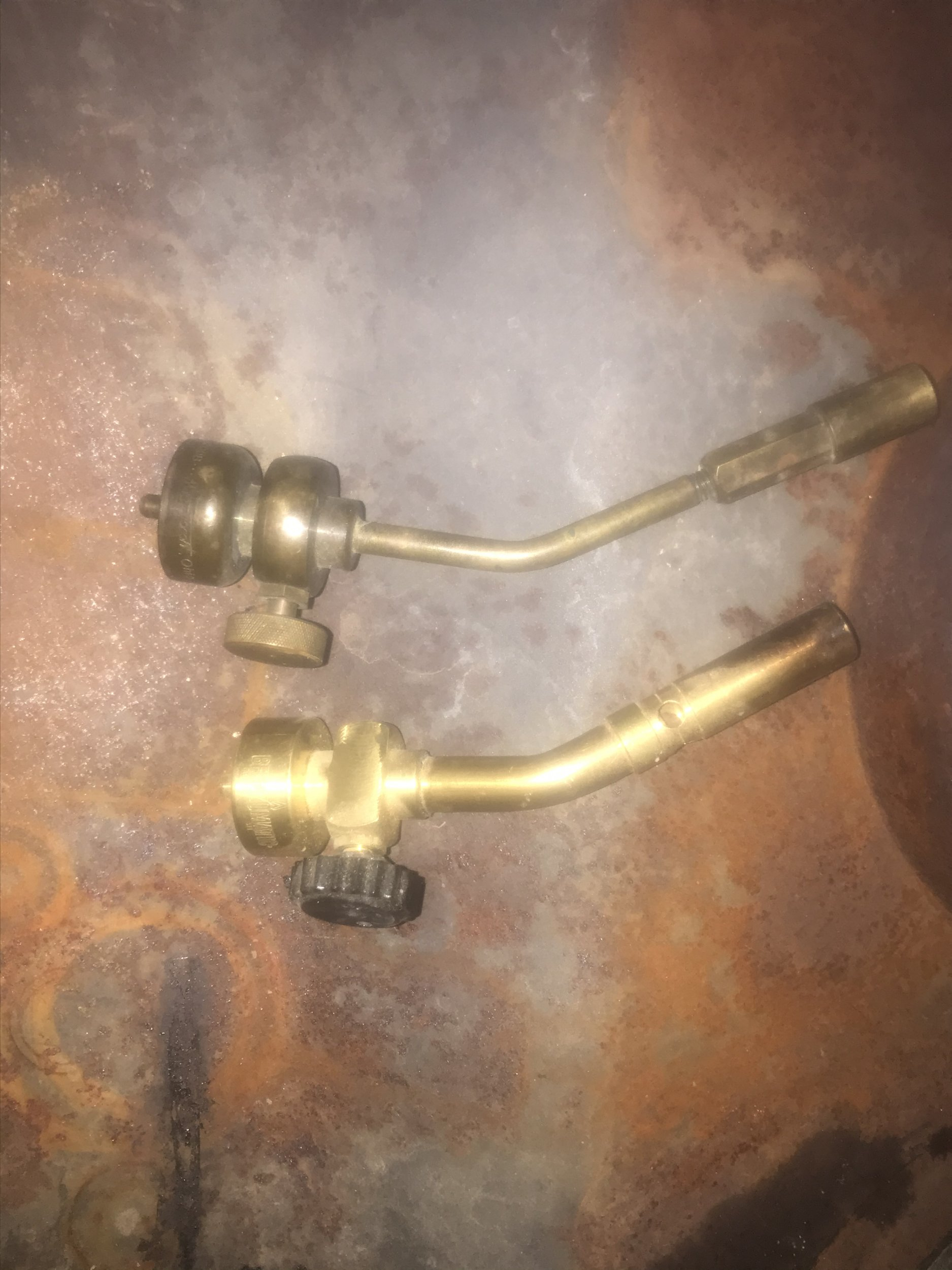

Just a simple, basic torch which screws onto a disposable cylinder and burns when you light it. Heat, solder, or start a bonfire, then turn off the valve until next time. That seems like an easy request but I haven't found one yet. I've bought two Bernzomatics and another brand (I don't recall the name as it went out in the trash.) Screw the tank on, light it and it may sputter for a few seconds but then it goes out.
Has anybody bought a torch in the last 5 years that worked?

No danger of that happening. I’ve set foot in HF exactly twice in my life... once to see what they were like, the other to buy an engine for my Troy-bilt. The torch I’m looking to replace is a brand new Bernzomatic... CBEC3066-D0BB-43FC-92F4-FCA0AFA189BA.jpeg
I used it just once, not long enough to start a fire in my wood stove before it stopped working. I’m not sure where the other came from, all that I know is it doesn’t work. Thanks to everyone who answered my question. I’ll probably pick one up as you suggesyed, the next time I'm in town.

The auto ignition ones work well overall but a couple things. 1 - It won't want to light until the gas is all the way open or nearly so. You try to light it at partial flow and it probably won't work or it will just blip a little. and 2 - I have seen where the spark tip is not sitting in a good spot to make the spark and light the mixture, so it can help to tweak it a little until you find a spot that lights well. Don't go crazy, but if it is not lighting reliably try tweaking it.

Bernzomatic has come out with the TS800, which is adjustable, otherwise like the TS400.
Selector
They also sell the old style.
MAPP gas (a stabilized mixture of methylacetylene (propyne), propadiene and propane) is no longer available for the most part. MAPP was great when you needed to braze.
MAPP (5300*F) burns much hotter than MAP-Pro (3730*F) or propane (3600*F).
MAP-Pro is just a little better than propane, and butane burns at ~ 1,970°C, 3578°F.
It seems the price premium for MAP-Pro ($13/14.1oz) compared to propane ($5/14.1oz) is trading on the old MAPP name.

I have the same problem with a Bernzomatic and with the one that it replaced. It just won’t stat lit. Won’t burn when inverted for more than a few seconds. Basically makes it useless. Sounds like the $20 unit is garbage and the $50 unit works as designed. I wish companies would stop selling things that they know are junk.

I'm thinking the Bernzomatic has a replaceable orifice.

you say that yours doesn't stay lit- do you have it turned up all the way?
