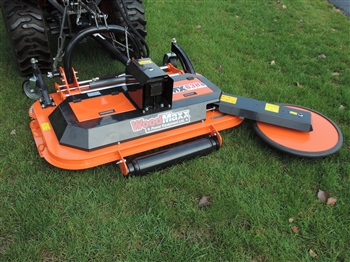

I don稚 know what I paid for the 60 mid mount for my BX but maybe $1500 or a little more. You can spend over 20k for a F series Kubota.
   / I need a new mower! #27
That looks pretty darn good as far as access goes. Not quite the complete stood-up and open of the front mounts but looks easy to get to blades and wash things out. Even just being able to lift it well clear of the ground and shake things over some rough ground would be a big help.
The Ls really have some nice features and capabilities, I sat on a Grand L6060 at the dealer and that was by far the nicest tractor I've ever been on, that was a really nice machine. Even the little ones are too big for me though, really want the light weight and the small size of the Bs though. The heavy stuff the Case can do, lighter stuff in the orchard and on the turf could be handed by a little machine.
Nice Ram too!
Got a Woods 60" groomer on the back of a BX24. When I want to get back of the mower up, I have a little slope that I place the 2 back wheels of the groomer on and tighten the top link all the way. Even as low as the little BX is I have plenty of room to clean underneath the mower. Instead of a slope, sometimes I'll use a jack stand, lift the mower with the 3pt, place the stand under the back of the groomer and lower the 3pt, tighten the top link, then lift the mower back up.
