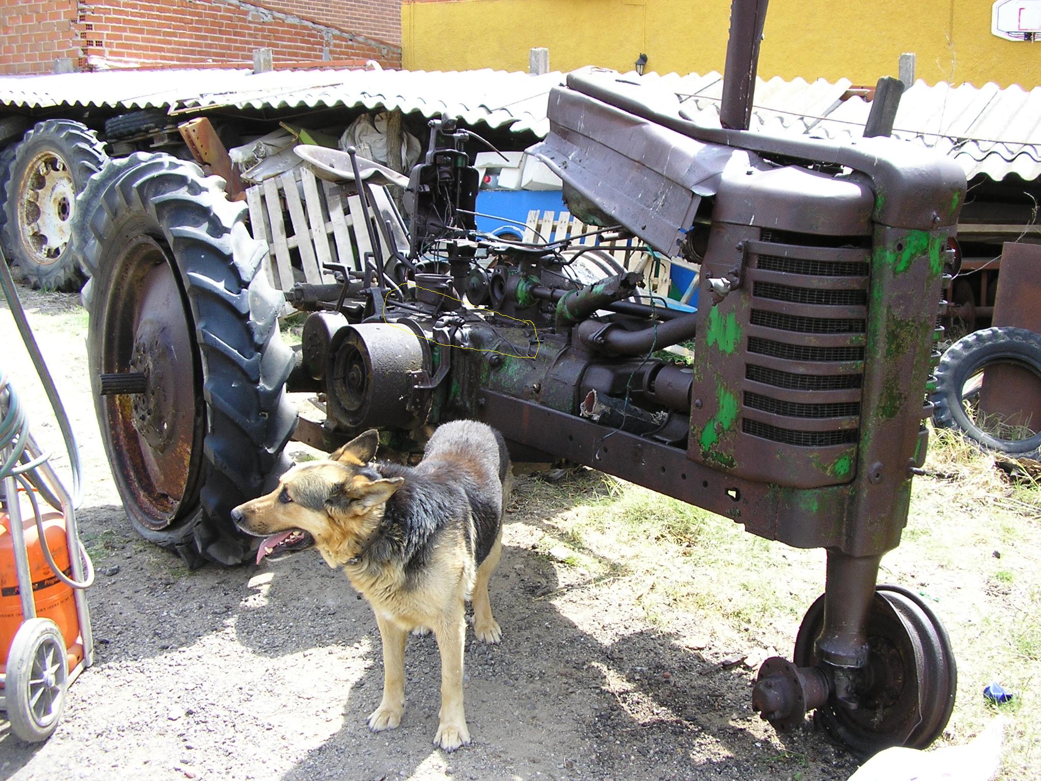

Hi from Spain, this is my first post in this forum and I´m looking for a pictures of John Deere Model A styled like this, with this dash to restore.
Picture of serial number plate of generator
Picture of the serial number plate of starting motor
It hasn´t got number plate and I would like to know the year of production. The generator Delco-Remy and the starting motor Delco-Remy have the number plate but I don´t know where I can to consult this number and his year.
Only I have the parts guide but the model with this dash isn´t in the guide. Any information will be welcomed. Thanks.

Welcome to TBN. Good to see one of these old gems being restored overseas! Dad has a slant dash JD A like that that my grandpa bought new in 1945. Unfortunately I don't have any pictures of it. Without a serial number plate it will be nearly impossible to date that model A, or any other Waterloo built 2 cylinder. However, one option would be look up some of the parts numbers in a JD parts book and you may be able to narrow it down to a production year if you're lucky.
I'm not entirely certain that the slant dash was used during this entire period, but the early styled A's were built from 1939 through 1946 with very little production during WWII.
You could also try contacting Green Magazine: Green Magazine - Online for John Deere enthusiasts or the Two Cylinder Club: Two-Cylinder Magazine for collectors of John Deere Tractors to see if they can help you narrow it down to a certain production year. Their main area of expertise is 2 cylinder JDs. Good luck on your search.

Hi, I´d like to get pictures of the gauges to know exactly what models are, pics of the rear side of the dash, pics inside tractor, pictures of the carburator (It hasn´t) and the laterals of tractor, pics of the rear light (neither it hasn´t), pics of the delco distributor, of the ignition coil and I suppose that a few more. With Google saw a little of this model. John Deere models only have this and a 515 with diesel motor (in Spain all the tractors and trucks are diesel). Thanks again.

If I remember correctly, the serial # would be in the area circled in yellow on the horizontal surface of the housing, close to the breather mount, might have to scratch off paint and grease.

If I remember correctly, the serial # would be in the area circled in yellow on the horizontal surface of the housing, might have to scratch off paint and grease. I think it's more in the area of the white circle close to the breather mount.

Gallery of little evolution. Rear rims from tractor Ebro and front rims from tractor Fiat
Other pictures. The hood and the broken cylinder head (it hasnエt serial number)(maybe can be the A2325R, I donエt know). In accordance wtih the partエs catalogue (in the page 10) the part with number A2383R (on the cylinder head) is from a Model A with serial number between 488000 to 583999.

You've got a lot of work done already, keep us posted on the progress, looking forward to seeing it finished. Thanks
   / I need a lot of pictures of a John Deere Model A styled. Thanks #20
Thank you for the update, it's looking good and shows you've done a lot of work. What parts are you missing, I see the clutch cover is not on yet and what is broken on the engine? Those old two cylinders are music when working.
