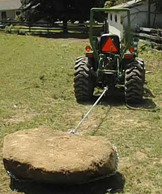

I moved a similar size/shape rock by wrapping the chain around the rock horizontally. I was in a similar situation where I couldn't get the chain underneath, once I got it on snug it pulled real smooth without to much gouging of the turf. You'd be surprised how well that thick chain will grab hold of any little indent or groove in the rock and hold on.

If you have a bottle jack, dig a hole under the side of the rock in the direction you want it to go. Raise the end of the rock with the jack. Place rollers under the rock, 2 inch pipe would work well. Lower the rock on the rollers and attach the chain. Your tractor will pull the rock easily. Have a helper or two to move the rollers to the front of the rock as you progress. Go slowly so no one gets hurt and you don't run off your rollers. It will take a little time but you can move that rock where you want it.
