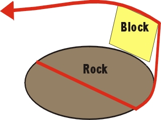

Jerry, if you need to roll that rock onto something like plywood to use as a skid, you can use the lever method I've shown in the attached illustration. By wrapping a chain around the rock as shown and pulling in the direction of the arrow, the block provides additional leverage to roll the rock. The bigger the block, the more leverage you have. ...just another idea.

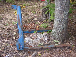

Here is a picture of a slightly stronger carryall. If you reinforce your existing carryall as Gary_In_Indiana suggested and put tabs on in the nature of this one for the cat1 pins, it should carry most anything your tractor will lift. I know I've had my little Yanmar so loaded that I had to drive it with the brakes. /forums/images/graemlins/wink.gif

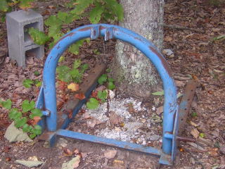

another angle

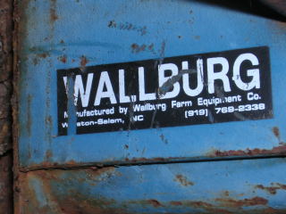

the manufacturer info

JIm, thanks for the idea. I'm sure it will work.
Jeff, my local tractor yard has those in stock. It did'nt look much heavier to me. Does the round tubing add the extra strength?
