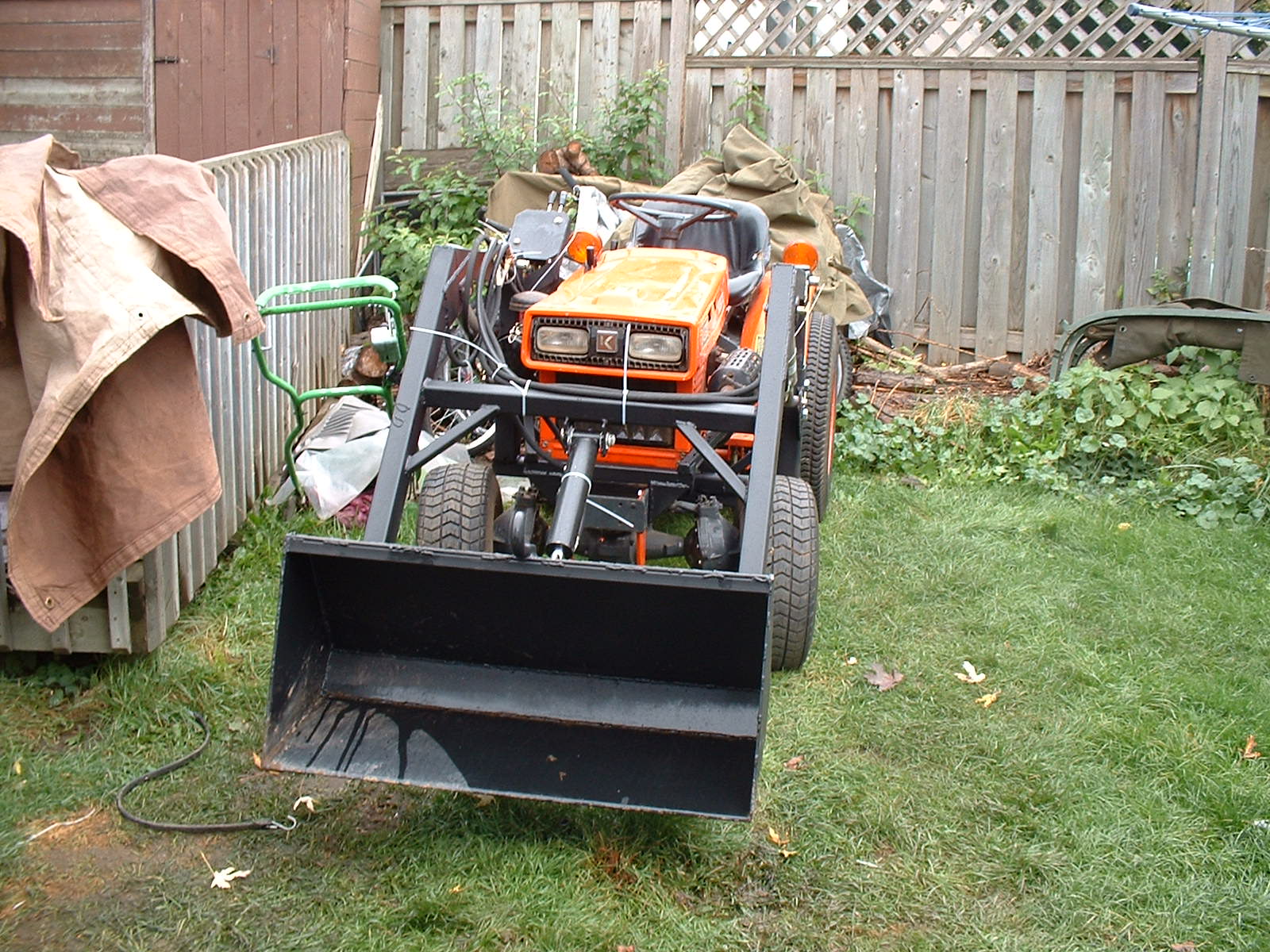

   / I need a 3 point hitch geometry lesson. #27
Id like to see a picture of the FEL. It must be heavy. I built my FEL with a 36" bucket for my B4200. I run about 200" counter weight (48" blade with 100LB of bar bell weights. I can heap my bucket and I use counterweights more for steering a non-power steering tractor then for stability, though its a bonus.

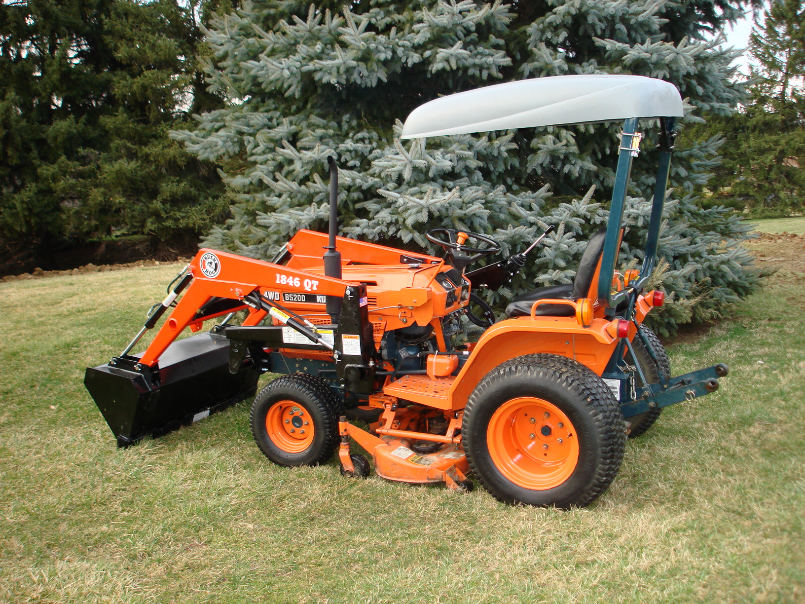

Here is the rest of my B5200. I really like it alot. Acerxp, I have been a little under the weather lately with the flu bug, and that is why I haven't got you dimensions yet. Just looking at the ballast pic, you should see where you need to go. Measurements can vary as the top link adjusts for any variances.
My FEL is rated for around 800lb of lift, and my counter balance offsets that to the point that if the FEL maxxes out and can't lift, the rear rires stay on the ground, with me in the seat of course.........Never tried it otherwise. My counter weight is at it's lightest, as it is about 3/4 of the way full, but will accept sand if ever needed.

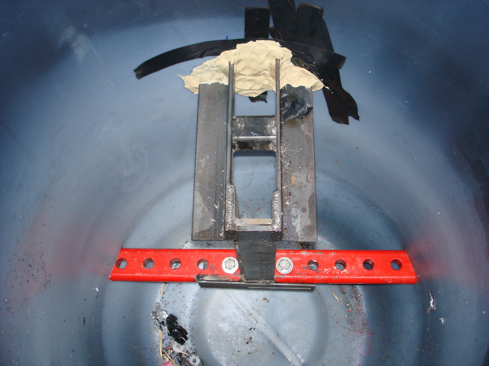

Here is the frame I built inside on the counterweights. Yeah, two of them..:rolleyes:
