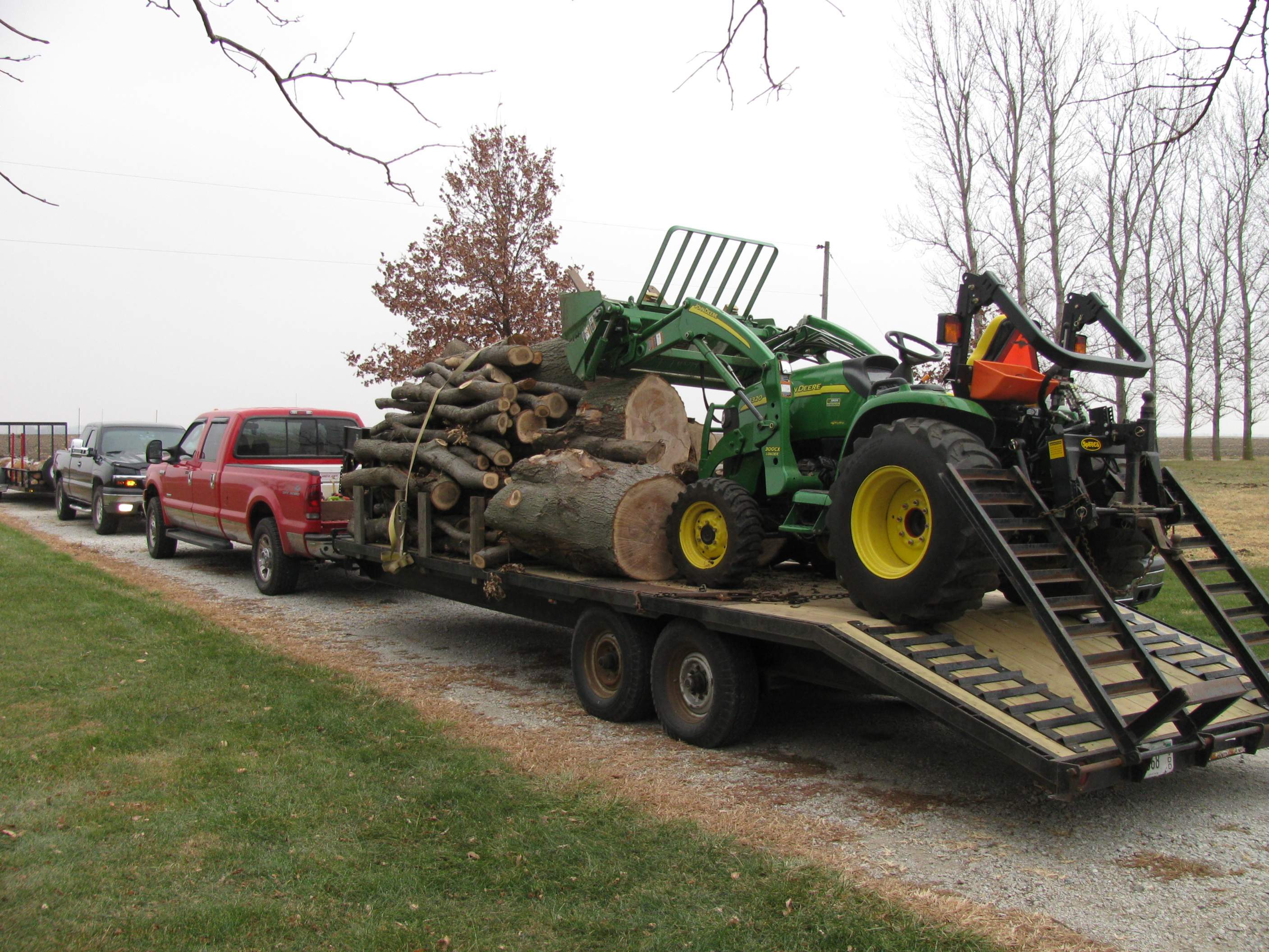

I have had a Frontier 5' 4in1 on my 3320 for a couple of years. I would no get a 6'. It is great for picking up that last little bit of rock or dirt and moving brush and limbs. I would not use it to pull stumps or pick up loads sticking out the front. I take great care not to do stupid things that might spring the bucket but I don't baby it. I have never owned a grapple so I can't advise on that. Everything loaded on my trailer was put on with the 4in1.
Dan

Hey Dan,
Do you also have a regular bucket and would you buy the 4-in-1 bucket again?
Bob W

I guess there are a few reasons. The 5' and 6' Frontier both have the same jaw opening and the same structure. 6' is not more heavy duty snd I thought it would be easier to damage. I have seen buckets on full size back hoes sprung pretty bad. I use the machine in the yard around a lot of trees and 5' fits better. I gave a neighbor that has a 6' HD bucket on the same tractor and I think it makes it feel sluggish. He likes my 5'. My sales man recomended the 5', it was cheeper and it was in stock.
Hey Dan,
YES
When I bought the tractor I got the 5' HD. Another $2200 was not in the budget when I needed other impliments first. If you can afford it I would get the 4in1 as the first bucket. The HD bucket will hold a little more but for now is collecting dust. The next best front attachment is my forks but that is another topic.
