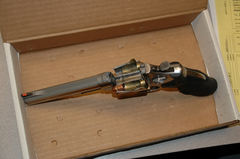

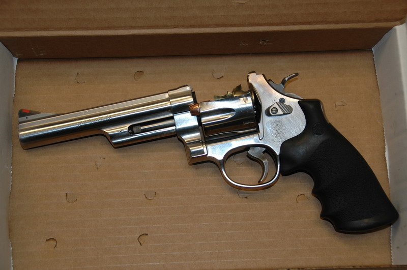

Unrelated to the specific topic but a good example of what can happen when proper methods are not observed. I just happened to have these sent to me today...This is/was S&W 629..

I have seen and read many instances where that kind of destruction was caused by detonation of a too light target load. In those cases instead of burning at a controled rate, the powder detonates like a high explosive due to too much empty case space. I am not stating that is what happened in your photos but it does look similar to others I have seen where the shooter insists they were shooting light tatget loads.
