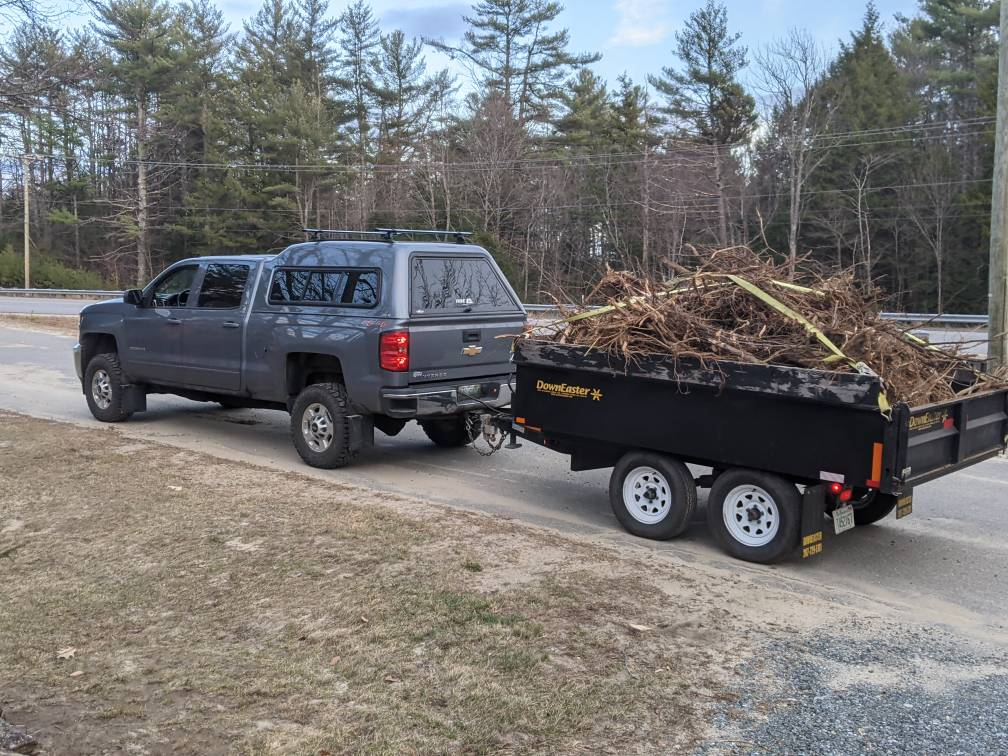

That looks like a case of street tread tires and no lockers. Tires that are nice and quiet on the road and on wet pavement conditions are never any good in wet grass and mud. A better all-terrain or even better a mud tire and lockers front and rear and you would probably just drove out of that situation, well if you locked the lockers prior to spinning and digging in too deep. :)
Nope....duratrac tires, rear axle locked, all four tires spinning.
The far side of the truck was more sunk than that picture implies.
That trailer also had two yards of dirt in it when I got stuck and it sunk pretty good. Going forwards is up a hill and it just wouldn't go once it found the mud.
Can sorta see the tires and normal height of the truck here.

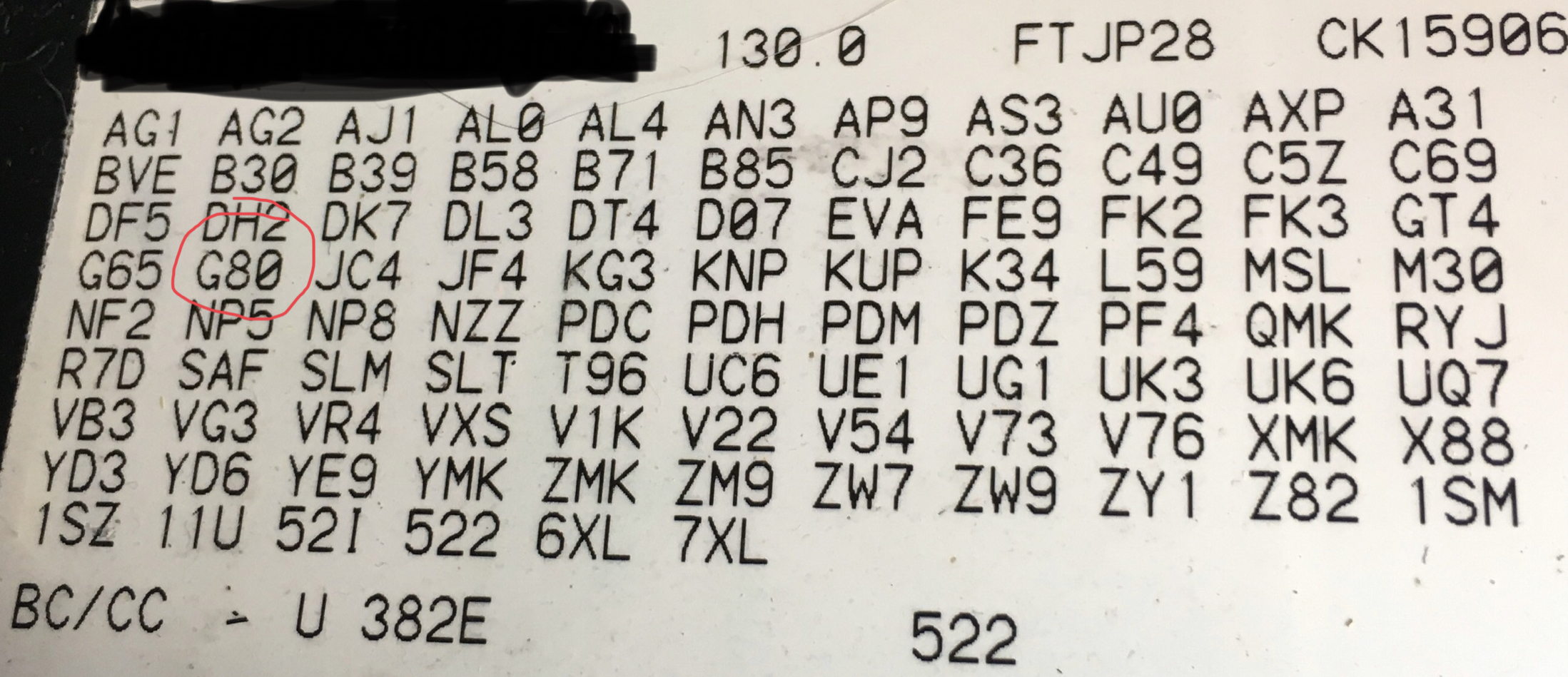

Scaredychicken,
This link goes to a PDF file that shows everything your truck was available with.
Page 13 shows all the different axle options that were available.
Page 16 shows all of the RPO codes for the options.
In the left column, you can see the different axle ratios and the code G80. That's for the rear axle locking differential option.
If you open the glovebox, there should be a label with all of the RPO codes that your truck came with. If you see G80 among those codes on your sticker, you already have a locking differential from the factory. If you do not see that G80, then you don't (from the factory).
For example, my 2003 Suburban's label. It shows RPO code G80. That's an automatic locking differential (circled in red).
   / I have owned my last 2 wheel drive pickup #206
Also, if you look at my codes, just before G80 is G65, self-leveling shock absorbers that are about $400 EACH! :eek:. And GT4, which indicates 3.73 rear axle ratio.
There's all kinds of stuff you can figure out from the RPO codes on that label.
It's really interesting and kind of handy to take a picture of that label and then use google to find out what each code means, and write it down for future use.

I am under the impression that the G80 option differential will lock anytime one of the axle speeds exceeds the other by 120rpm. It has no way to determine actual MPH.
