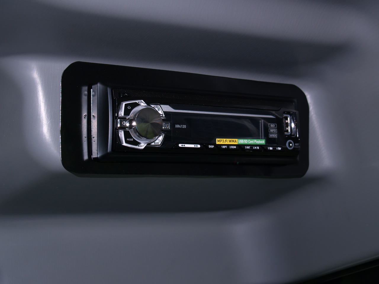

Installed the radio. I was very pleased on how it turned out. Also had to open up the roof to run the mic for the bluetooth phone thing. Not real sure on the factory speakers just yet. Not to thrilled about them. Dont know if there is anything that can be done. Would be nice to mount some more speakers but where you would I dont know.

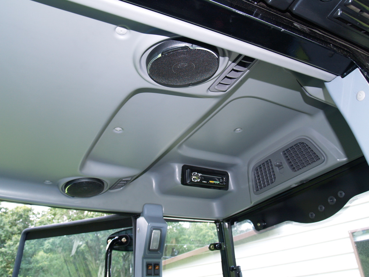

I completed a radio installation myself about 2 1/2 mos. ago. It turned out to be quite a project. I finally settled on a radio with a USB and SD slot, w/o cd player as it weighs only 1 1/2 lbs. vs. about 4 lbs. (and I couldn't see a playing a cd while on rough terrain).
I did replace the anemic speakers provided by LS with a pair of Kenwood 3 way speakers (nice for a 4 inch speaker). The speaker install was a b**ch.
After all was said and done it was well worth the aggravation. So nice to have to music.

Oh yah! I found that after installing the radio, the stock speakers could take no volume (that would be required while operating) or even the slightest increase in bass without the speakers rattling. So, for about $50 on Amazon.com I purchased some Kenwood 3 way replacements. The difference is huge.
My installation cost was just over $100 that included an AM/FM radio with an SD slot and a USB slot, and the replacement speakers. So far I've "copied" 7 or 8 CDs to a 2 GB USB stick and there's probably room for about 25. That's a few hours of "your own music" when the radio reception is questionable. P1010920.JPGP1010919.JPG
