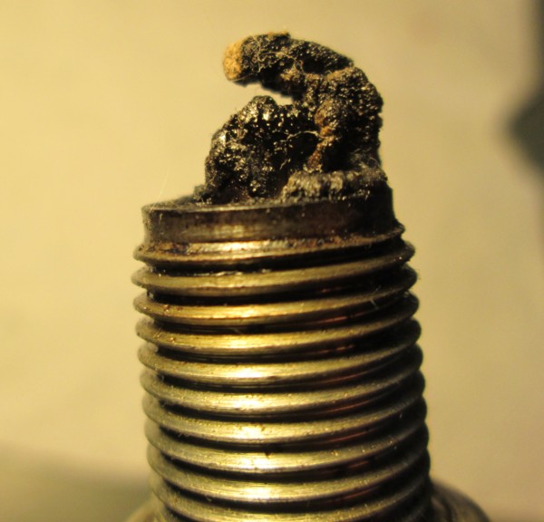

   / I hate small engines that have sat not used. #45
Haven't seen a fouled plug in 20years of using Avgas.

   / I hate small engines that have sat not used. #49
Somebody who never revved their engine over idle with a wide open stuck thermostat.
Still, Cheaper than a carb.
That was taken out of a plane with an auto engine..
   / I hate small engines that have sat not used. #50
Somebody needs to learn to lean their engine during ground ops - or is the auto engine not set up for manual leaning?
I did my initial training in a Cessna 150 that really didn't like 100LL. It was OK in cruise (though you still needed to pay attention to the mixture for best results), it was a killer on the ground taxiing/idling.
