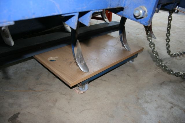

I used to hate connecting up my implements as it was dificult to line up the 3ph. It took a lot of effort and grunting to get the pins in. No Longer! I made trollies to mount them on. This allowed me to move them into alignment easily.
My slasher now takes only minutes to fit. I did find that it is a lot easier to pick up and put down if the trolly has a support to allow the implement rear end to be higher than the front. This allows the implement to be connected at the correct angle for the height.
An added bonus is that I can now use my garage much more efficiently as I can now move them arround rather than having to position them so they can be picked up on the 3ph.:)

I will not be going to my block for another couple of weeks so I will try to paint a word picture.
For my slasher, I have a square of 2 1/2" angle iron approx 1m each side. This has a heavy duty castor on each corner. As the slasher is wider than this, I have welded outriggers with a length of 2 1/2" angle to the sides. This is used to stop the slasher from moving off the side of the trolley. I found that it made itr a lot easier to attach if the slasher was put on the trolley at the angle that it is when raised at the height of the trolley. To do this I simply put a block of wood across the back of the trolley so the back was supported at the correct angle.
For the spring tyne harrow I just made a smaller trolley and put a board on it. I also found that it needed the back higher so again it has a block on the rear edge.
Note: These are for my ease of movement and may not be totally stable. Keep clear when moving them. Most importantly do not sit on them:eek: or let kids near them.

I have attached a couple of pictures of my trolleys. Note the pieces of wood used to raise the back of the implement to the correct angle to allow connection without having to adjust the top link.
