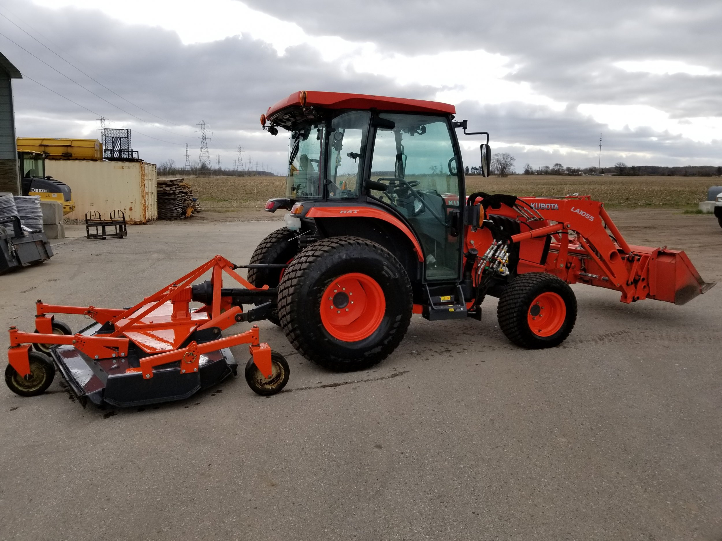

I'm a little late to the conversation but here's a setup i use to mow some very fast growing commercial construction lots every 2-5 weeks depending on the time of year at 3.5". This is an old woods rm990 rear discharge mower that i found on craigslist for 1200 bucks. I'd just sell off that other stuff and pick up something like this. You'd probably break even on cost and be done cutting in half the time with the clippings evenly distributed behind you.
