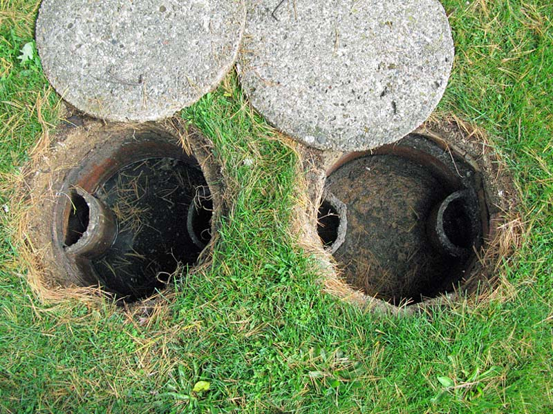

Yes, we have 3 separate tanks. Many single septic tanks have two chambers inside. Ours are just separate. As I understand it, the heavy solids settle out in the first one and are digested more before passing to the next. The liquids and lighter solids flow on to the 2nd one. The liquids pass on to either a dry well, or a leach field, where the liquids are supposed to seep into the ground through the bottom and holes in the sides of the dry well or holes in the leach field fingers.
However, over time, some solids may pass on to the dry well or leach fields and plug them up. That's what happened to our dry well many years before we bought the house. So the owners installed a long leach field from the top of the dry well water level. In effect, our dry well now functions as a settling tank for anything the septic tank(s) would pass on.
   / I had to use the laundromat tonight... my house STINKS! #54
They look like this (not my image)... and are 24" in diameter and about 4-5' deep each. Note the baffles that are supposed to keep the solids from moving to the next tanks.
Ours are buried about 18-24" under the lawn.
