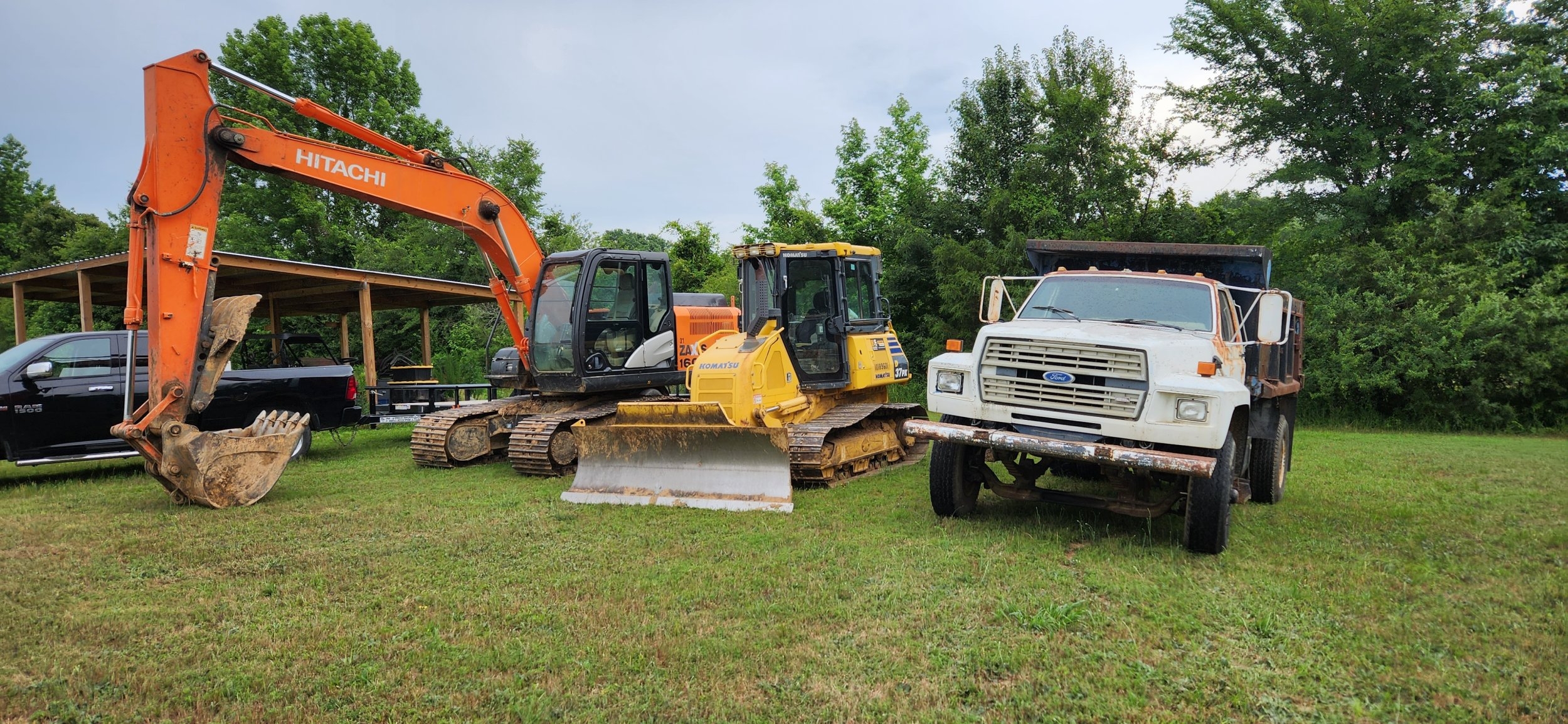

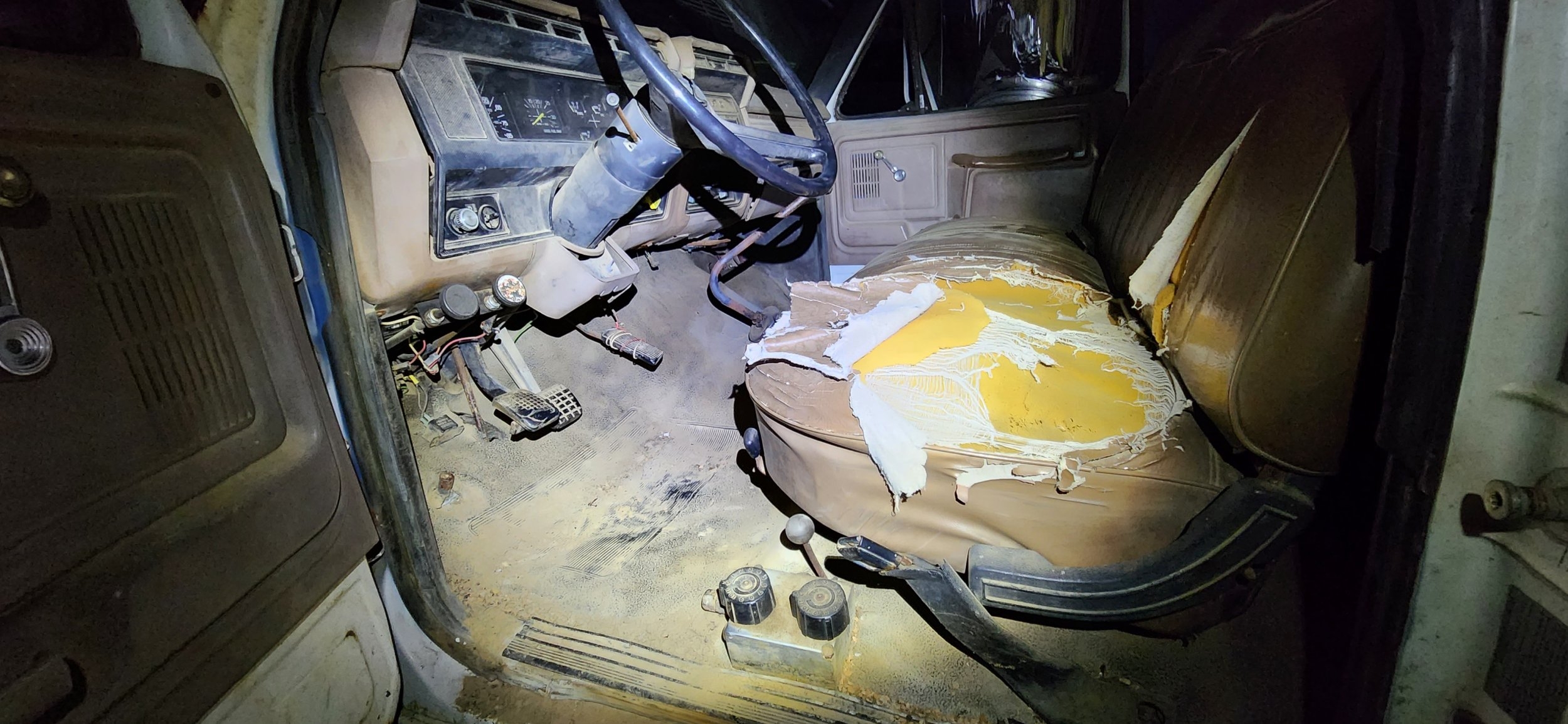

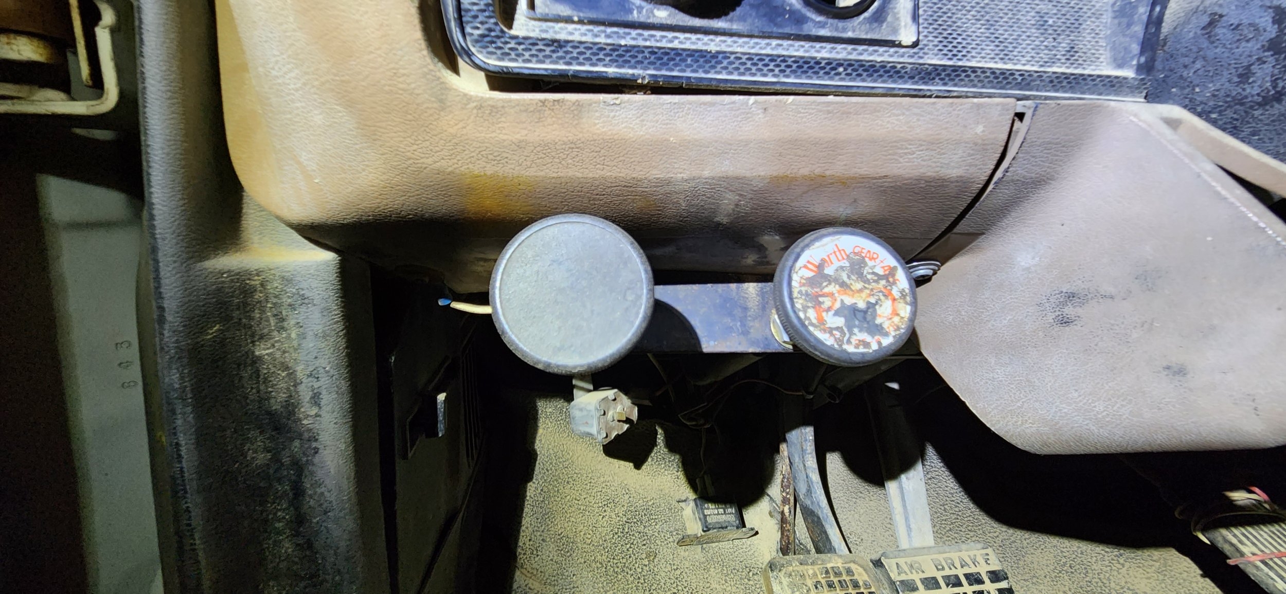

The title is no joke... I don't know how this thing works... it's an old ford that I'm borrowing. It was delivered today and I have never run it. I can drive it, it's just a 5 speed with air brakes. I don't know how to lift and lower the bed. The 2 knobs in the last picture operate cables, each one pulls out. That looks like the best bet for controls. The block in the floor looks to be spreader controls and there is no spreader. Anyone have experience you can share?

The pair of buttons at the 3rd photo ,I think are red herrings.
The 2 dials and lever are the contros you want. 1 dial will engage or disengage the pto. The lever is to raise(back) hold(centre position) and lower(forward) the body.
The 2nd dial would likely be for the tailgate trip. I am assuming the trips are manual, and that you can do spreading.

One of the knobs under the dash is going to be to engage the pto and the other one is to idle it up and then the one beside the seat will work the bed and one of the knobs should unlock the tailgate

From my experience my guess is you want the 2 knobs under the dash on the left side. 1 is your cable to engage the pto to power the dump. You must depress the trucks clutch before you pull on the right knob.
The other knob is your control valve and usually you pull to raise and push to lower.
The knobs on the floor to the left of the seat are controls for a sander. Disregard these.

The knobs under the dash are for the dump bed. The right knob is marked PTO. With transmission in neutral, and clutch disengaged while stopped, pull the knob on the right out. That will engage the PTO. Let out on the clutch, normally, pulling out on the left knob will raise the bed. If you are just dumping in a pile, pull the left knob out, and it will power up. Once it reaches maximum height, push knob halfway in for the hold position if you want to pull away from the pile, and completely empty the bed.
More than likely, it has power down too. If like mine on level ground, it raises pretty high and you'll need to power down some by pushing in the left knob until it stops, until gravity takes over. At that point, you can push in on the clutch, and push the PTO knob in. When the bed sets on the frame, pull the left knob back out to the middle position. The middle position should also be a hold position on the bed, if say you want to raise the bed half way.

The controls on the floor with dials and lever are for a salt/cinder spreader. If the PTO is engaged DO NOT mess with that lever. Just make sure it is in the off position and leave it there and set both dials to "0". If the lever is set in the engaged position with no spreader on, there's a good change pressure will deadhead against the pump and burst a hydraulic hose that goes more than likely from that control to the back of the truck, inside the frame. Not good if you have a load on and have to shovel it off until that hose gets repaired. That truck appears to be an 80's model, and a good chance the hoses are original.

Operation fiddle with it and find out was a success. It is the under dash knobs. The right one is PTO the left one is the up and down valve.
Now the issue is the bed only goes up about a foot. I assume it needs hydro oil. I'm on my way out this morning for a long weekend getaway with the family so I'll have to figure it out mid next week.

I haven't seen one of those for years. The box on the floor is a control valve for a hydraulic spreader control. The spreader would slide into the dump body and connect through the valve body to a hydraulic pump mounted on the engine. The knobs control an auger belt that feeds material to a spinner at the rear. Spinner speed controls the throw of the material. The lever turns it on and off, down was on. There was an accessory box that wired up to a speed sensor and controlled the material feed according to vehicle speed. Pretty advanced for the day. You may still find some hydraulic lines running along the truck frame out to the back. We had a few of these contracted to the state to spread sand and salt on icy winter roads. During the summer they could be used to spread lime or fertilizer on farm fields. The 2 knobs under the dash would be for the dump body, one engages the PTO mounted on the side of the transmission and the other connects to a hydraulic valve to raise and lower the dump body. Like I said, that was 30+ years since I built and operated these.
