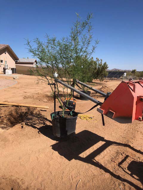

Easy way to drop 24" container Palo Verde into the hole.

It stays in the container?

No, I cut the bottom off the container before placing. Then I cut the sides off once it is in place. The only way to lift it without the ball falling apart is with the container

Got it! :thumbsup:

Need to remember this trick. :thumbsup:
