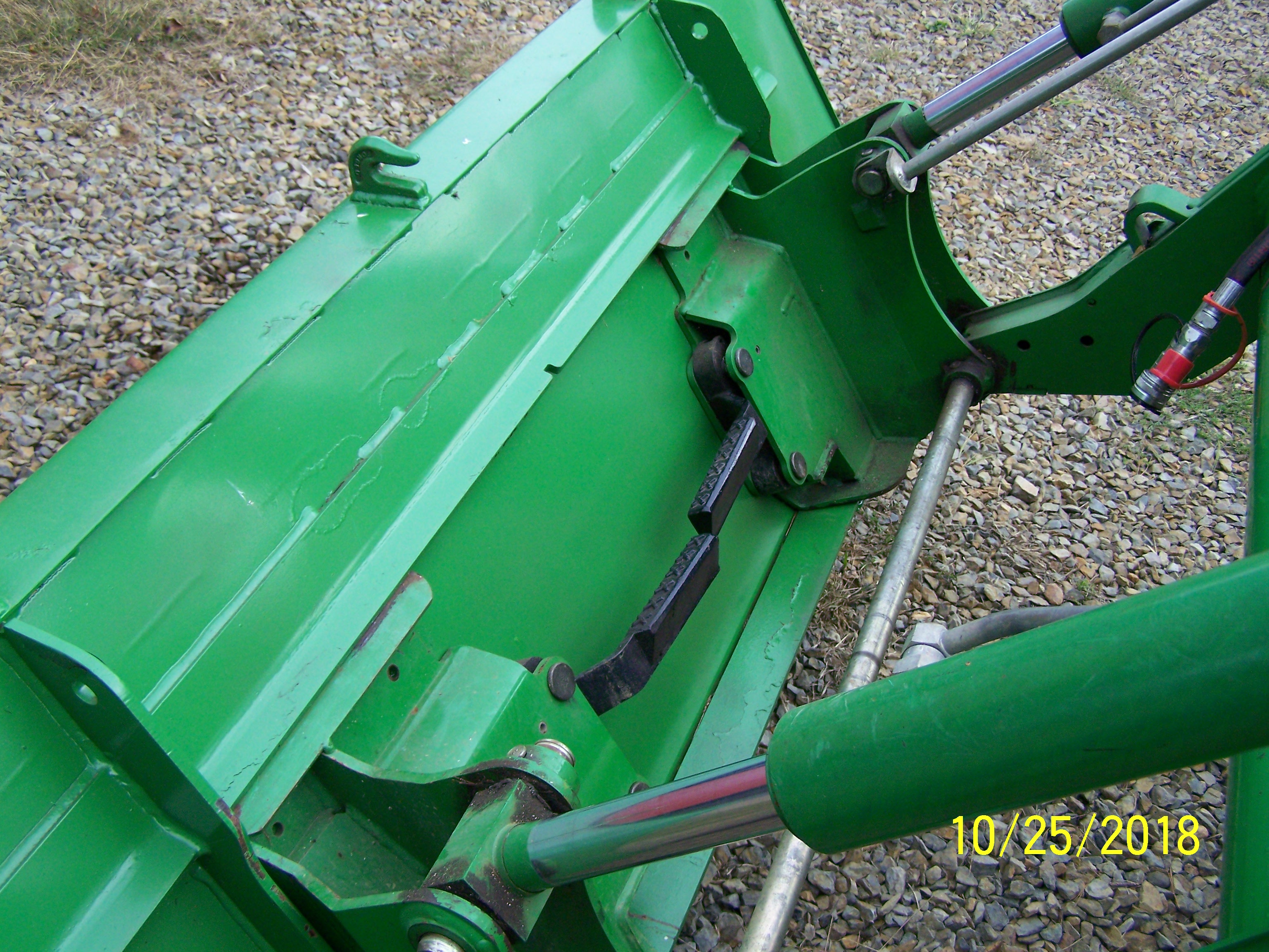

My JD 5055e had a 1 inch (approx.) rod running side to side which could rotate. It depended entirely on the attachment to maintain alignment.
No issues
No issues
Using yours as an example, look how close the top angle bracket of the hitch is to your cylinder pins. Go back and look at the OP's. No comparison.

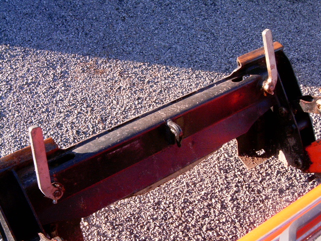

I'm betting I could bent a loader arm before my SSQA would ever bend or twist

The OP's system cannot operate independently. That's not even an issue in it's design. The issue is the vertical distance from the top angled bracket down to the cylinder pins. Go back and look at the first pic again.
