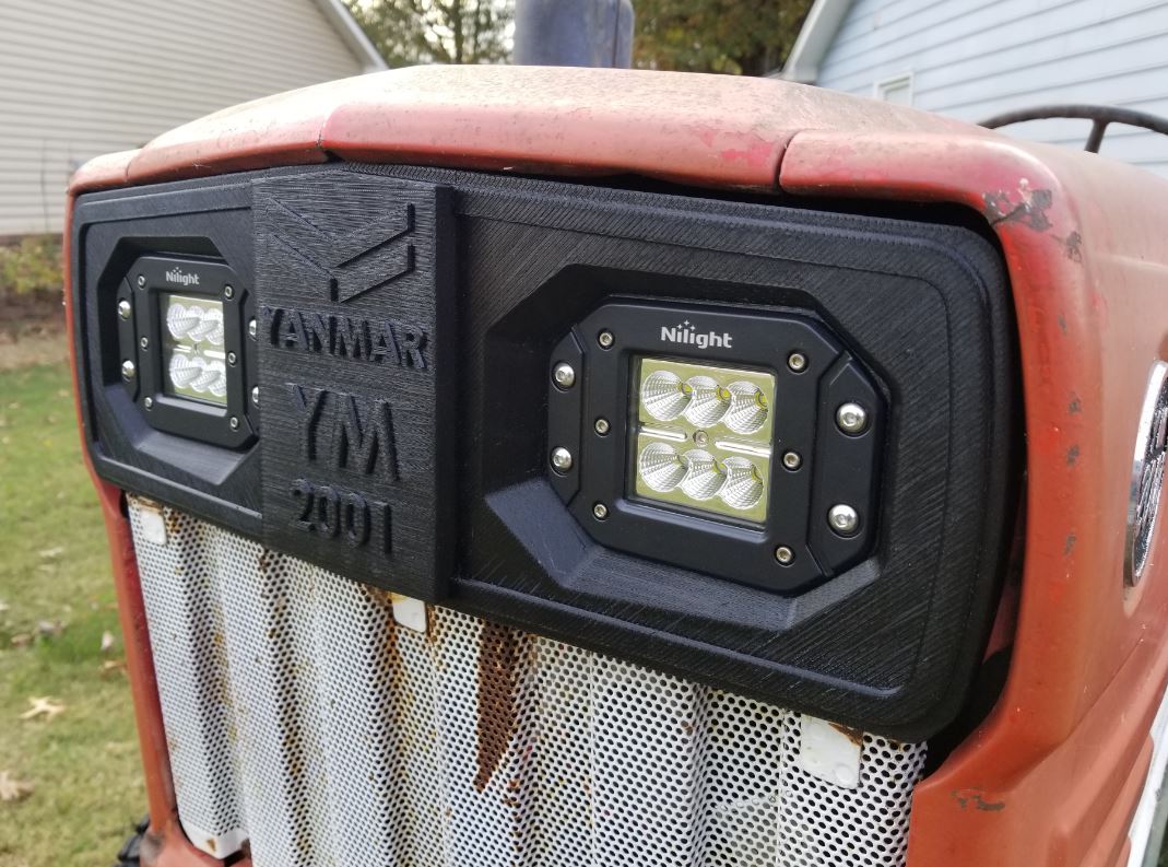

I hooked these up briefly and they are super bright!
Ok I saw the button for the "full site" I see it now.
Do you take orders? Of course it won't work the ym2000 is a different front I guess than a 2001 since that insert would not go into my tractor? It had just glass lights held in the hood.

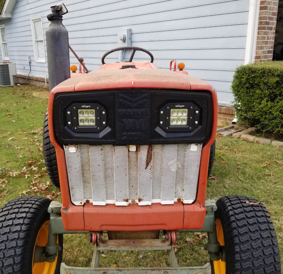

I really screwed up the TEASER. I got busy and did not finish uploading the pictures of the finished product. Here is one along the way when I had the gearbox apart to put new seals in and put fresh fluid. I redid some of the wiring and made sure that everything worked. I changed the turn signals into hazard flashers.

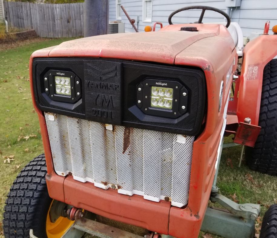

Here are some after the process. I was going to take off the body panels and paint them, but had to move onto other projects. Those lights are very bright.

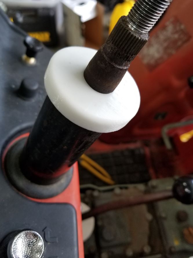

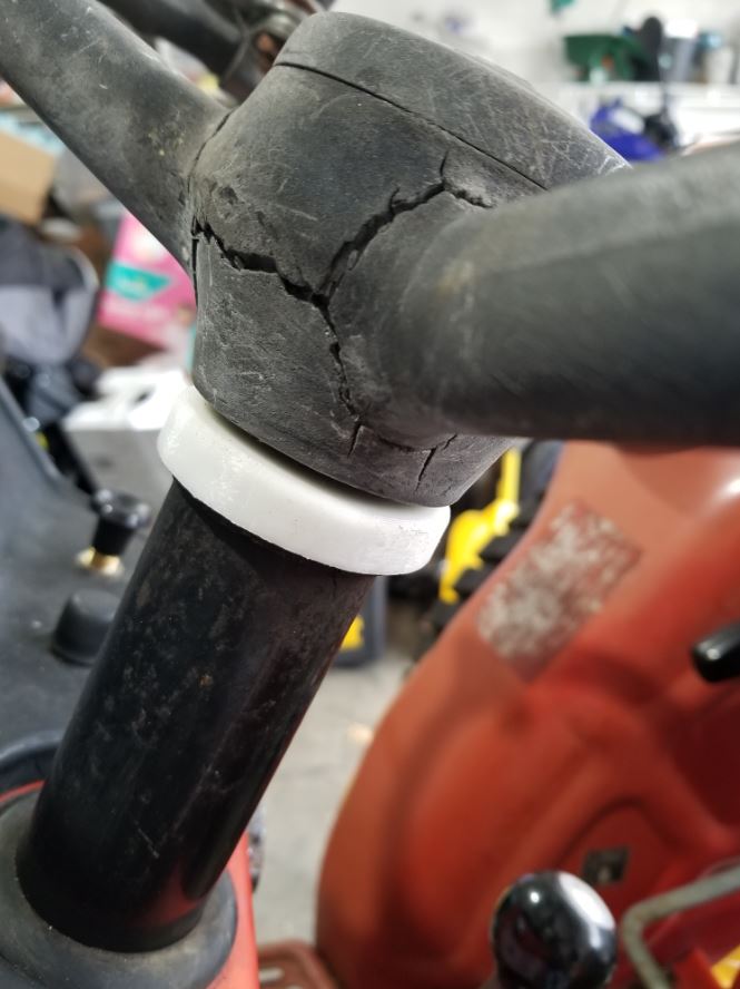

I added this thing as well. It was just to keep the water from running down the steering wheel and running into the steering gearbox. This was made with a 3D printed mold as well.

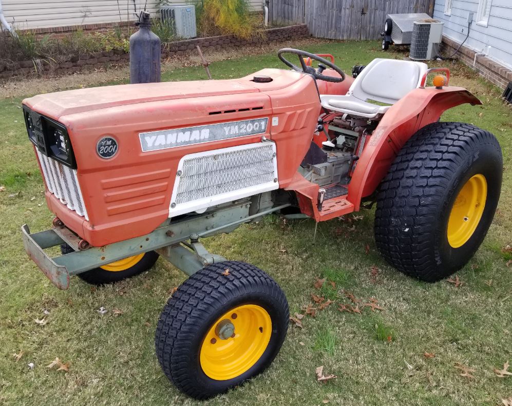

So after all this I am thinking about selling my YM2001. It has been a great tractor. It starts very easily and doesn't smoke. I cannot detect any blowby on the breather tube. The rear hydraulics do not leak down while sitting. This winter while the temperature was about 33 degrees, I started it without the help of the thermostart. That is the one thing that I think does not work. It coughed a bit for about 10 seconds and smoothed out. It really was quite easy to start at that temperature. It comes with 2 sets of tires.
I am not giving up on Yanmar. I am looking at a leftover YT235 tomorrow.
Anyone interested? I thought about posting the turf tires separately, but someone might want it all. I also have a Woods M5 rotary cutter I need to sell. I will probably post in the for sale area soon.
