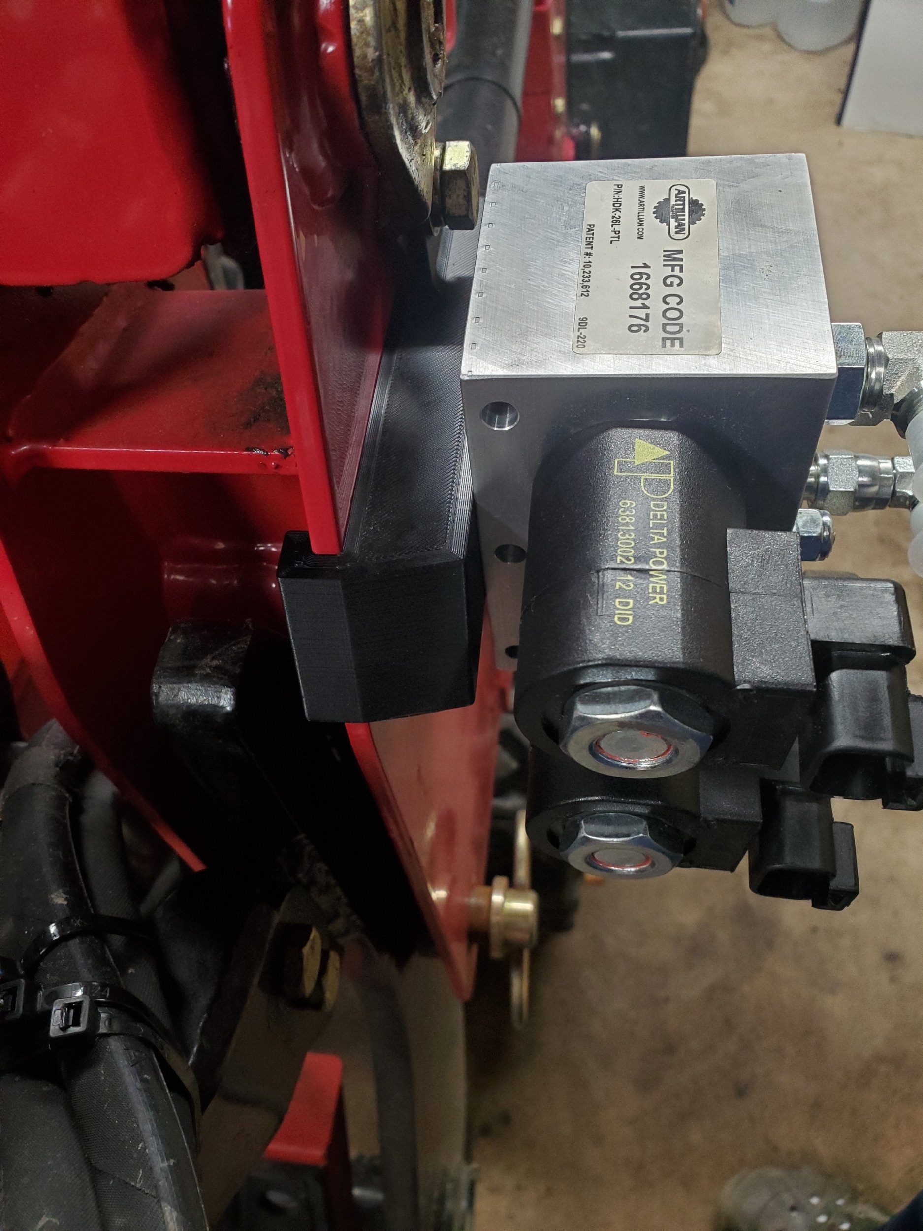

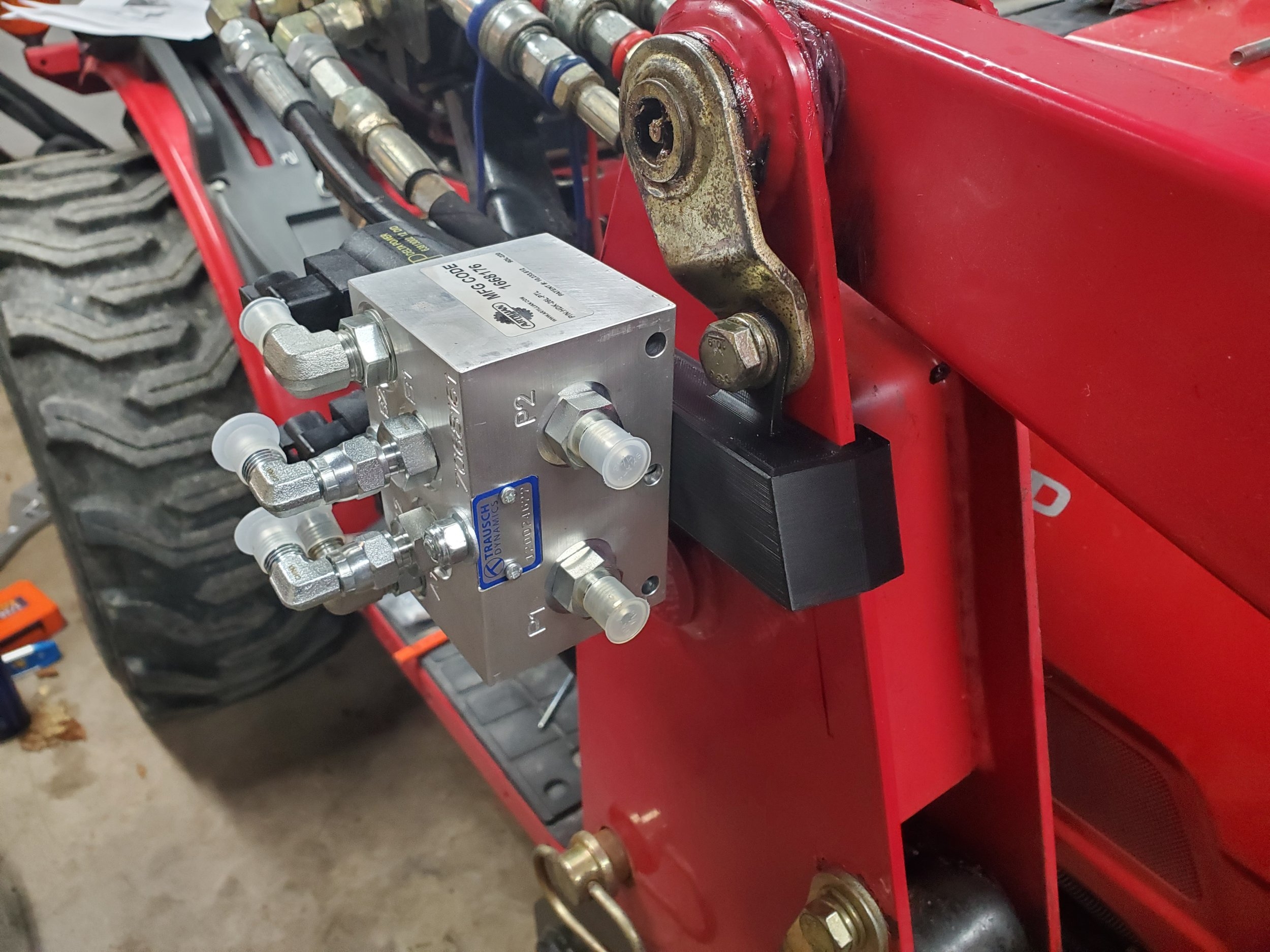

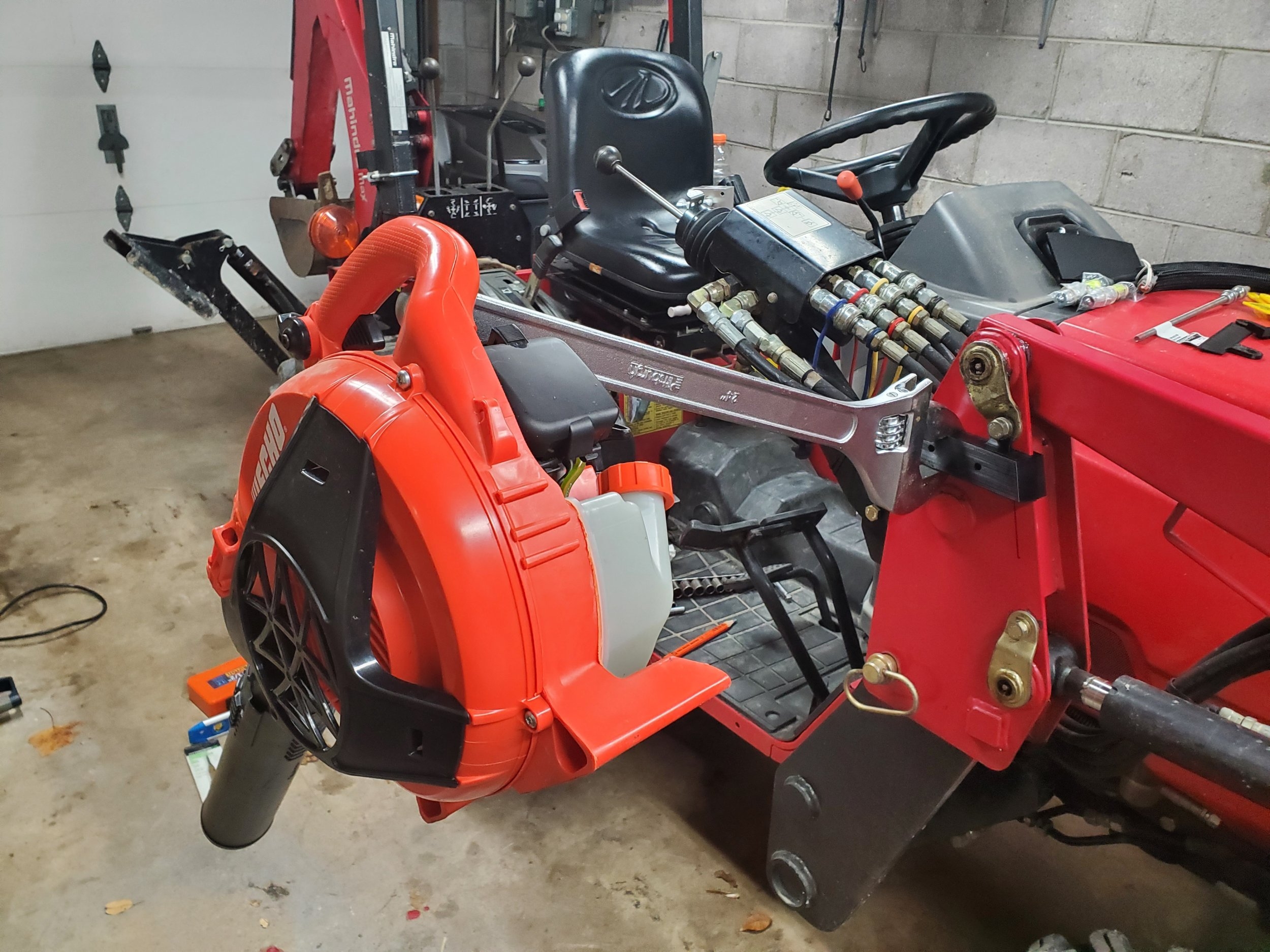

well I made a bracket.... needed to get back to designing anyway.
have to remake it, but here are some photo's and for those of you who think 3d printers are toys, I attempted to break it,( I have other parts I have tested by driving over with the tractor and barely a mark) and didn't even bend it,
Photo's are of a 2' adjustable and a PB2520 leaf blower, 0 deflection at the mount (3rd photo), its overkill but its fine.

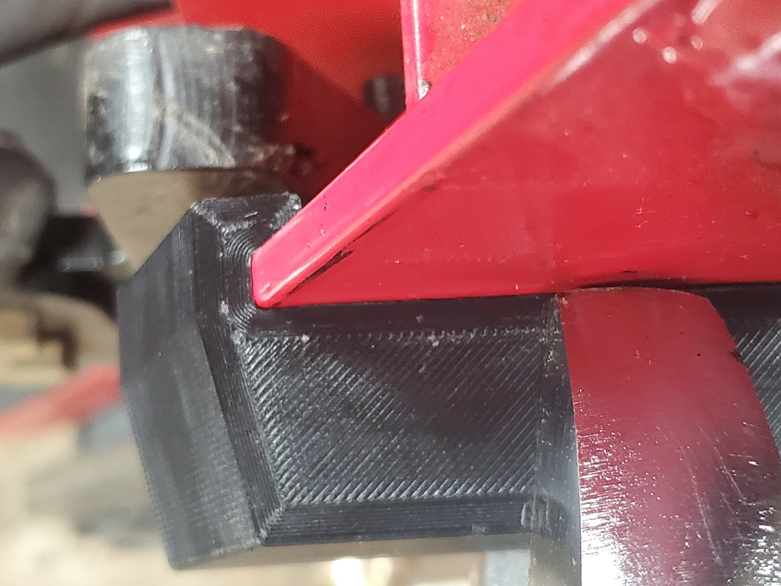

latest version is pretty much perfect, very solid, very happy

Nice job.
Projecting here, but catching a limb on that valve block might pop those plastic, inside tabs. I'd make a backup while you're at it.

yea, the hoses stick out a bit more as well, if I rip the block off, I will have bigger problems, but yes, I can just click print again if need be
