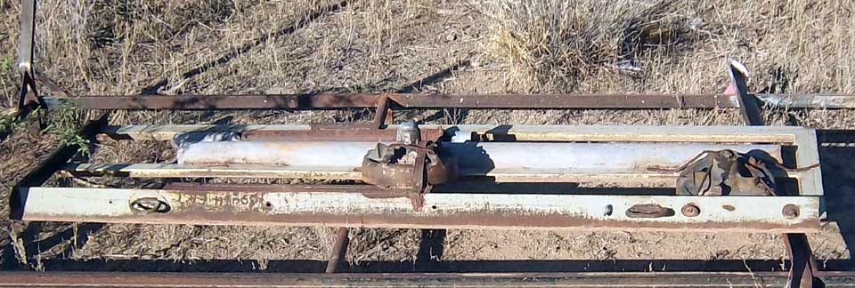

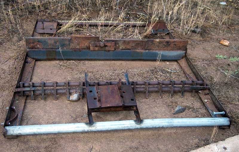

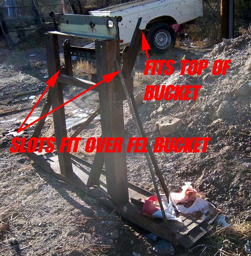

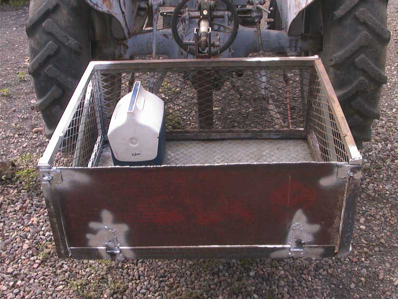

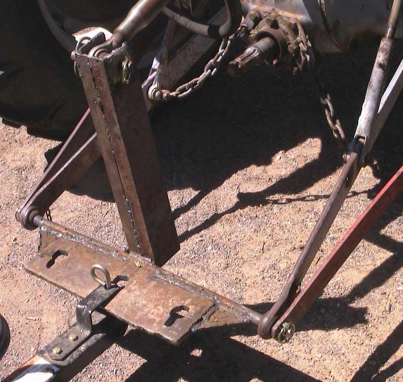

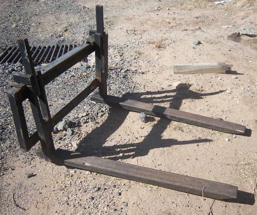

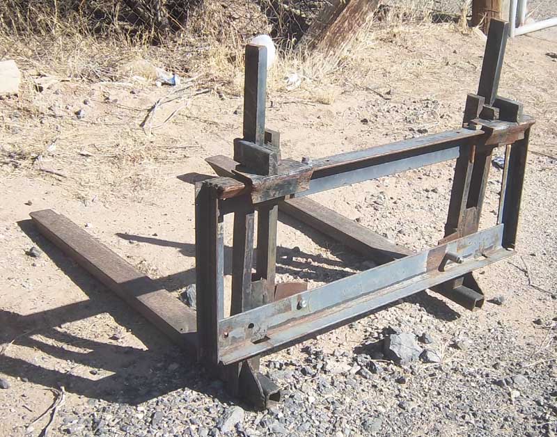

I sure do admire all you folks the build and paint some really nice things.
Most of the time when I build something, its a needed item. Or I figure that it will need more work and I'll make it pretty later.
Also most of the time whatever I build its out of whatever scrap metal that is on hand.
More Ugly later if you can stand it.

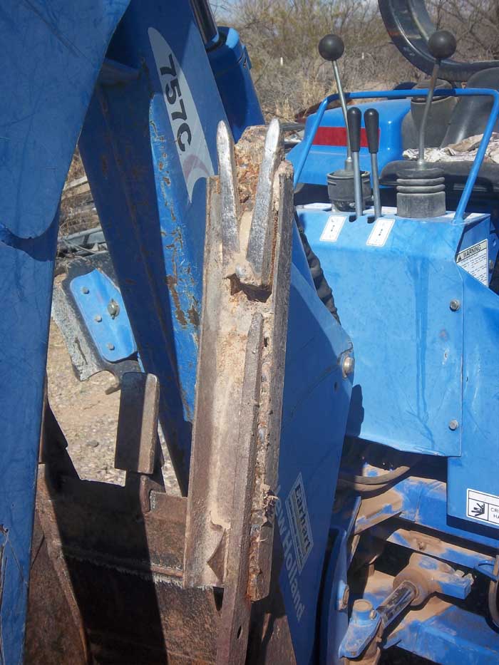

I am intrigued by your extra long tooth for your BH bucket. can you tell me a bit more about it and what do you use it for?
/ I Build "UGLY"
nothing is ugly when its useful! :thumbsup: looking good!

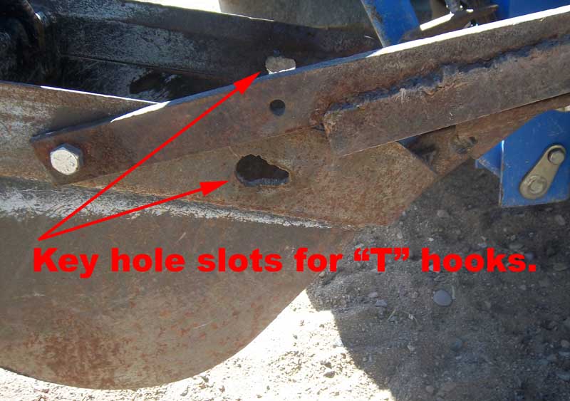

Hi
That is what I call a pickle fork digger. It's used for trenching out for water pipes, root breaking and rock pulling. Goes on with 2. 1/2" bolts in 2 or 3 minutes.
Mine is made of 3/16"X3" "C" channel, reinforced with 1/2" steel, old spring and 2 R/R spikes at the bottom. It works fine as is, but plan on a sharp edge on 1 side and an angled plate neat the top to move dirt off to 1 side. Have also cut a shovel down to 3" for cleaning out trench. It has worked well for me.

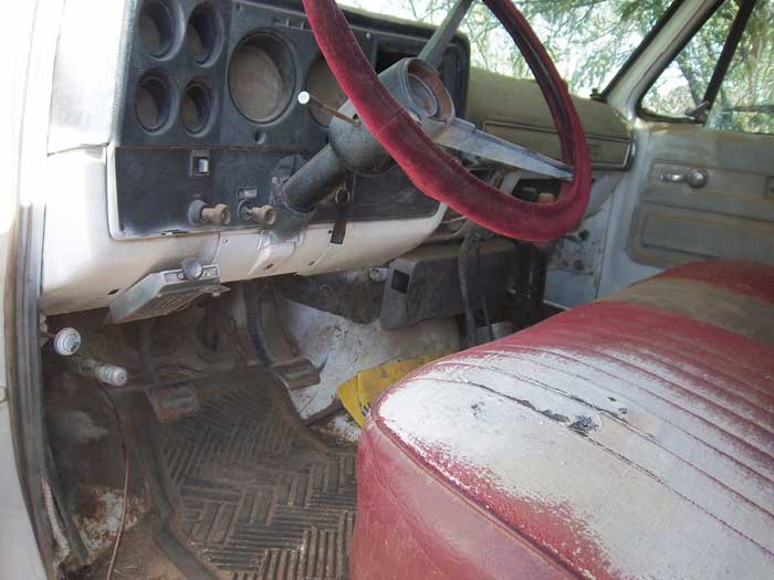

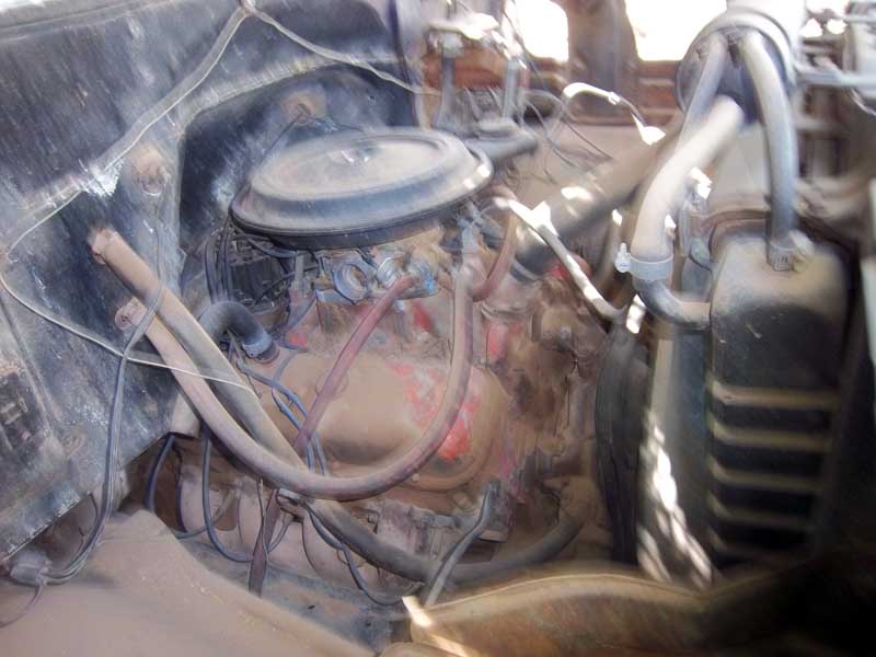

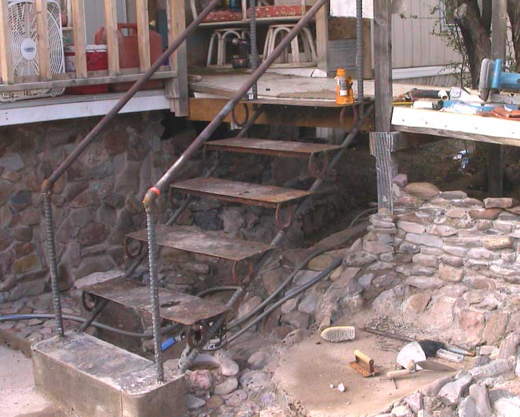

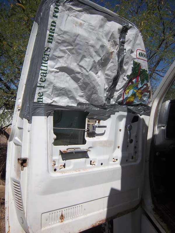

/ I Build "UGLY"
#12
Ugly is fine, but remember if you decide to build a dump trailer, I already have the "Ugly dump trailer" name copyrighted...
David from jax
David why did you do that. Maybe for a small fee I can use your copyrighted name. :laughing:
If all else fails, apply the bar rule, drink 'till she' s cute !! :thumbsup::thumbsup::thumbsup:
You may have noticed in some of my pictures, there is a grocery bag. Way cheaper than paint. :laughing::thumbsup:

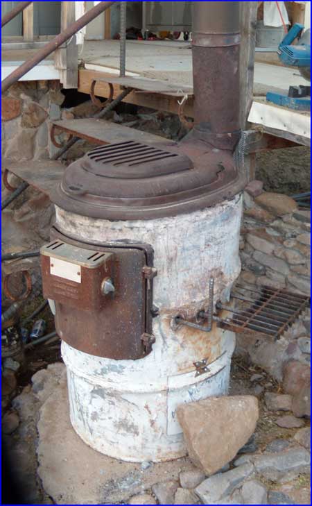

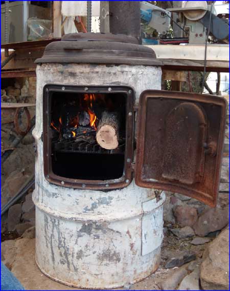

/ I Build "UGLY"
#19

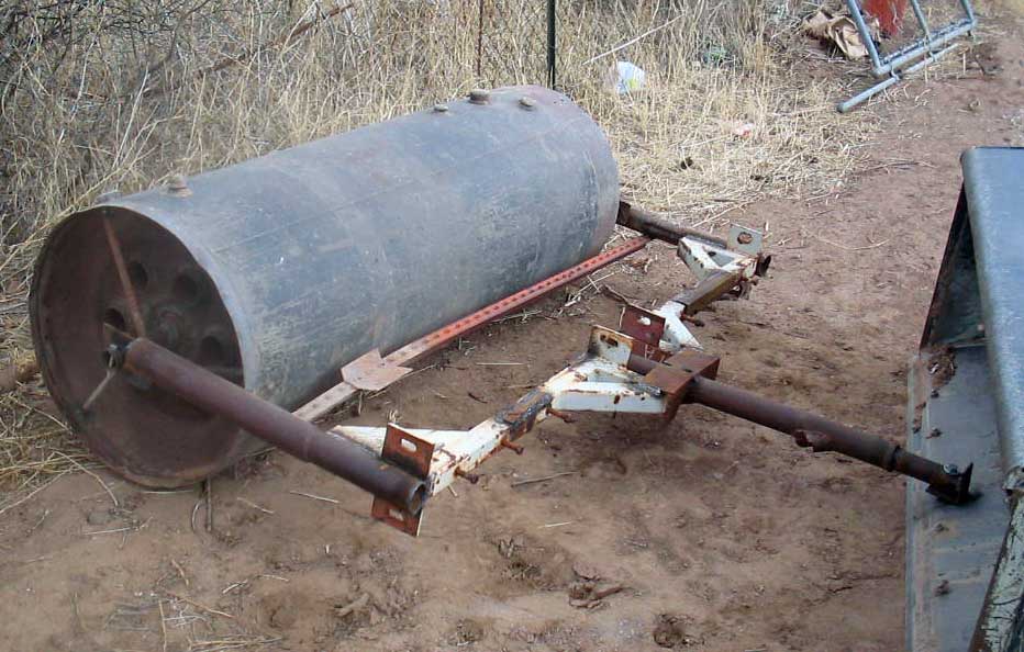

The roller - is it an old water heater?
The roller pictured was made from an old steam generator. I made one for a neighbor to pull with his lawn tractor and it was made from a 20 gal. hot water tank. Also made him a little drag for the tractor.
