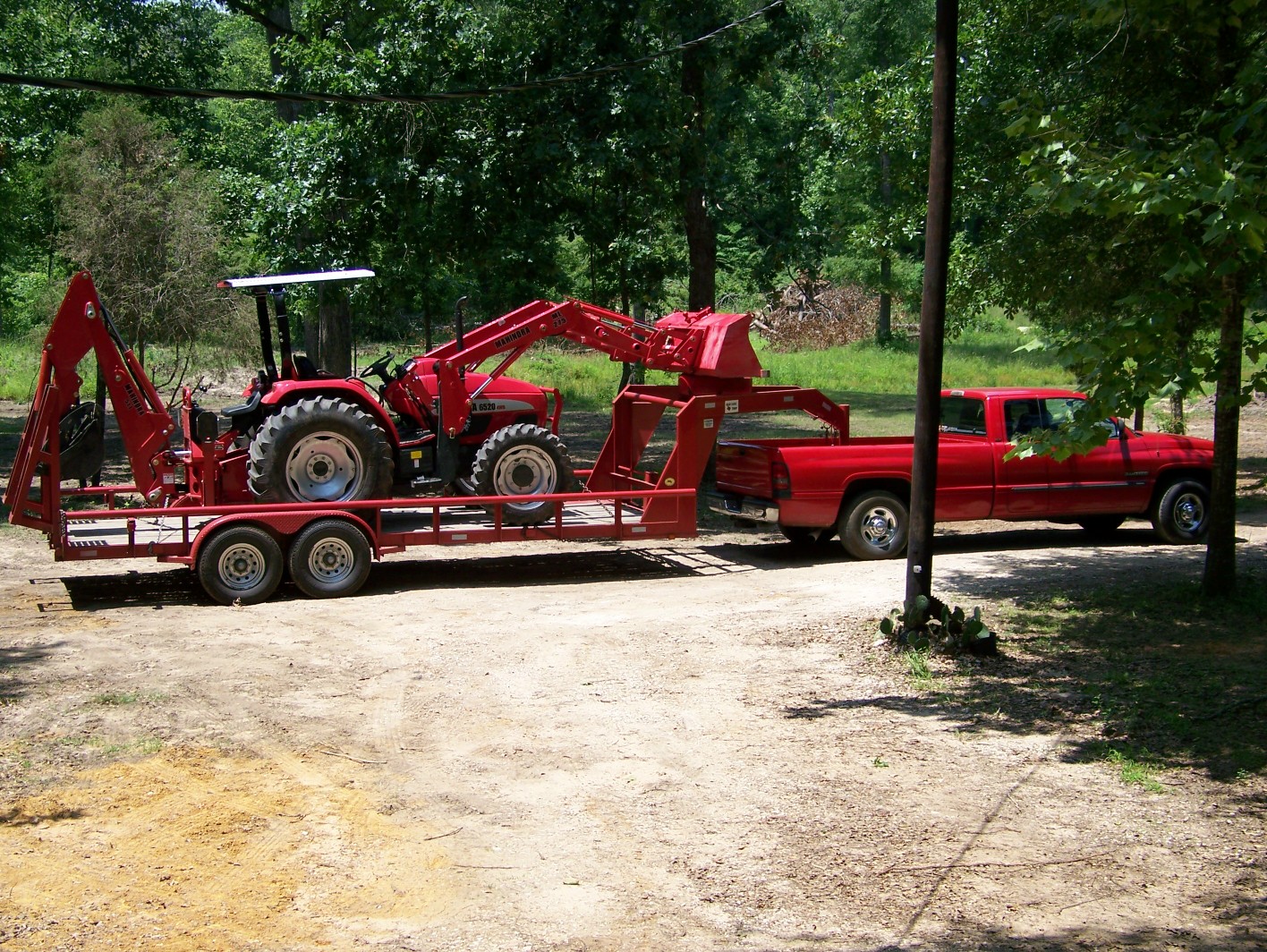

I love my R1s. I know they have gotten me out of slimy clay before and I really think R4s would have left me lifting the tractor out with the backhoe and loader. My trailer fenders are still attached. It is the inner skin that is tack welded to the inside lip of the fenders and the trailer frame that is loose on the back end, where the tractor's rears ride.
I want to keep this trailer for farm (has farm tags) use and get a 25 foot dual tandem for commercial work. That way I won't have to put the loader bucket up on the gooseneck. The photo below shows this. My 2002 Ram 2500 with Cummins pulled it okay, but now I have a 2003 one ton dually that makes me legal in the weight area. The 2002 was only rated to pull 9800 pounds. The tractor and trailer weighs 11,700 pounds.
Happy trailer hunting!
Oh yeah.......R4s on front and R1s on back will screw with your traction/slippage .vs gear geometry in 4WD and bind your drivetrain. Which is bad jeu-jeu and tends to void your warranty.
