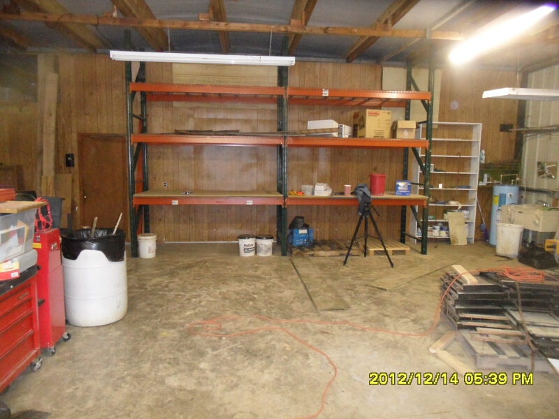

Seven sections of Pallet racking for $70, two shown here:
attachment.php

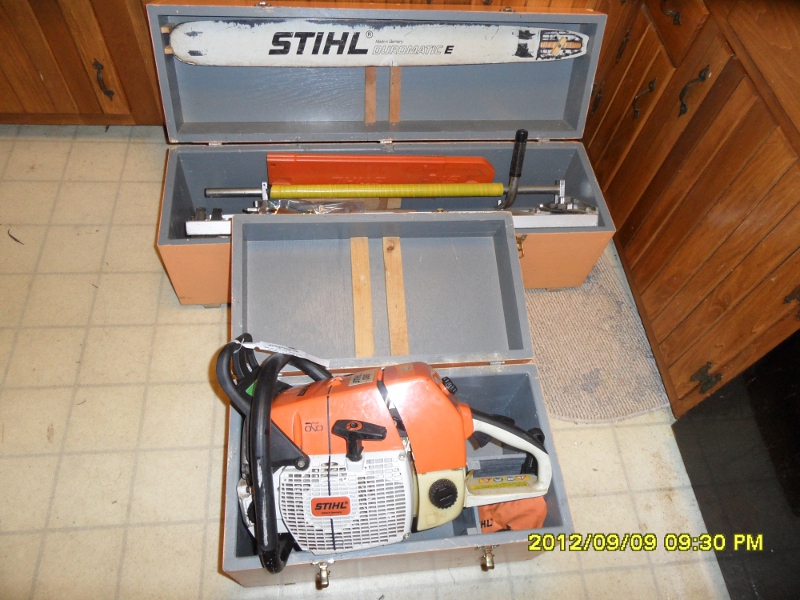

A 120CC 088 Stihl, w. bar, chain, and an Alaskan Mark III Chainsaw mill WITH cases for $450.
attachment.php
