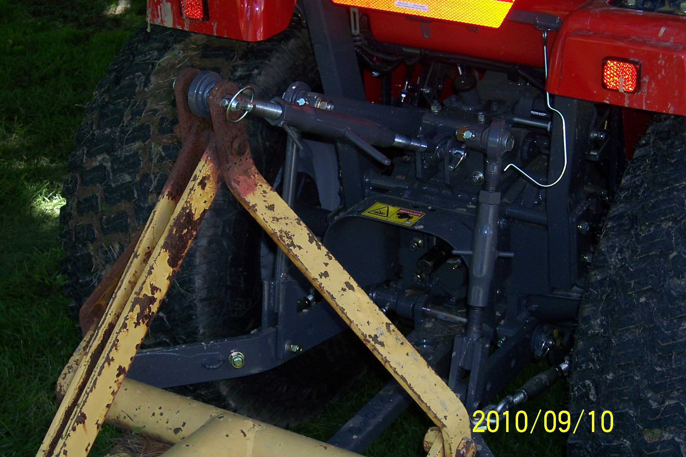

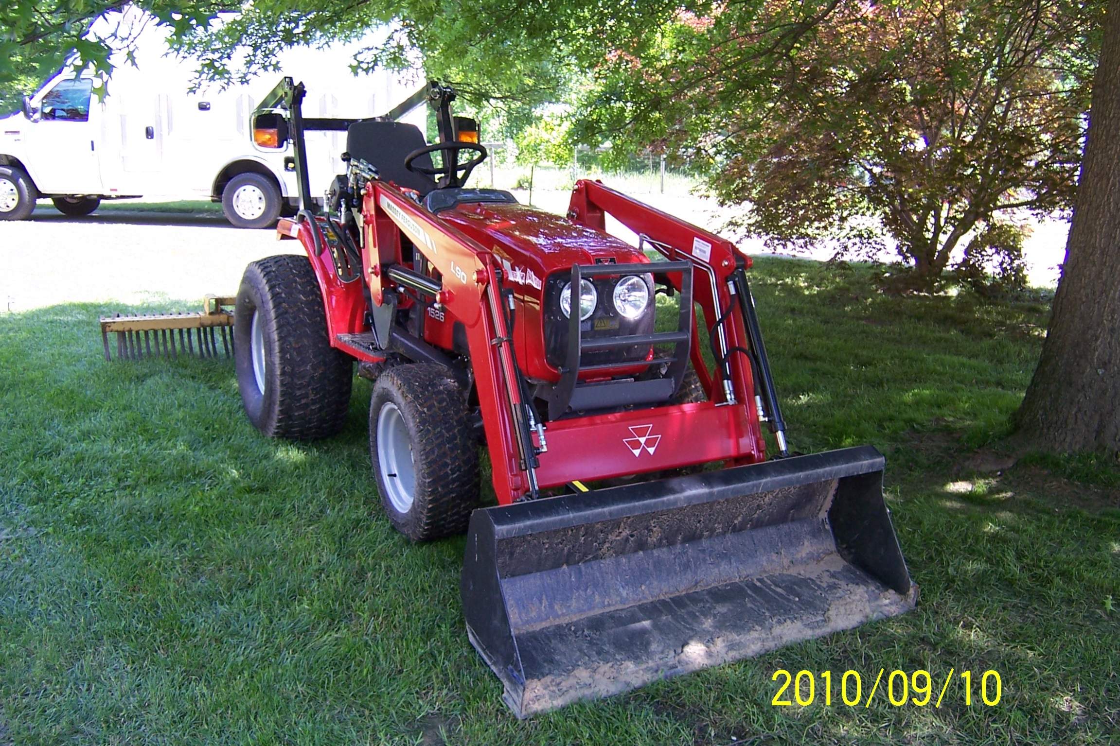

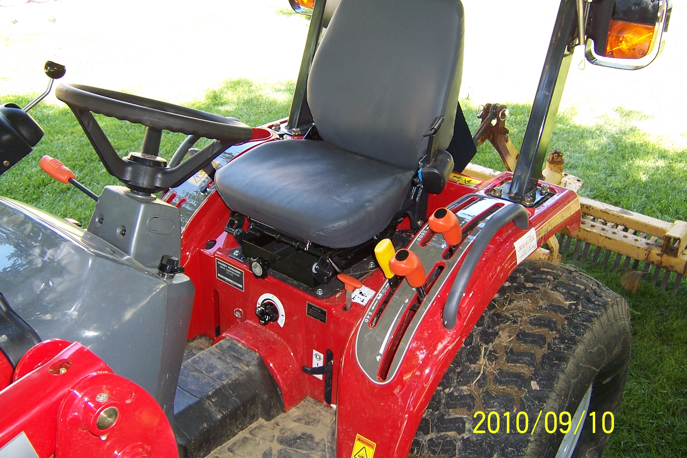

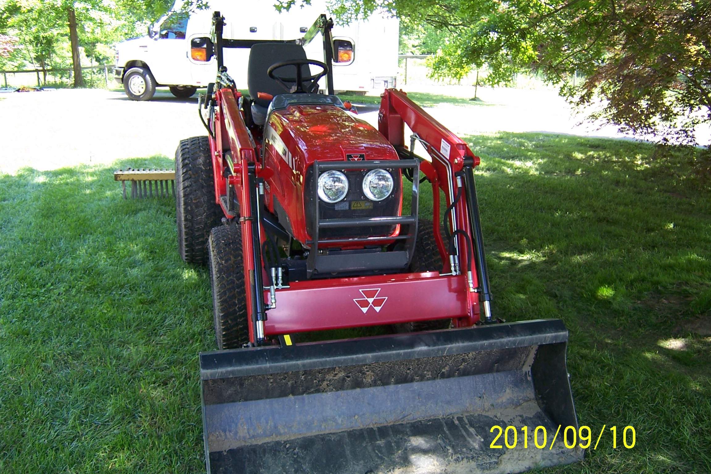

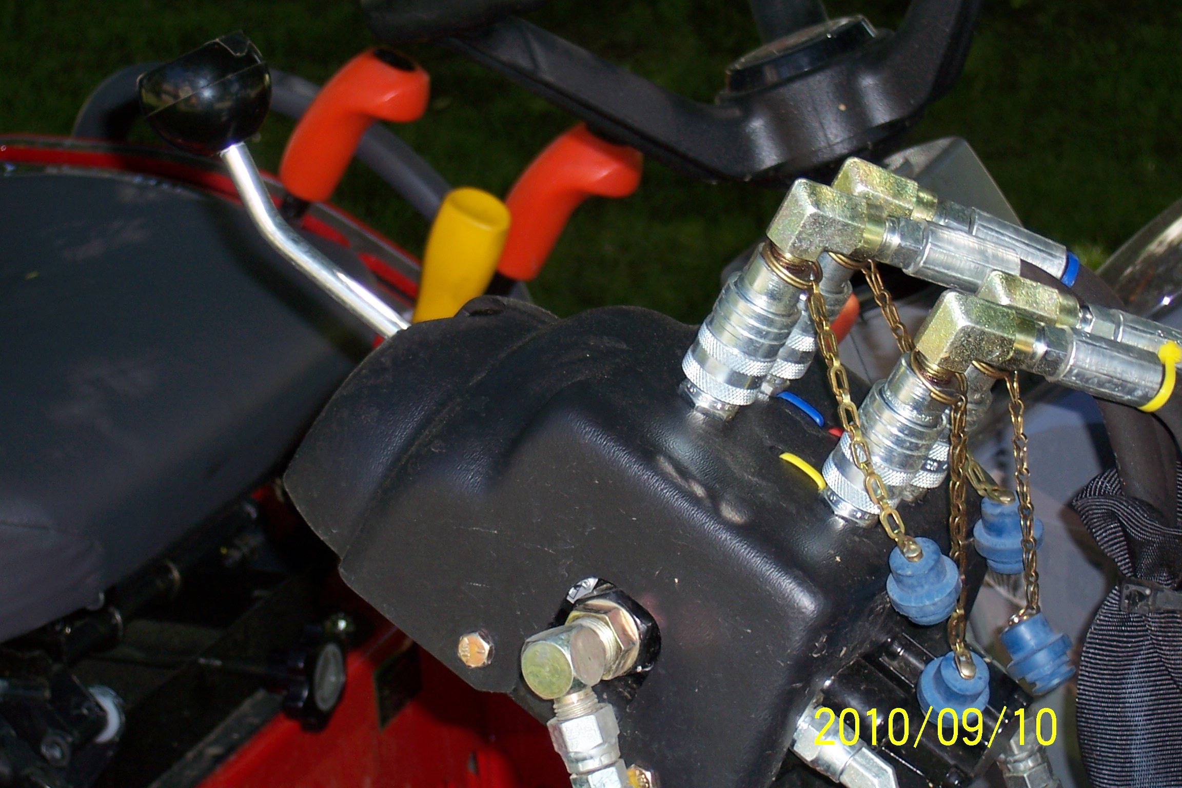

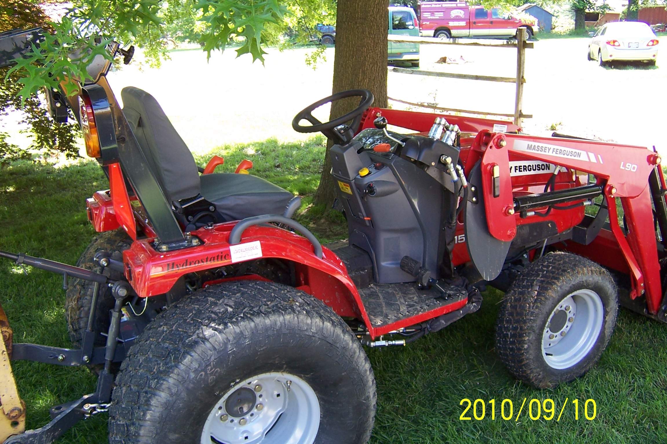

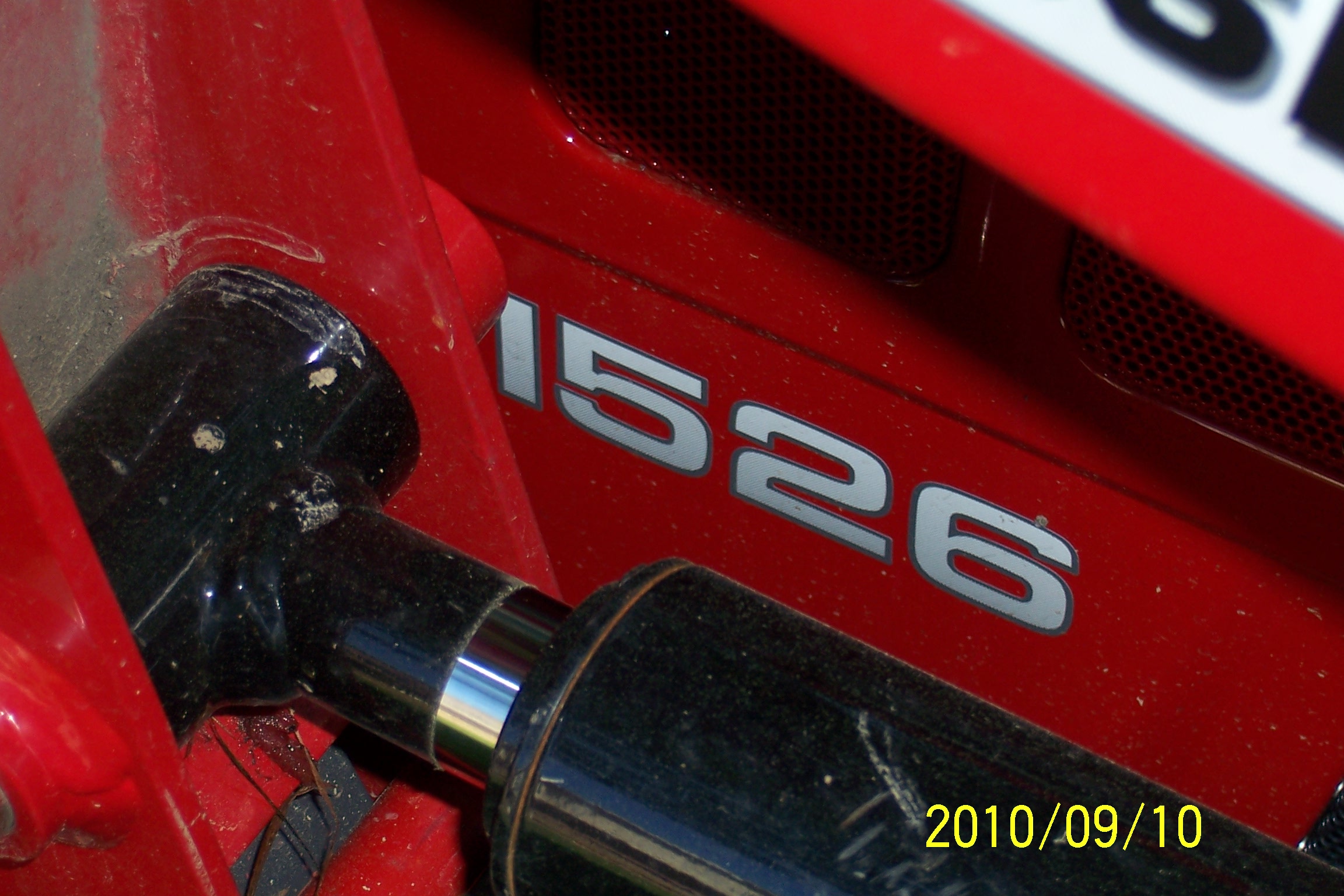

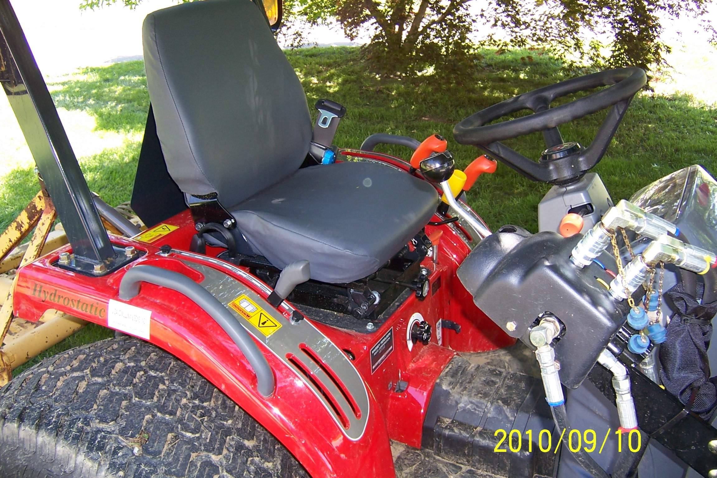

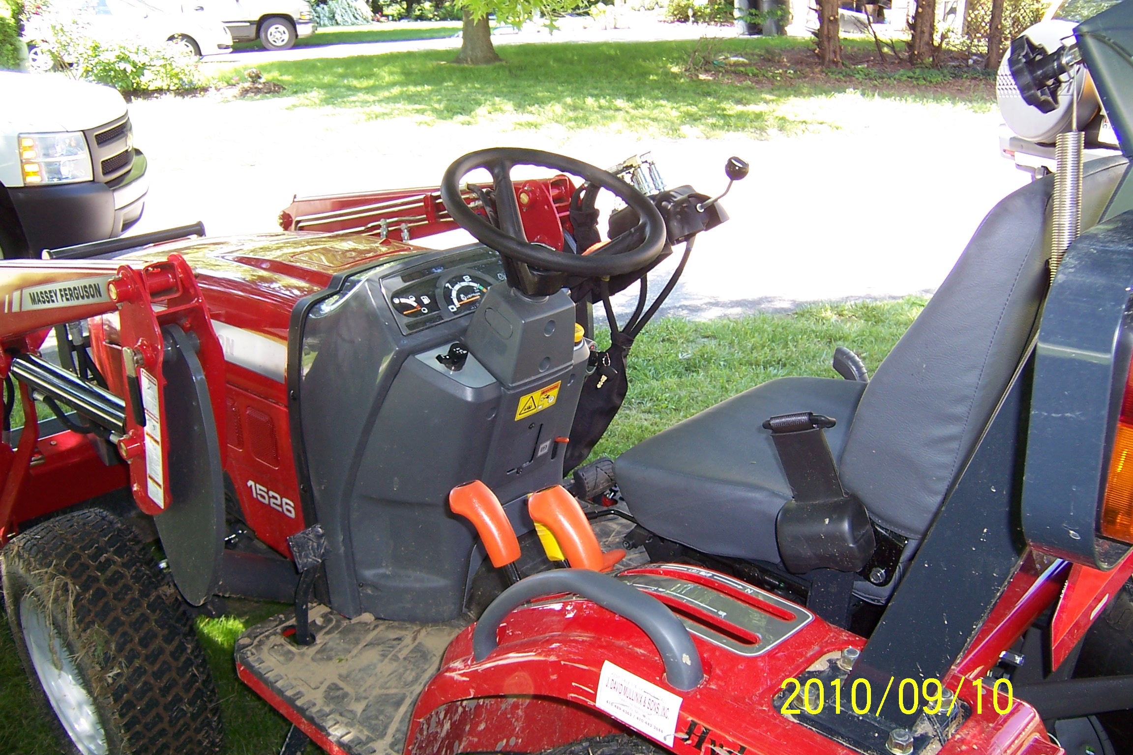

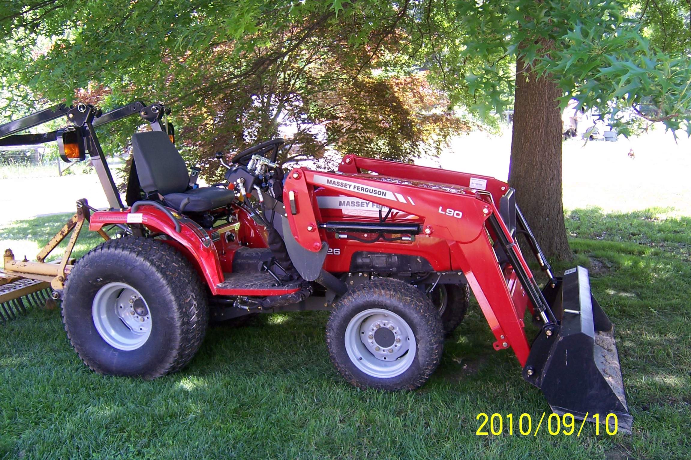

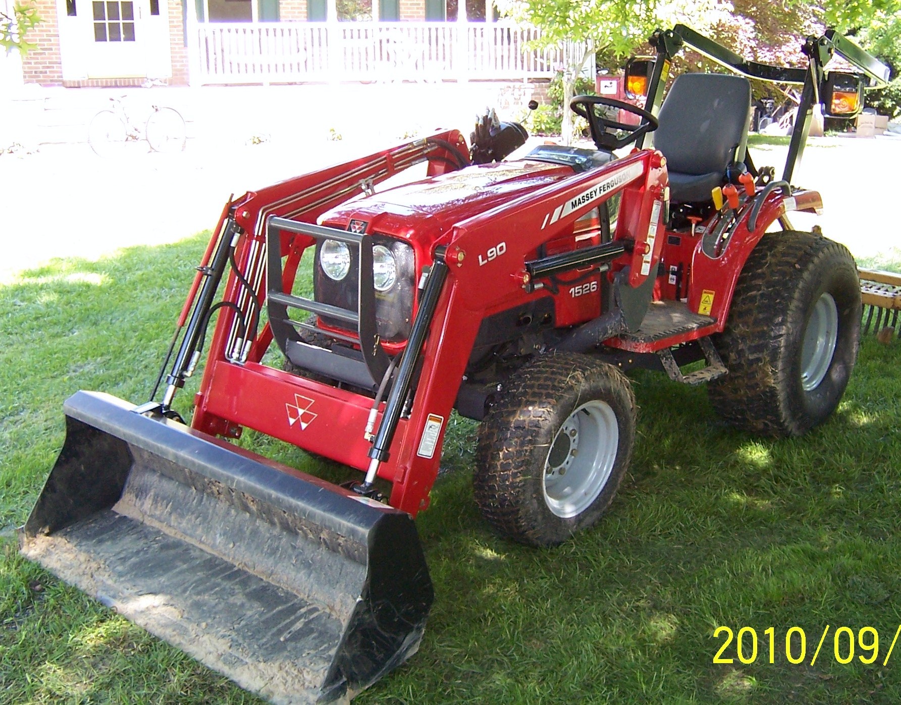

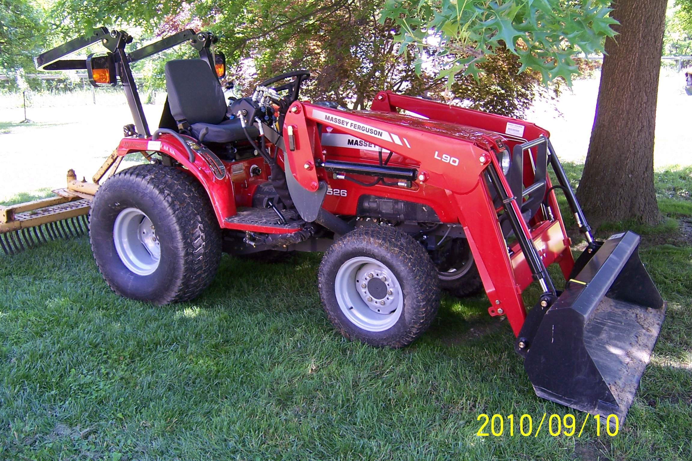

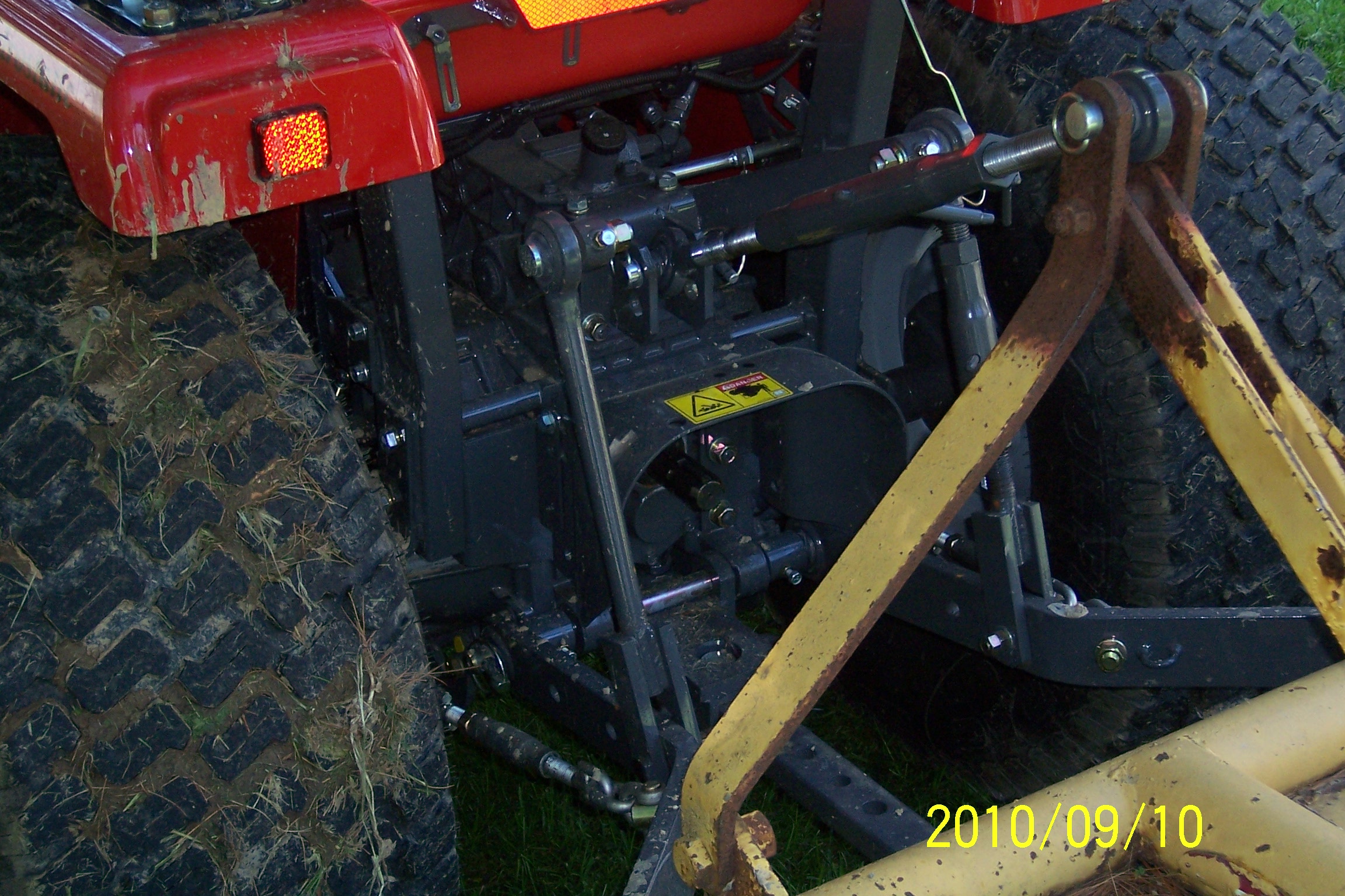

Thanks for the info guys I have pictures of the Massey and it is quite a bit larger then the Kubota. It lifts the bucket to 90.5 inches thats 16.5 inches more then the B2320. The bucket can be had in either 54" or 60" QR style. It's a nice unit but I'm concerned about working in tight spaces. Looks like one heck of a tractor though. Here's some pictures. I was told that the OTD price is $13.900 not $13.800 I just don't know if I can afford the extra $100, LOL. Neil did say the price on the Bota would be $13.800 because it's been awhile since we first spoke but thats understandable, I had to wait due to the housing market to sell my mothers house after she passed and that took over a year.
Scaper

Thanks for the great pictures! Those are the first decent pictures of the 1526 I have seen. That is a really nice looking machine, especially for the price. I like the location of the quick disconnects for the loader valve. Very easy to get at.
I understand about not having room for too large a machine. I'm in the same boat. I'd love to have a bigger machine, but I would not be able to do as many tasks as with my little GC.
