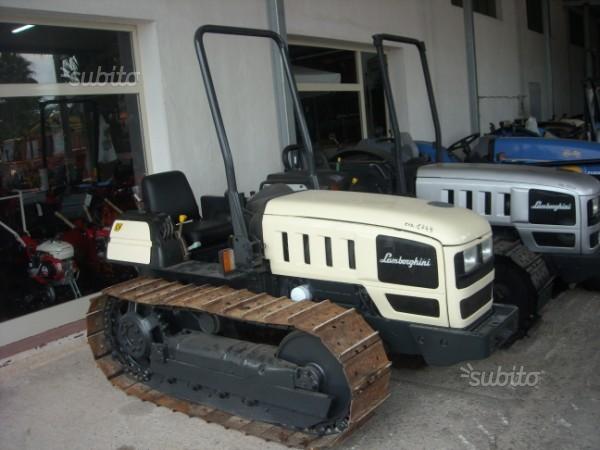

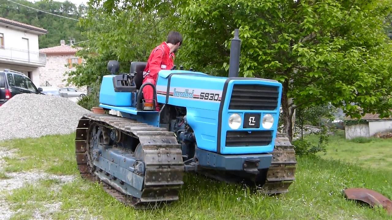

I guess you guys don't get these of there, but something along these lines would be my choice:
Also available with loader:

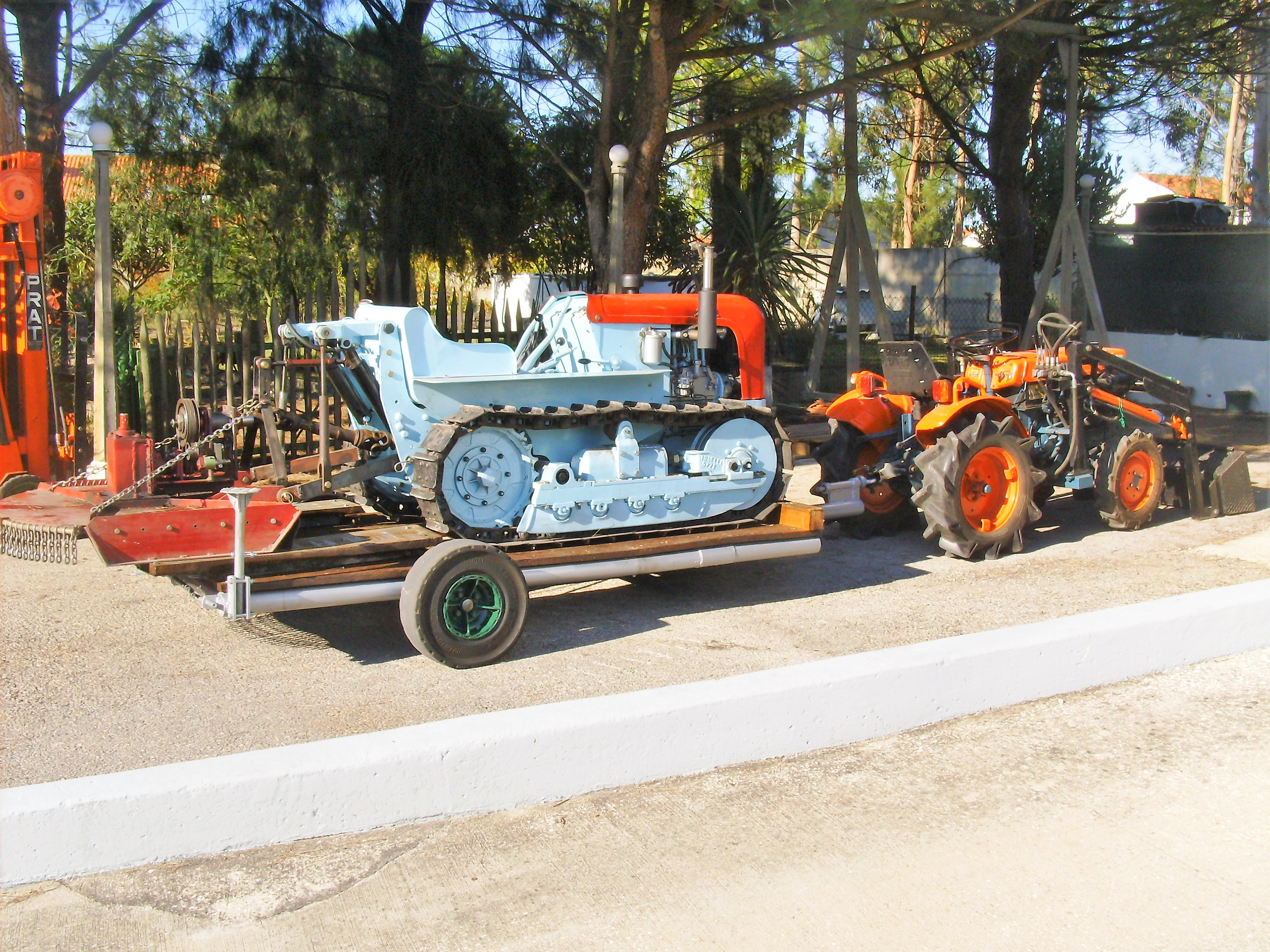

You mentioned you have to road the tractor between properties. That could easily be fixed with a low bed trailer that would hook to one of your wheeled tractors. I used to do that when I had a crawler tractor.
Anyway, since this is probably not viable, try and take a look at Antonio Carraro tractors. I know they are available there and they are made for hills. Low profile and stable.
