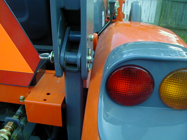

Picture of left side. This is the one giving me problems.

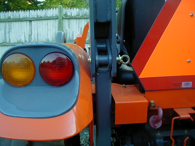

   / I am having a problem with my ROPS
Here is approximately the same view of the right side.
#9
Here again is the left side straight on. You can see the tolerance is very close. As you lower the ROPS the left side comes into contact with the fender about 50 percent of the way down.
Yes, I do have the older style. It looks to me like the vertical members of the frame that the ROPS are assembled to are not parallel.
