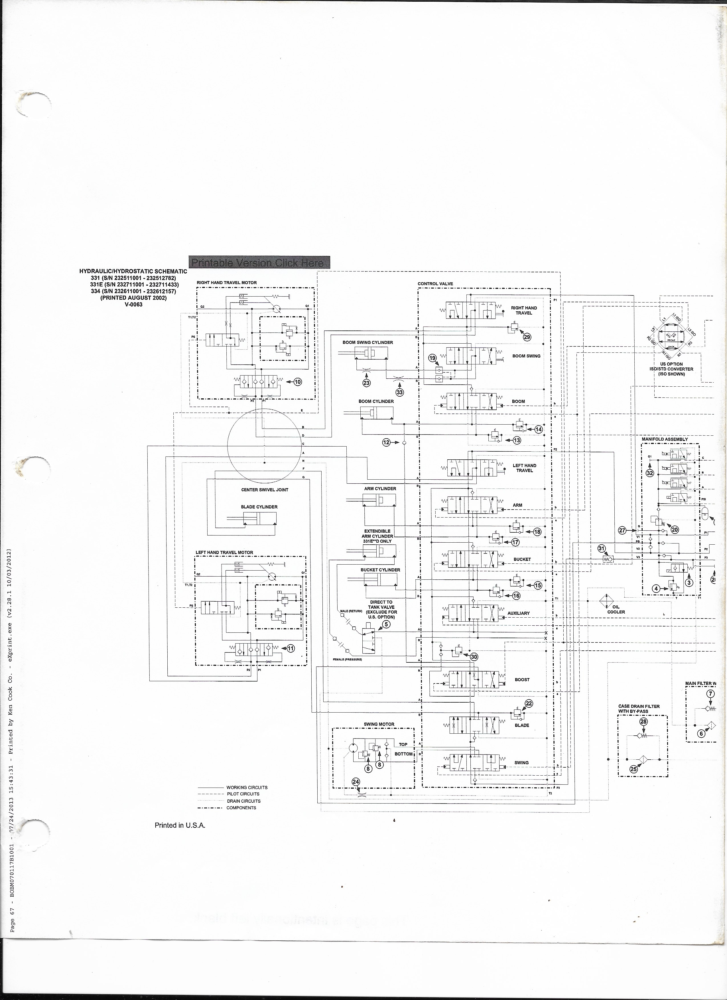

I'm an old man, ain't very computer savy but here goes
/ hydro problem
#12
let me know if you get this and if it helps
/ hydro problem #13
Crazy
I totally understand not being computer savvy since have the same problems. Schematic doesn’t show the pumps so not sure Which line P2 or P3 is the circuit you opened to check for flow? Both of these are unloaded to tank via valve 3.

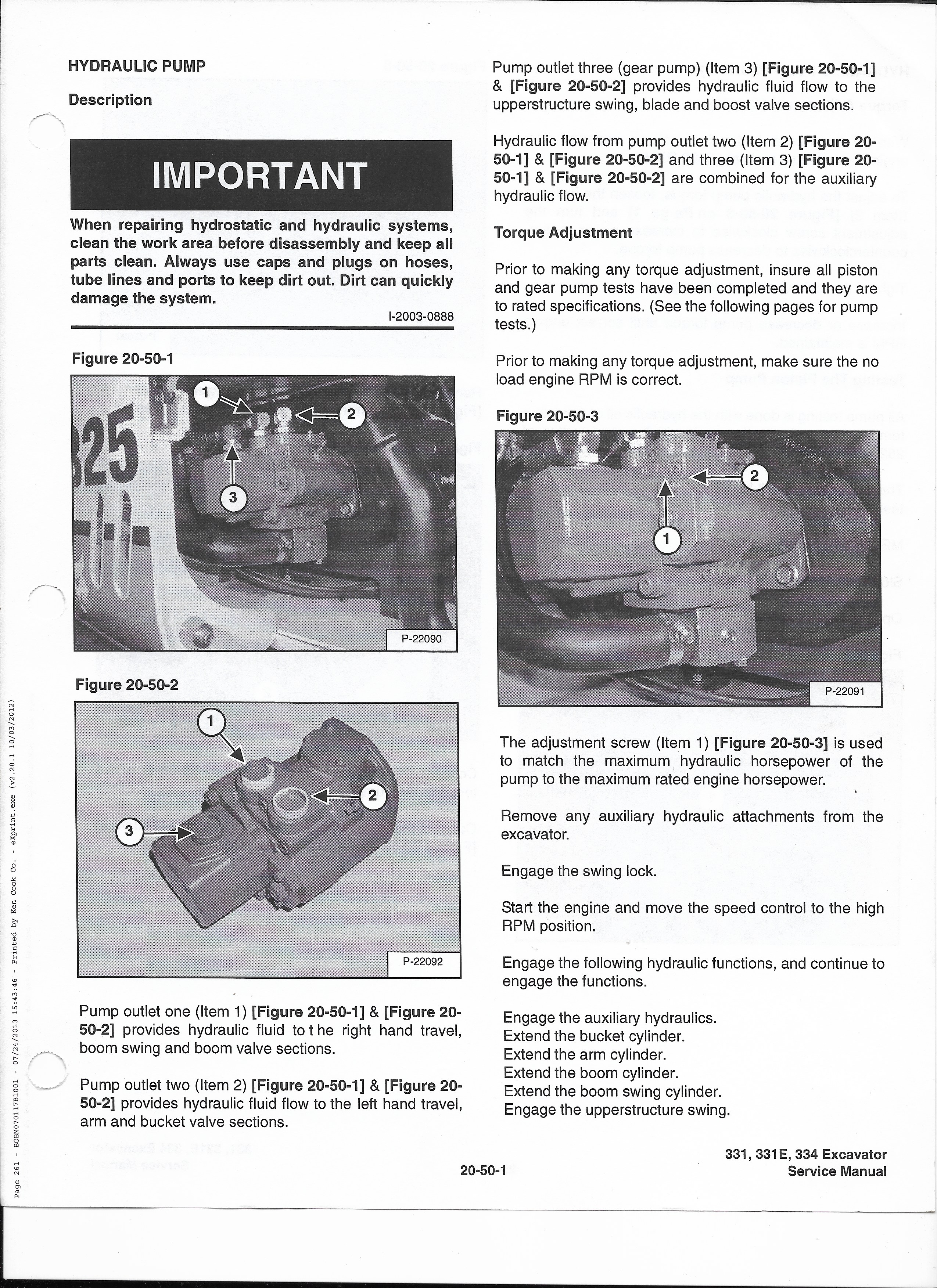

didn't replace any joystick hoses,but heres food for thought. here is my pump, outlet one- I have right hand travel, boom works, pump outlet two- I have left hand travel, arm and bucket work, pump outlet three no swing or blade. then it says pump outlet two and three are combined for auxilary hydro flow. Is auxilary meaning the thumb? if so doesn't that verify my hoses are corect

/ hydro problem #15
Per the schematic P3 supplies swing, blade & boost. Then the P3 power beyond combines with P2 downstream of left travel. This then feeds auxiliary, bucket and arm. This allows you to travel and move bucket or arm simultaneously or swing and bucket or boom.
I agree the pump connections appear to be correct.
If you disconnect the hose on P3 and no oil comes out when engine is turned over certainly would point towards the gear pump not turning. Does your manual show a parts breakdown on that pump assembly? Curious what type of drive coupling is between pumps 2 and 3.

/ hydro problem #17
Well if you have flow that answers the pump question
Next is why those functions quit. Are they all on the same joystick? Do any of the junctions on that joystick work? Reason for asking is valves are hydraulic pilot controlled by joystick. Just wondering if you possibly lost pilot pressure to that joystick. There is a manifold assembly with ports A, B, and C controlled by 3 individual solenoid valves. I am 99% certain they are pilot pressure lines that feed the joystick but the joysticks are not shown on the schematic you attached. If one of those valves is not shifting it would prevent pilot flow from getting to that part of the circuit.
Just tossing out ideas on what might cause the problem you are experiencing.
