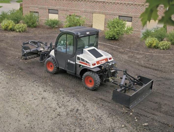

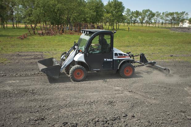

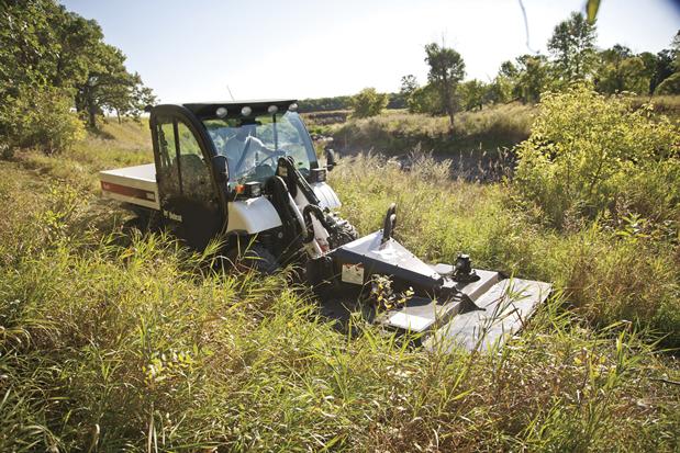

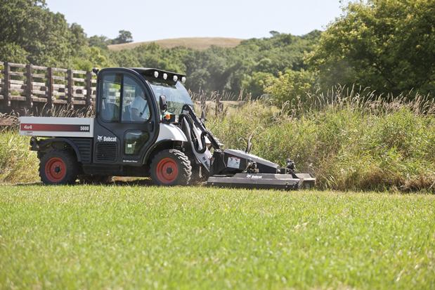

Here is what I would prefer for the OP's use: Toolcat Utility Work Machines - Bobcat Company
HST, 4WD, 4Wheel Steer and 2 speeds.
Model 5610 has 3 point and PTO:
Model 5600 dump bed:
And the Toolcat Forum here on TBN: https://www.tractorbynet.com/forums/toolcat/
