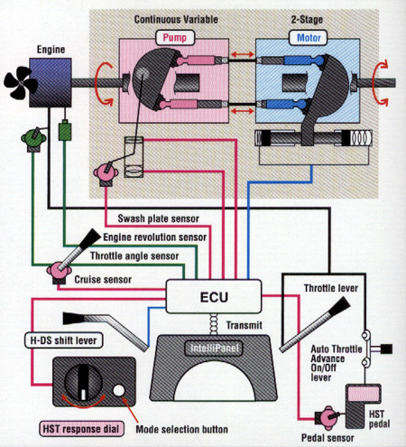

HST Plus uses a two stage hydro drive motor, not a gear set. Rather than a fixed swashplate angle as found in many hydrostatic motor rotating groups the motor has two selectable swash plate angles. The pump retains infinite swashplate angle capability within the operating range.
The range selector still offers three gear selections. HST plus does not use synchronizers. The hardware is very similar to that used in skid steers and older New Holland Class III tractors but with a computer control layer.

Rick actually got it spot on and he does know what he is talking about.
Now, two speed rear axle? On tractor? That would be a first for me.
Anyway, here is a like scheme of the HST Plus.

Not so; you are making the same mistake by making an assumption without all the facts. We all know how most transmissions work - whether HST or other type.
I urge you to take a look at an exploded diagram of the HST+ rear end gearing.
I admit that Kubota chose an unusual way to do this in the tractor world, but if you want to make the posted illustration complete, it needs to show how HST + works - that is, you need to show on on your illustration how the high/low gearing is accomplished....not just a switch, but show what that switch actually does.
rScotty
*Remember, the HST + gives us high or low in each of the three ranges both in Forward and Reverse.

HST Plus TRANSMISSION BASICS
To understand the HST Plus transmission, all one needs to understand is that it is like any HST transmission consisting of a variable displacement oil pump that supplies oil flow to a drive motor. Part of the “Plus” of the HST Plus transmission it that it uses a 2 stage (High/Low) drive motor – a Kubota exclusive feature and is controlled by a electronic control unit (ECU).
