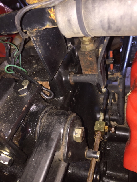

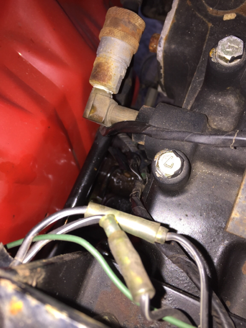

This thread has progressed rapidly today. Not for sure what I am looking at in your earlier pictures but want to think those quick connects are coming off a diverter block on your three point. If so I suspect you have deadheaded your pump. Was everything working before taking those quick connects apart?

And diverter block is that where the two valves are under the seat? Sorry my first tractor and hydros
/ Hydro help #49
The diverter block is what you pictured in post #9. The lines with the quick disconnects are coming out of it.
Before disconnecting the quick disconnects to your snowblower the fluid traveled out of the diverter block and through the snowblower system and back into the 3 point at the diverter block. That is the circuit. When you unplugged the quick connects the pump or fluid was dead headed. One solution is to fab up a loop hose with a quick disconnect on each end to match the ones on the diverter block . Plug the hose on and the fluid can complete the circuit.

Here's my (previous) YM186D with a return hose connecting Out to In on its diverter block. The hose replaces a loader or something that is no longer on the tractor. You can't pump fluid against a closed quick-connect, it has to go somewhere and this return hose is the best solution.

Are these custom made? Or can I just buy one ?
Yes. :D
Get the numbers off of the connectors to be sure to get the correct type.
For a quick fix, remove the shortest hose from the plow, take the connector of the other hose and make your loop.
Do not use Teflon tape on the threads, get some paste thread sealant.
