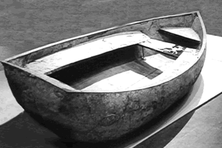

I noticed that your avatar is a sailboat, but did you know that a ferro cement sailboat was built, and is operational. Here are some pictures of the hull with a steel grid frame, the finished cement hull, and the fitted out sailboat.

Yes I know there are concrete hulls for sailboats. I have seen a few and even had drinks aboard one of them. I don't know about America, but in Europe they are no longer in fashion.
