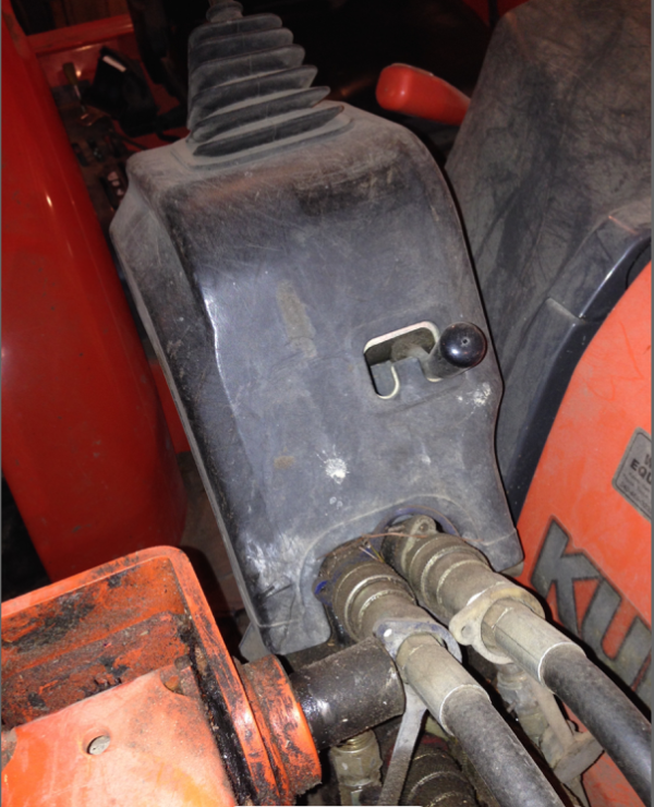

Reviving an old thread here...
I see the last person posted on this thread is Brian, who has given me a quote for rear remote and top&side link hydraulics. Before I jump into this task, I'm trying to learn more about hydraulics (as well as the tractor I got with my property 3 years ago).
When I got the property I had never operated a tractor. I jumped in the seat and figured out everything on my own (and with the help of YouTube and forums). Well, I thought I had figured everything out. What is this lever on the front side of the FEL joy stick?

Should be to lock out the loader joystick.
