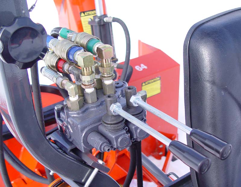

I have a BX2200 with a 3 way loader valve on the FEL. In the winter I take the valve off the FEL and mount it on the tractor to use it for the snowblower quick hitch to raise and lower the blower. To take it off the FEL and add the valve in the spring and fall is a pain in the back not to mention other places. I have looked at valves on Northern Tool web site, see some examples below, and you have many choices. Here is where I need your help. What kind of valve do I need to raise and lower the hydraulic cylinder on the quick hitch? I figure a valve dedicated to use on the snowblower will make life and my back a lot easier. Some hoses, quick connects and a mounting bracket and I am go to go. If you have places on the web to buy that are better then Northern Tool let me know. Thanks for your help.

I know that we're not talking about the same setup, but last October I asked my dealer for a dual valve for my rear blower and he got me this (pic).
I really don't know all the specifications of the valve but he provided me with exactly the right thing.

Assuming you have ruled out a setup with a diverter, NONE of your choices are very good and I would not even consider any of them. Log splitter valves will not work at all and those 20 and 25 gpm valves are monsters size wise.
The implement flow on your BX is less than 5 gpm so any of the larger valves should be rejected.
I would go with an Eaton-Cessna 30920 valve. They come in 1, 2 and 3 spool configurations with a rather small footprint. They are rated at 5 gpm which is more than enough for a BX and they have an adjustable relief set at 2000 psi with a max of 2500 psi. Part numbers are 9-4500, 9-4501, and 9-4503 with the PB sleeve being 9-4504-B.
Surplus Center has these vavles on page 21 of their 2005 catalog. You will have to order a power beyond sleeve. They are perfect for any BX or B series Kubota less than or equal to a B2410. Tim (8561) has a 3-spool unit on his B2410 and he tells me it works just fine. If you want a real life honest opinion just PM Tim (8561) and tell him I sent you.

The valve in your picture is the valve offered for sale by Kubota. It is over priced, in my opinion, and there are other valves that will do the job for a lot less money. See my previous post.

The MadRef is correct, I do have the three spool E/C valve on my 2410. He was a tremendous help in selecting and setting up my valve installation. It works very well on my 2410, and has a very small footprint which I found very helpful. Last winter it ran my hydraulic top link as well as the hydraulic teurn and hydraulic chute deflector on my snowblower. Yesterday I ordered the hydraulic side link from CCM. Yankees Fan - PM me if I can provide any specific help on this valve or set-up. I'll try to look past your Yankees allegiance and provide the best answers I can. /forums/images/graemlins/grin.gif
