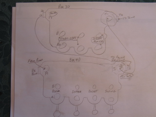

I recently resumed work on the Mini Backhoe I began building nearly ten years ago😒. To quote what has been said on these pages a number of times, "Life got in the way" and I had to set it aside for a while. Now that I have the time, I'm back at it and the hydraulic aspect of it is what's on the agenda. My knowledge of the rules and precautions related to getting this right without risk to life and limb is elementary at best so I'm here for the wise counsel I'm confident is available on this forum.
I have drawn up a crude diagram of two sets of spool valves, one is a BM40 - four spool and the other a BM30 - three spool. The BM40 will be the first after the pump followed by the BM30 via power beyond. I'll try attaching the diagram and my apologies in advance for the poor quality of the drawing and photography!! Please advise if I am making mistakes.

I'll try my best to explain the drawing: The hydraulic fluid is sent from the pump to P1of the BM40 and P2 has a plug. From there the A and B ports are plumbed to the indicated cylinders. At T1 the fluid return is plumbed to the T1 port of the BM30. T2 has a Power Beyond adaptor installed and is plumbed to P1 of the BM30. T2 of the BM30 is plumbed as the tank return and in "theory" will also carry The return fluid of the BM40.
If anyone sees issues here, please advise because as I said earlier, I'm not well educated where hydraulic protocols are concerned. I am preparing to acquire the hoses for the various hookups so I need to know if I'm getting it right.:cautious:

I was checking some info on that valve to get a little bit familiar with it. I have similar valves on my homemade backhoe.
So I think you have it figured out. You're kinda saving some hoses and a T fitting by using both T ports of the BM30 as a T fitting.

Thanks ptsg, I was hoping I could get this right. The BM30 and BM 40 are manufactured in Italy so they could be more common in your market than here. I'm a S&PC (scrounger and proud cheapskate) so saving on hoses and fittings works for me!!;)

I would simply use a T at your 3 spool valve, with sufficient size hose to reduce back pressure. If I am reading your schematic correctly, you are using the valve as a T. IMO, that will create some back pressure on your primary valve (4 spool).

I wondered about that too but I'll try it first and if that is a problem I can make that change without much hassle because that area is easily accessible. Thanks for the heads-up.

Do you have written plans for the machine? I see you have a spool for a blade. Will the unit stand alone and be self-propelled?
Since you ask about the hydraulic valves, I do not see any particular issues, but you may consider a flow divider if you are set on using 2 different valve banks that are on the same pump circuit. Usually a single valve stack is used, with as many as 8 spools. A flow divider will make it easier to operate 2 valves at once.
/ Hydraulics 101 for my Mini Backhoe Build #10
He has the secondary functions on the 2nd valve (3 spool), primary functions on his primary 4 spool valve. A flow divider would just rob from his primary functions.

I must apologize for not providing more information. This backhoe build is documented on the Build it yourself forum here: It's time; either get started or.....
But to answer the question, the backhoe is built on the back of a Craftsman/Sears GT18 garden tractor. so it is self propelled. The dozer blade is adapted from an attachment from another similar garden tractor and serves where a FEL would otherwise be needed. The BM30 bank of valves is only in operation during set up and set down. In addition, the dozer will be useful for refill after digging is done. Thanks Rich and ptsg for your helpful comments. I appreciate and give serious consideration to all the advice I have received on this thread as well as on the above mentioned thread. It has been immensely useful, let me assure you. Cheers!
I am having a problem that I originally suspected to be a worn out pump scavenged from an old bale loader/stacker. Thinking it over and remembering this comment about possible backpressure and the issue I am having with the movement of the boom as well as the dipper and bucket to a lesser degree, I will investigate this possibility further before changing out the pump. Thanks in advance, especially if this proves to be what is happening here😌. Cheers, NormL

I have isolated the difficulties I'm having with the hydraulics and it is that the pump is delivering a much higher GPM than I need and when I try to dig, the engine stalls. It's an 18 HP Briggs and Stratton and it should be more than enough engine for the task. I picked up a flow control valve much like the one you suggested but by the time I add in the hose and fittings I'll need for it, I can almost buy a new pump that matches the job. Does "pressure compensated" mean that the pump will continue to deliver the same pressure to the cylinders while dumping excess volume of fluid back to the tank?
