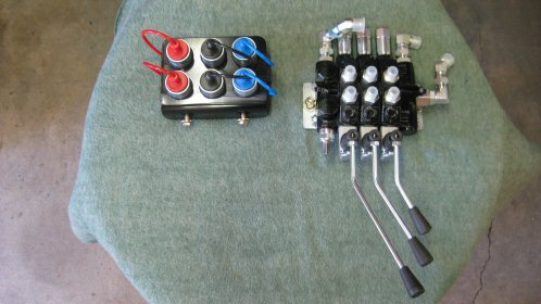

Need a 3 spool valve for my mahindra 2555. 2 of the spools will be used for a T&T and the 3rd will be a second remote hook up. I would like to have 1 of the spools be able to float to use on my tilt cylinder. I looked around for a while and just wound up really confused so I thought I would ask for some advice and see what you guys would recommend for this setup.
Thanks
/ Hydraulic valve: Which one? #2
I recommend you get these. Very good valves and you can get what you need. I highly recommend that you get both of your T&T valves with the float feature. Then the 3rd just a spring return to center valve for most implement cylinders.
If you want, I can set you up with the valves and couplers.

The joystick control adds quite a bit to a set of stacking valves, actually to any valve. Plus it can complicate with how the valve gets mounted.
On the pictured valve, the inlet is on the left with a 90 & a 45 pointed to the right. The return to tank port has a 90 pointed to the right and the power beyond is at the center on the right side with the 90 & 45 on it.
/ Hydraulic valve: Which one? #5
This begs a question. I had in the past when inserting a valve in the power beyond circuit, I always ran a separate hose to a T in the existing tank hose. So the hoses on the inserted valve were:
In from last power beyond
Out on PBY to In on next valve
To Tank
(2) Cylinders Work Ports
Then I was looking at my backhoe and there are only two hoses. One from FEL power beyond and one returning to the tractor. No third hose.
When do I need a 3rd (Tank) hose? Does the last valve not need one because everything goes to tank at that point?

Correct, the last valve dumps all fluid back to the tank.

If you insert a valve and do not pipe a tank line, just in and power beyond, what happens? Does it not work? Seems the fluid when the new valve is not in use would still go to the power beyond and the next valve would have all the pressure. Just checking to see if I can save a few fittings on the tank line.
/ Hydraulic valve: Which one? #13
It will work until you operate the new valve to move a cylinder etc, then the oil that's supposed to go to the tank has nowhere to go, and the cylinder won't move.

How come the last valve can do it without a tank line? :confused3: or is the last valve not considered power beyond or not piped power beyond?
/ Hydraulic valve: Which one? #15
The last valve in a series does not need a power beyond port because it is the last one, hence not needing to feed power beyond that point. So all it needs is a line In (feed) and line out (return to tank)

Note that on the Mahindra 25 series (and other Mahindra/TYM/Mitusbishi tractors) the backhoe has only one in, and one out; the out, which is a Power Beyond, goes to the 3-point lift. So it doesn't need a drain, even though it's not last in line! The backhoe is frame mounted, so the 3-point will never be used when it's attached. The two hoses on the tractor are simply attached together when the backhoe is removed.
That being said, as I have a similar tractor, I replaced the FEL valve with a new unit having a joystick (with the proper float) and a third valve for a grapple or tree grabber. I'm attaching the old FEL joystick to the back of the tractor to operate Top'n'Tilt or other gadgets.

On a valve which has both power beyond and tank ports, the oil returning to a work port is directed to the TANK port, not the PB port. When the valve is centered, the oil from the IN port goes to the PB port instead of the TANK port, so the next valve can use it. It's actually quite simple, no need to take a valve apart.

It will certainly work: that oil going through the valve is essentially going through a straight pipe if a valve isn't actuated! The only difference is that it's dumping waste into the PB line, which would fail to work if,
and only if
, the 3-pt lift was engaged when trying to use the backhoe. No need for that, it's a subframe-mounted BH, so no worries.
Theoretically, if you would only operate one valve at a time, you can stack PB valves with no drains. It's a really bad idea, because you could "backwash" some pressure and cause unintended and potentially dangerous consequences, so it's rarely done, beyond the instance I've described.
