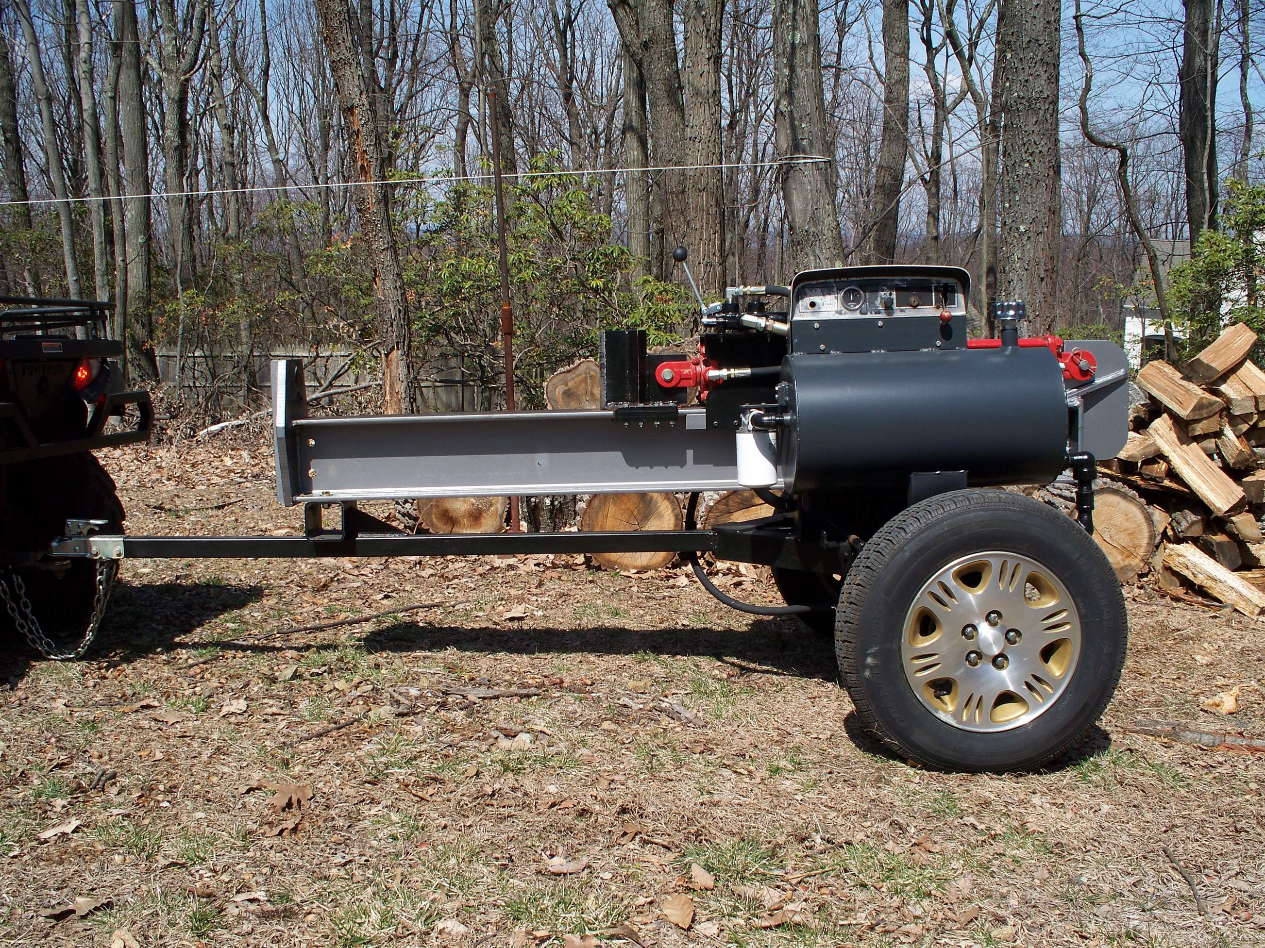

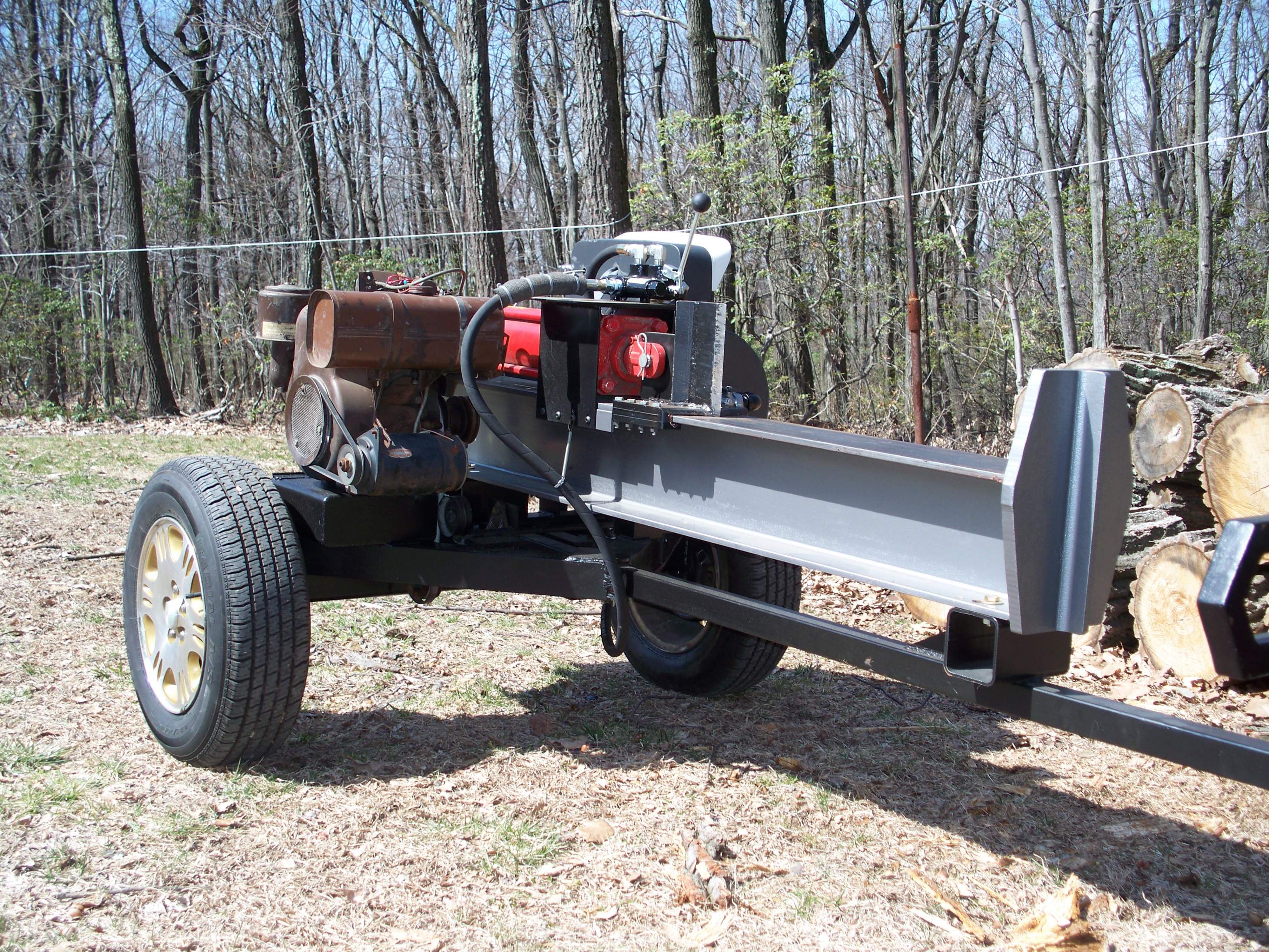

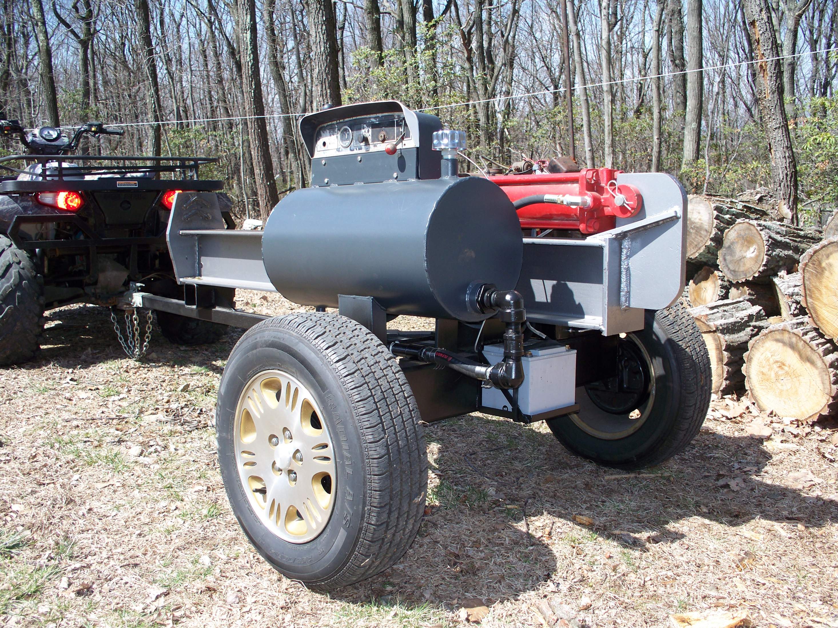

Well I finally finished my splitter build.

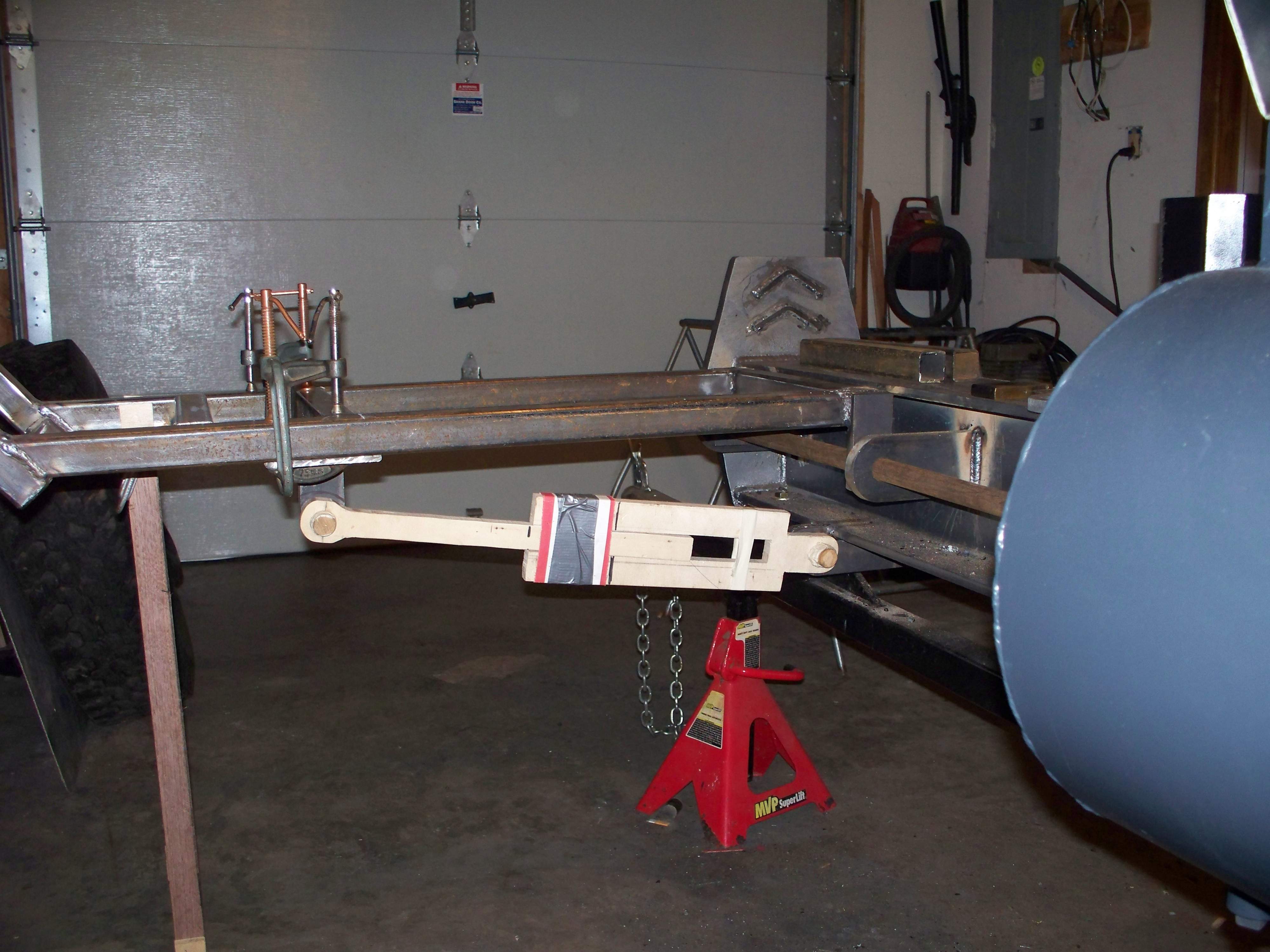

The wood hyd. cyl was to work out the pivot points prior to buying a cyl.
I now have a 2 X 8 in place of the plywood cyl. mockup, with a flow regulator on the cyl.
Long story short......10hp Wisconson engine w/ elec start, 16 gpm pump @ 3000psi, 5'' X 30'' ram cyl., Prince detent valve from Northern Tool.
I also added a log lift sooner than I thought I would and I'm not sure about just buying another matching valve to hook up in series to run the lift, or if I should buy a 2 spool.
I kind of like the detent option for the lift so it can return to ground on it's own.
All the research I've done just leaves me more confused....Power Beyond, 2 spool valve, 2 valves in series, open center.
Could somebody or everybody help me out with this plumbing dilema.
Pics or schems would be greatly appreciated as I'm not up on all the hyd. terminology.
Thanks,

Here is the valve I would recommend. It is the auto cycle two spool valve with PB. The output of the PB would connect to the input of another valve for the log lift.
https://www.surpluscenter.com/item.asp?item=9-6587-PB&catname=hydraulic
While the first log is splitting, you can be loading the lift for the next log, or re-split the same log into smaller pieces.

Can the valve you suggested work without the autocycle as though it was just a regular valve?
/ Hydraulic Valve Help for Newbie #6
What so you mean like a regular valve. It is what it is. The two levers work together to make the valve an auto-cycle valve after setting the levers. If you should push the lever fwd and not detent, then the cyl will extend until you let it go.
What makes this valve so good is the fact that it is PB, which will let you add another two lever valve downstream. One lever for the log lift, and the other lever for raising and setting the wedge. I don't know if anyone makes a single lever log splitter valve with PB.
Can you describe the whole process you would like to go through when splitting a log. Maybe we can recommend something.

The beam is 31" off the ground....perfect height for me not to have to hunch over or straddle an axle while splitting. The addition of the lift eliminates having to lift the biggens up. The lift arm also doubles as a staging area for wood being split.

To slow down the lift, you can add a restrictor in one of the fittings, or work out the geometry for a slower lift.
The speed of a cyl is based on GPM, and volume, so you either restrict the flow, use a large cyl, reduce the GPM's, or set up the geometry for slower operation.
You should be able to use a $69. log splitter valve to raise the log and hit reverse detent for auto down. You probably will not be able to use the log lift while the log splitter is in operation, as the fluid is being used for the splitting, but when the log splitter is in neutral, then you can lift and drop the log lift.
Do you have the log lift setup so that it can be stored in a travel position, or just unhook one of the cyl ends.

I have the geometry worked out to allow the lift to raise to almost a verticle position for transport. Took a bit to perfect but it should work fine.
