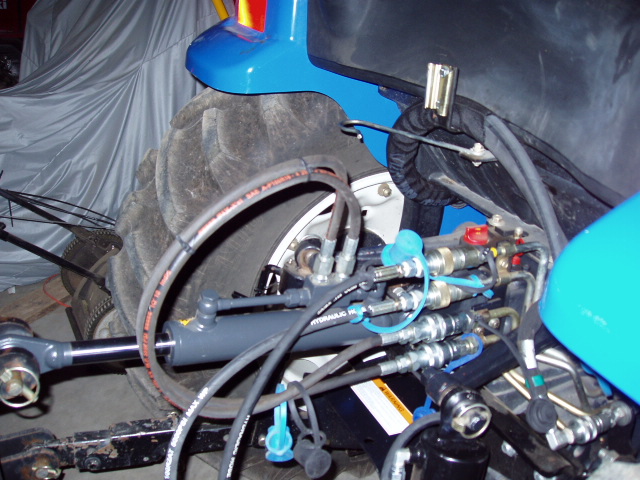

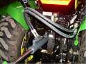

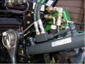

Can you walk me through the steps to reverse the placement of the two cylinder hose fittings on the DPOCV so the longer pipe is at the front of the cylinder at the tractor pinning and the shorter pipe is back toward the attachment? Reason: To avoid any interference of hoses or pipes with the rest of the tractor gear when the 3-pt arms are raised to full height. I bought the cylinder from your company a few months ago-works fine but the hose leads and cylinder fittings are vunerable.
I saw this proceedure done on another thread but would like you to tell me how to go about it.
My tractor is blue. The green tractor (sorry about the photo size and quality) photos shows a bent pipe and the reversal of the DPOCV.
