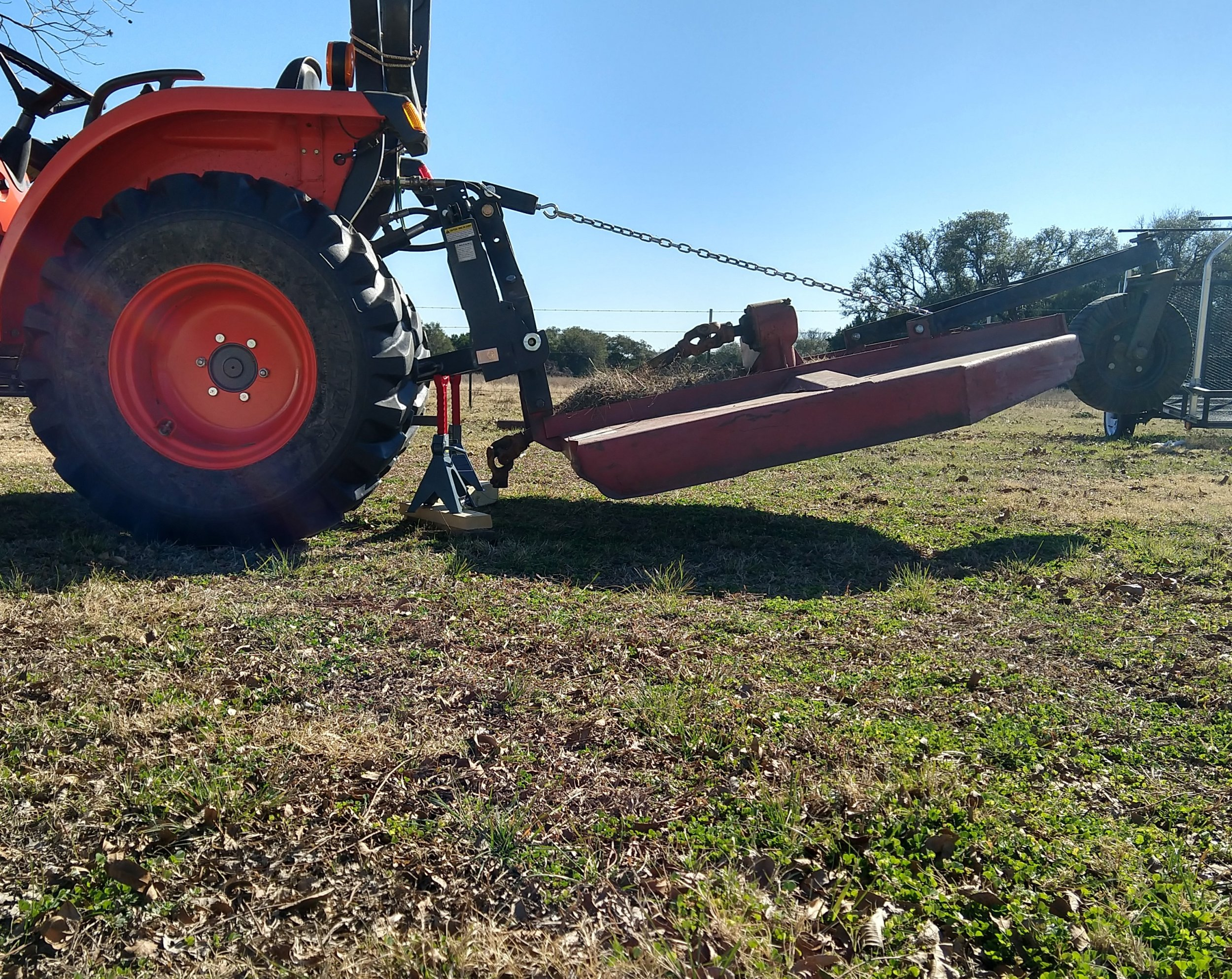

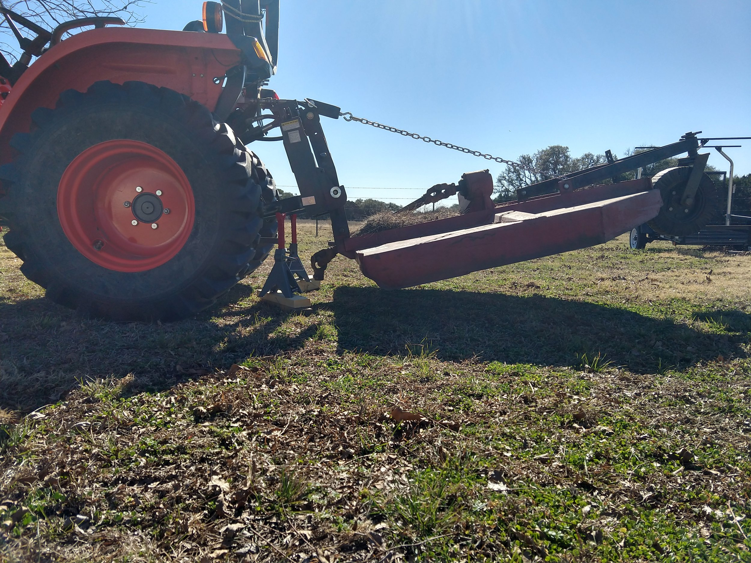

On my top link on my tiny 4wd tractor, being able to shorten the top link substantially has made me able to go places with my box blade i wouldn't have been able to go otherwise because pulling the back of the box up increases my 'departure angle' (that's what off-roaders call it anyway) and stops me jamming the back of the box in the ground if i am driving in some 'interesting' terrain.
This pic shows the max i can pick the back of the box blade up to. Maybe a 6" difference but if you draw a line from the bottom of the rear tire to the end of the box blade it changes that angle significantly. I was recently driving around in my creekbed getting ready to build a retaining wall and it made a big difference there. And yes, i was using the box blade once i got there. I have a slightly larger Kubota b8200 with a backhoe and i stopped trying to use it in the creekbed because i was jamming the bottom of the backhoe into the ground a bit too much.
