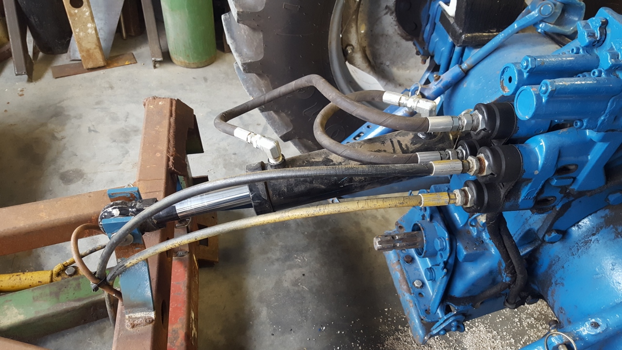

How are you getting on with your cylinder problem? I seem to be popping up all over, don't want to be Mr Know it all, have been pondering this issue you and the OP are having. I'm interested to know if your problem is related to your tractor or your cylinder, if you have had a moment to swap it onto the Ford and give it a whirl? Have a couple of things in mind if it's a cylinder with air causing it.

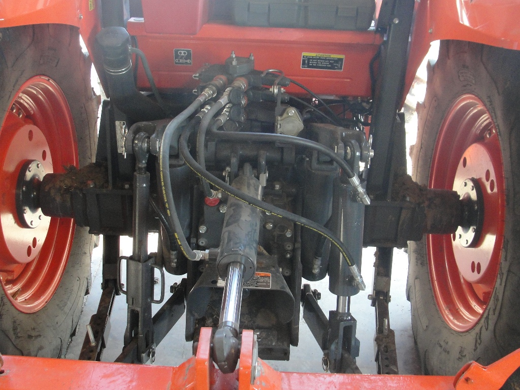

1 vs 2 flow controls will depend on what you want to accomplish. If you want to prevent the toplink from extending too fast and causing it to bounce like the issues in this thread, then you can get by with just one if you want. A single flow control to meter the rod side fluid as it leaves the toplink.
I put two on mine. Because spool valves and cylinders WILL bleed a little bit. Mowing for 10 hours with a 1600# cutter on the back would require having to adjust the sidelink a few times due to bleeding off. Just a tiny bit of cylinder bleed off at the sidelink is magnified quite a bit at the end of a 8' cutter. SO with flow controls, I can shut them BOTH off and it acts just like the cylinders that have the double pilot check valves, meaning it wont bleed off. But I have the option to open them up and use float, in which a cylinder with DPCV's cannot use float.

I haven't tried the Kubota cylinder on the Ford. But I did try the Ford cylinder on the Kubota. Had the same "air" problem. I installed a restrictor on both cylinders and tried them again on the Kubota. Problem seemed to be solved. Weather hasn't allowed me to try them for more than a couple strokes.
