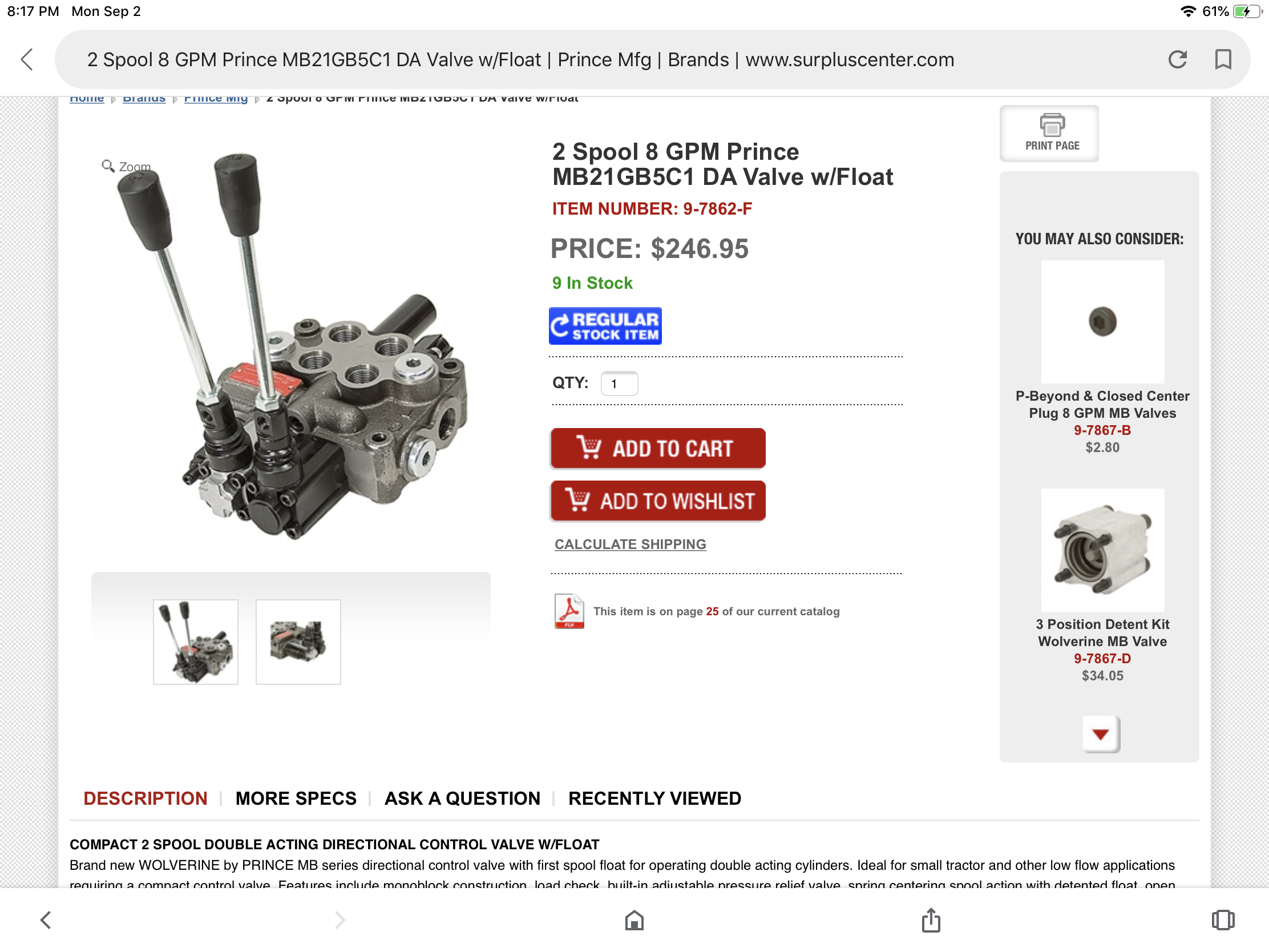

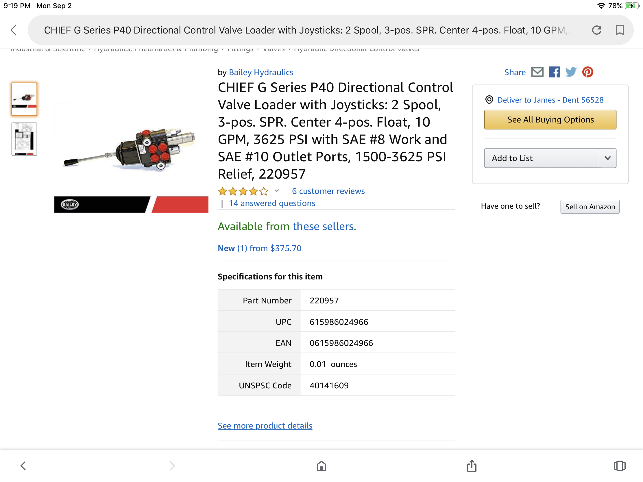

I also found this dual rear remote valve where side A has float and B does not, A would be top link of course and B side link, I know nothing when it comes to hydraulics which could be dangerous but I know better then to just hap hazardously do it without asking questions.
This would work too I believe maybe better do to space.
I understand that one line is a inlet from pump and one a outlet to the reservoir and side A would be the top line B would be side link but knowing what fittings and line to get and plumbing would be the main issue, links would not be hard but also not cheap.
I am in no hurry to do this so I will keep asking and looking till I get the right set up and also figure out where to mount the valve it self which could be interesting.
