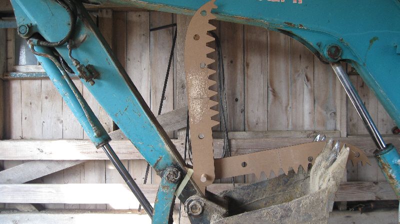

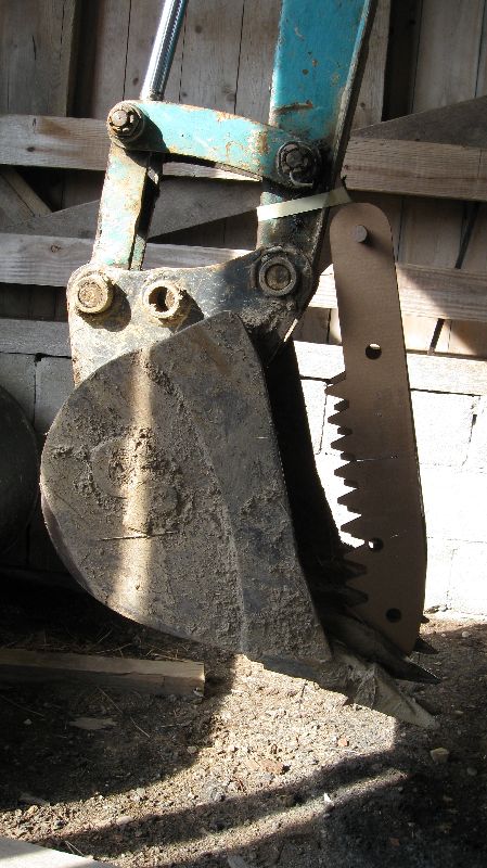

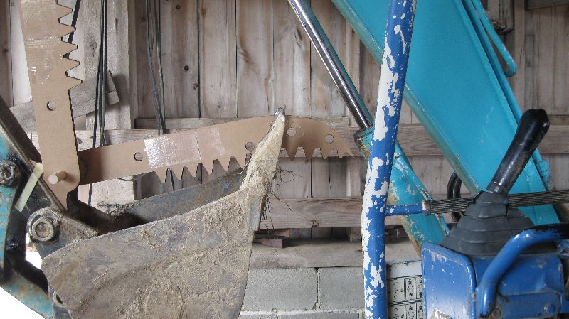

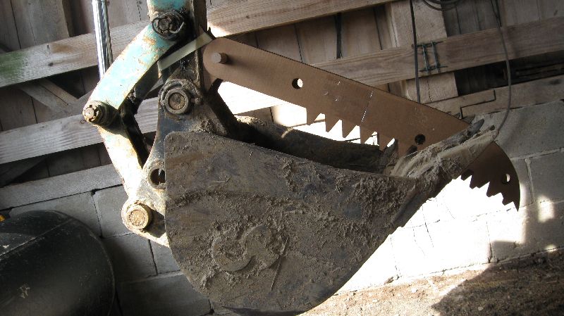

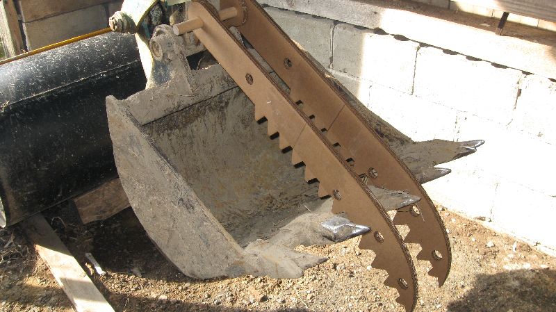

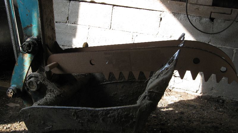

Thank you very much for the photos and measurements Topstrap.
Looks like your thumb is about the same size as my original, but your excavator is about half again larger than mine (8,000lb vs your 12,000), so I think I probably overshot a bit.
Think I'll try another cardboard alligator, but maybe something like 28" long thumb, see how that works out.
Do you think it would be a real problem if the thumb was a bit shorter than the bucket at full extension? Doesn't seem like a big problem to me, would make the overlap less when curled, and would still give a couple inches clearance to the boom when the dipper is pulled in tight.
/ Hydraulic thumb #22
I really don't think the length is super important since you very seldom use it to grab things that are so small that you'll worry about not reaching your teeth with the end of the thumb. I kinda compromised between open and rolled up. I wanted mine to swing way down since I work around houses and close quarters a lot and didn't want to have to extend the boom way out to be able to get the thumb down far enough to pinch things between it and the bucket. This way I can still have the bucket in close to me and swing the thumb down far enough to still pinch concrete/timbers/brush or whatever. A thumb that don't swing down far enough needs to have the stick out to get the right angle to allow the bucket to pinch items to the thumb.
I'm sure mine could be improved on with someone with some good math skills but I just played around till it looked about right and welded it up.
Good luck on yours, if you are like me though we do tend to sometimes overdo things but I didn't want to have to worry about it bending or being torn up from use.
