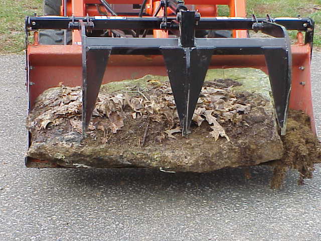

</font><font color="blue" class="small">( ..........................What Next????? HMMMM. Can you say grapple? )</font>
Here is the American Solutions LLC (web page) one that I worked on with the inventor...... TBN web page

American Solutions ... xlnt looking product ... too expensive for what a BX can lift ... great price for a rig that can tote 2000#+ in the bucket.

Here is the American Solutions LLC (web page) one that I worked on with the inventor...... TBN web page )</font>I saw that one before, I really like that design. Of all the ones I looked at I liked that one the best. Do you know how much it weighs in at?
The reason I asked is I called another grapple manufacturer awhile back and they said they build one for the BX but really detered me from thinking it was going to be of much use (which I appreciated) as the weight of the one they built was around 130lbs which would handicap the bucket to much to be of much use. The design of the one you show looks much lighter.
I guess it is going to depend on what the intended use is. If it is just to stabilize the load I don't think it needs to be to heavy duty. If it is going to be used to grab and pick heavy loads thats another story.
If the weight was right on it I may be interested in one. I see they are a pre-order item also. Any idea on how to get one?

</font><font color="blue" class="small">( ... too expensive for what a BX can lift ... great price for a rig that can tote 2000#+ in the bucket. )</font>This is the sentiments I heard from another grapple manufacturer. They build and sell them but are very adiment that you not expect much use of it for the BX because of it's limited load capacity. Who knows though, if you just need something to move some brush and you do a lot of it, it may be worth it.
